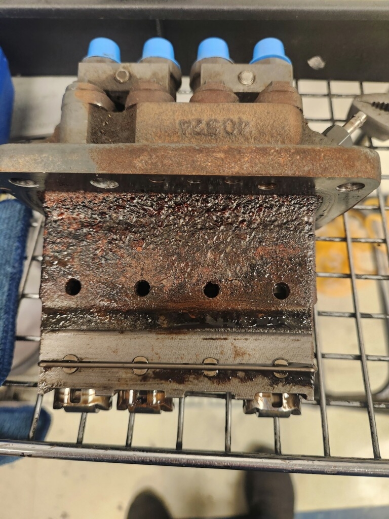

I have a Kubota M6040 with 2502 hours on it that has a new low power issue, it has very low power at idle and sounds like it has a engine miss. If I run the throttle up it seems to get better but still is lacking power. The issue is so bad that at an idle if I run the loader cylinders to their limit it will stall the engine. I have tried replacing both the strainer screen and the main fuel filter and blowing compressed air back to the fuel tank with no change in the problem. It was running fine one day and then the next time I tried to use it I had the low power issue. The fuel in the tank is the same fuel that it has been running fine on in the past. Any help would be appreciated.
/ New to me M6040 #3
Could be a lot of things but a very simple thing to try is to loosen the fuel tank cap a little and see if anything changes.
/ New to me M6040
I loosened the fuel cap and it did not resolve the problem. I also verified that the mechanical fuel pump is pumping fuel to the main fuel filter

Finally got the tractor back from the dealer shop and they found that the injection pump was full of rust, has anyone else ever seen anything like this?
