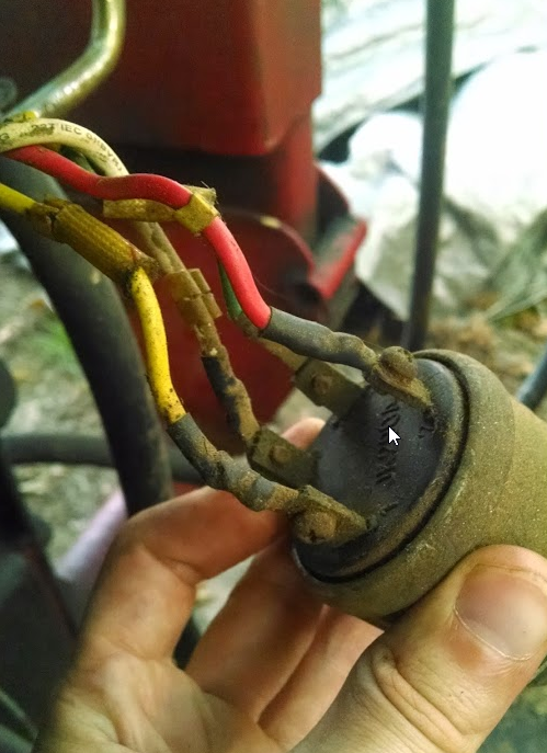

Finally got some time to work on this between traveling for work.
Replaced the key, regulator, pull to stop switch, inspected the fuses, and did some general cleaning and sorting
I think i ordered a few wrong parts from Tommy unfortunately. The pull to stop cable is too short. And i got the wrong fusebox from jmparts (50% off sale there! sorry tommy)
And something seems wrong here in my reassembly. Its dark and my brain hurts
old keyswitch to new
Mismatched fuse box... boo. 6 slots in the old one rather than 5 in the new. Looks like the old is a BX202 vs the new BX505. Thats my own fault.

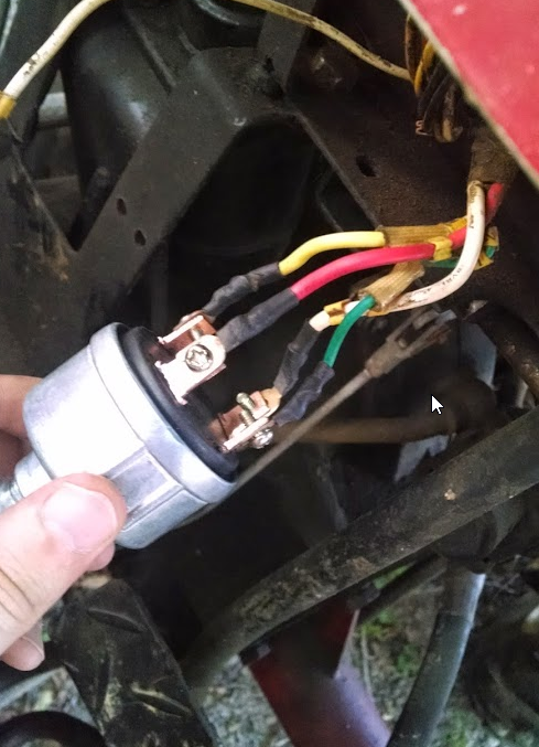

And swapped out the regulator

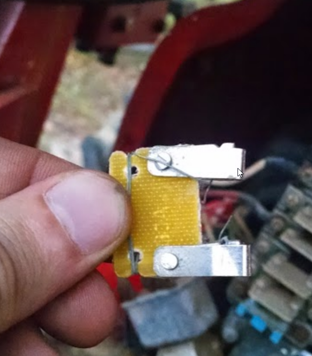

All in all, ive got 2 clearly blown fuses, a 6A, and a 13A
6A
and the 13a
Gotta find someplace to get replacement fuses, havent seen this type before, and see if she'll fire up. If not, its time to dig into the tangle of wires and start ohming things out to see if ive got cut wires

The wire wrapped at the top of the fuse is your spare replacement fuse, take the 2- prongs that go into the slot, turn then 90 degrees, re wrap the wire from the top down low . I heard 1- wire wrap was 10 amp, 2- wraps 20 amp, 3-wraps 30 amp. You can also replace that wire it piano wire ( they sell it in small rolls). Send back the pull to stop cable and we have a longer one also that used on the 354 tractors. Call the shop with the measurement. Don't try to send back the fuse box to JM parts they don't take returns. Sometimes a deal is not a deal !!!!!

As a solution for now per Tommy, i rewound the 13A (might be a 30amp.... that would make more sense fuse at the very top), and tried to do the blue 6A at the bottom. The top one rewound just fine, but the bottom is all corroded and frozen.
That said, I now have a working ignition and partial dash. My RPMs meter and hour meter still dont work, but i now can start it up with the key, have oil pressure monitoring, temp monitoring, and fuel monitoring. Everything is nicely in spec, which is good to see.
