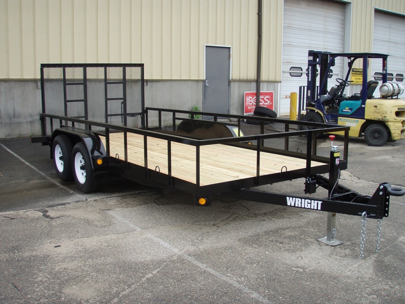

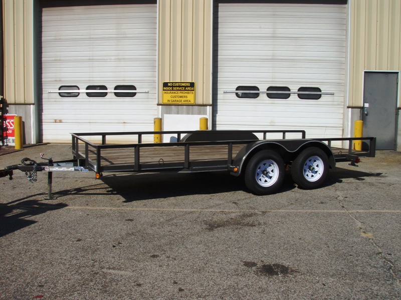

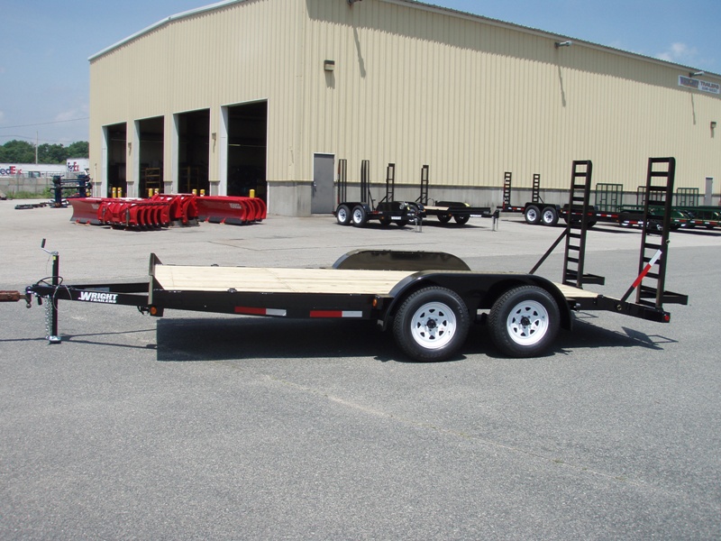

Thanks for the replies and advice. The boss won稚 take to my buying a new truck to haul the new tractor, so I値l have to roll lightly for now. The local trailer shop/mfr has these:
Load Trail utility trailer, 77"x16', store under ramps, swing style jack, sealed modular wiring, pt wood deck Details Price:2250.00 CARRY CAPACITY: 5212 LBS GVWR: 7000 lbs
Equipment Hauler 82"x16', 60" stand up ramps, Dexter EZ lube axles, stake pockets & rub rail, headboard, 2k post jack, (4) 1/2" d-rings, sealed modular wiring harness, steel light boxes, LED lights, PT wood deck. Details Price:2695.00 CARRY CAPACITY: 4810 LBS GVWR: 7000 LBS
Tandem Axle Landscape trailer 82"x16', shock assisted X-treme duty ramp gate, 18" tube top rail, tie downs, Dexter axles with EZ lube hubs, 7K drop leg jack, steel light boxes, sealed modular wiring harness, adjustable channel ball or pintle ring, extended tongue, pt wood deck, prime & paint. Details SKU:WT-10-32087 Price:2795.00 Carrying Capacity: 4860 LBS Color: BLACK GVWR: 7000 LBS
Photos below are in order. What do you think?

I prefer the middle one because of the width 82" and the ramps allow something to hang out the back if need be. I do this with my 16' trailer with certain implements on. The third choice would not allow this. The first one is narrower and not built as heavy. So then #2 if it were my choice, IMHO.:)
