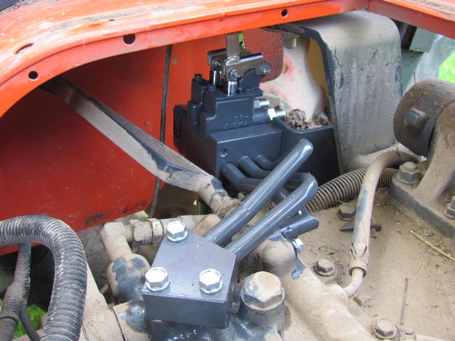

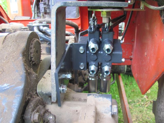

Install went well, no leaks afterwards, so successful. :laughing: Just had to remove the seat, which was easy. Did not have to take off tire.
Here's the valves installed under the seat.

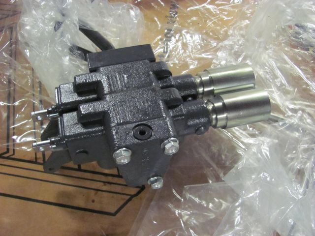

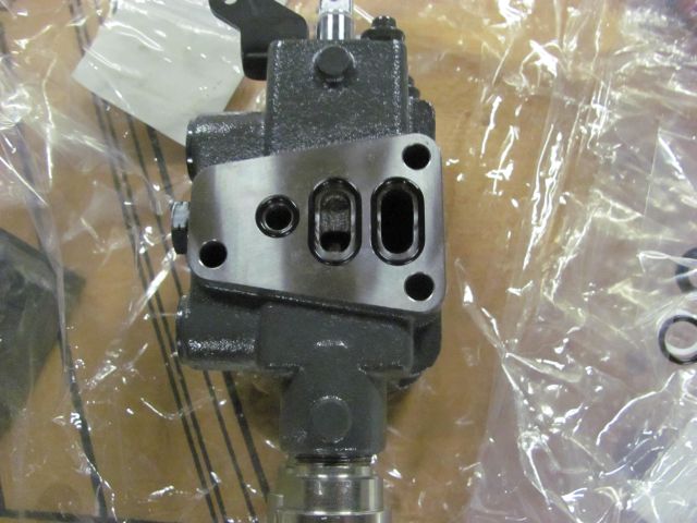

One of the valves with the o rings installed in the slot.
The valves all bolted together.

Back view before hoses attached.
