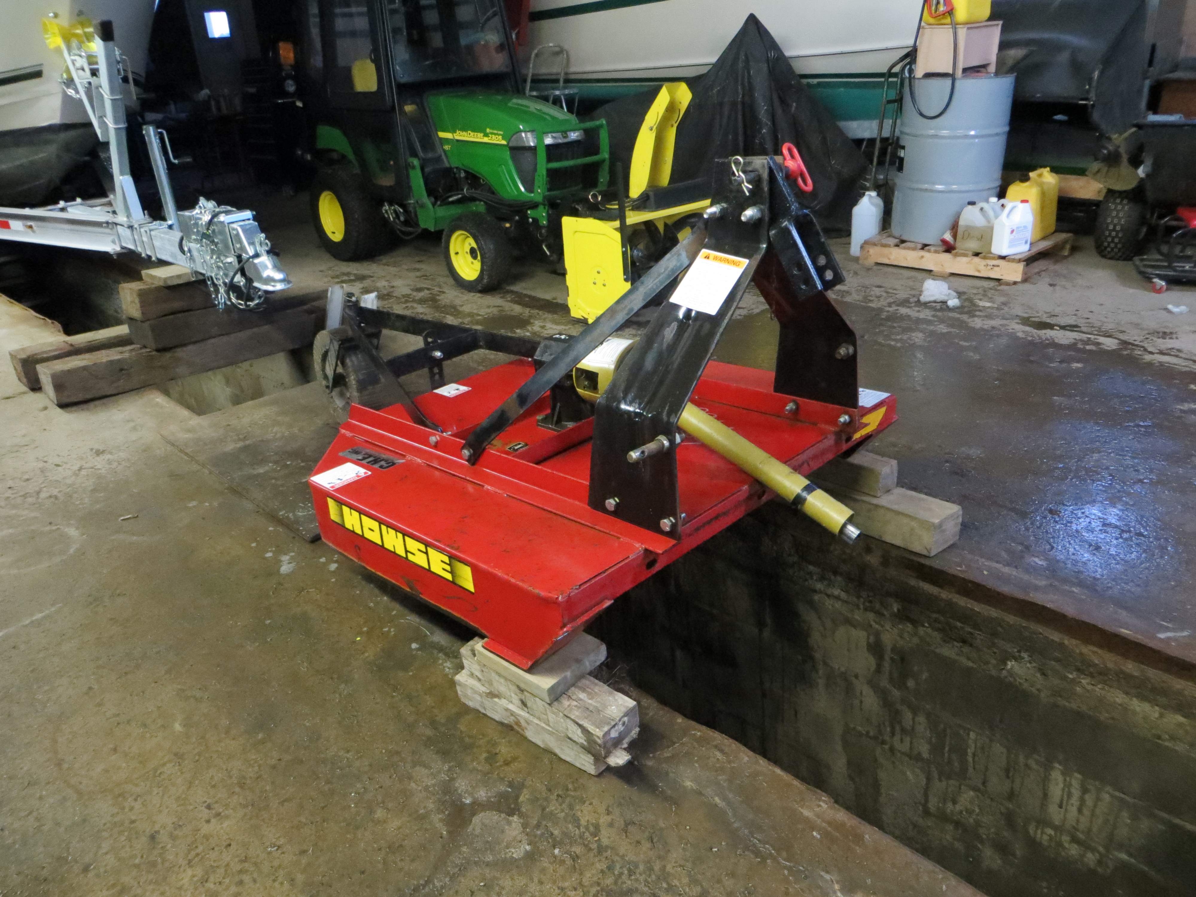

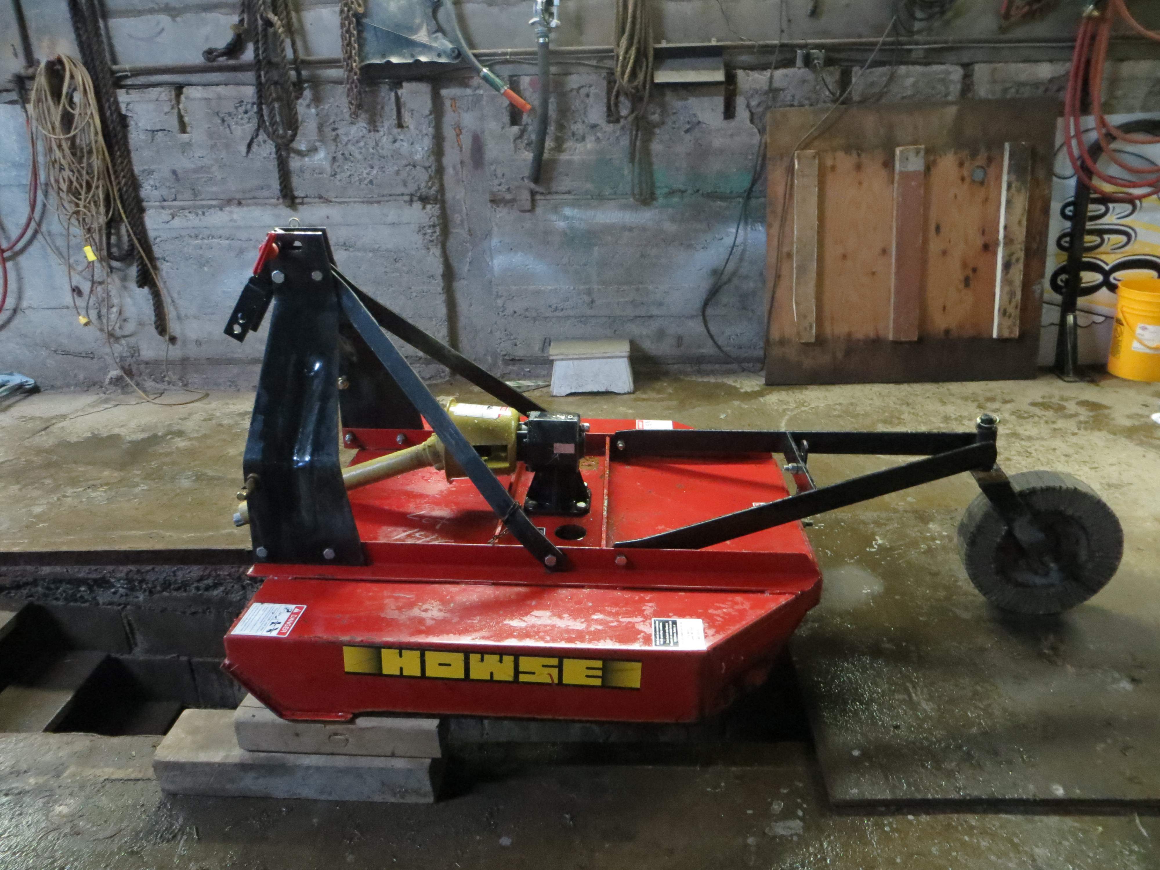

Good info as I was questioning myself on making one or not. Looking around on the internet, I've seen a lot of use BH for sale without guard, so I was not to sure if I should make one. Well after reading all these post, I am now convince. Bought mine this winter and I'm new to bush cutting, so here is my question. I'm trying to figure out the length of the chains. When the cutter is laying flat on the ground, should the chain touch the ground also or should they be somewhat shorter? Hard to see on pictures that I look at. I know they can't be to long so not to hit the blade. Any info would be greatly appreciated. Henri
View attachment 307936 View attachment 307937
Here is a recent thread and I know there is another one also, just can't remember it now. http://www.tractorbynet.com/forums/build-yourself/273335-brush-cutter-chain-guard-homemade.html
I believe Chilly807 built a set also, but couldn't find the thread with details, only this: http://www.tractorbynet.com/forums/attachments/203349-land-pride-rotary-cutter-chain.html

Thanks TripleR! Got all the info I needed and more. :thumbsup: Henri
