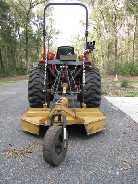

I pull a 48" King Kutter rotary cutter behind a Kubota B3300SU, which has 58" rear tire width.
I do not have deflectors on the small-ish, relatively low-velocity blade speed, King Kutter.
I do wear saftety glasses, hearing protection, a hard hat and steel toed shoes from Walmart/$30 at all times when 'hogging.
Well....... sometimes the hard hat changes into a wide-brim straw hat during Florida summer.
I choose my 'hogging time to be when people are unlikely to be around. Dogs do not like the noise and scram.
I mow a lot in the woods. Looking back over your shoulder is when a branch or other tree/vine debris will smack you in the head/face.
