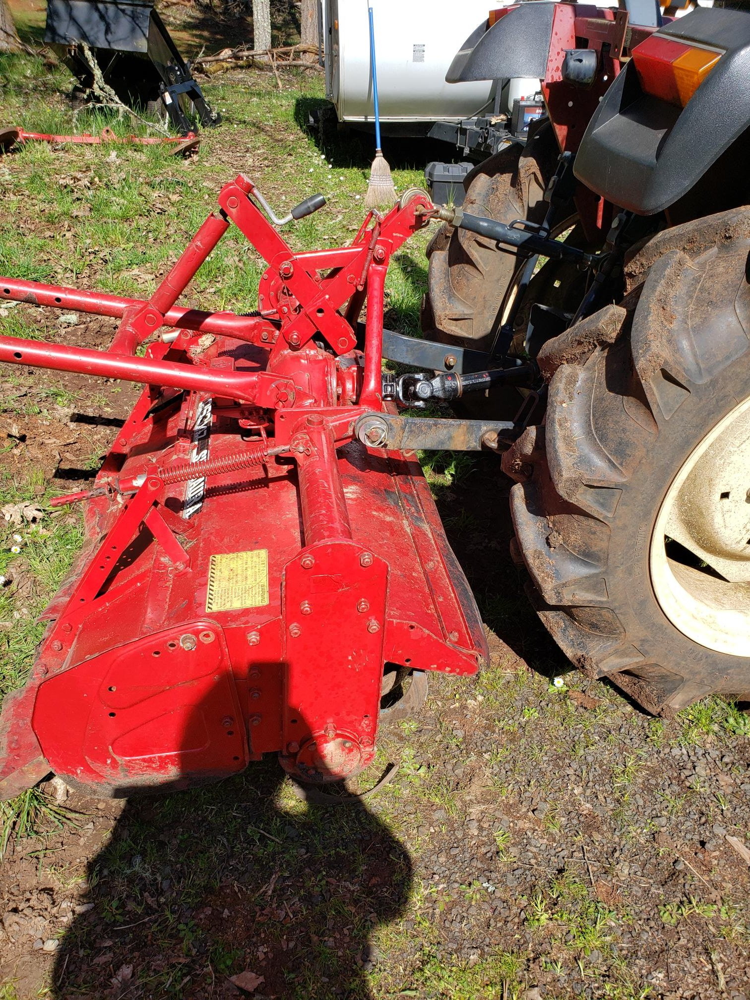

While I'm not a total novice, I'm no tractor expert at all. My 33 HP TYM HST has held up well over the years, and I have no trouble swapping my brush hog, box blade, or rake on and off my 3 pt hitch.
I bought a tiller (Shibaura RS 3147, also sold as Yanmar) for a song and a dance. I've ordered a new driveshaft and clutch. But lo and behold, the draw pins are set much closer together than I need. I have located "extra long" draw pins (6-1/2" long) but even those are not long enough for me to attach this to my quick hitch. It looks like I need more like 9"!! (Yes, I know what you're thinking...) Yes, I will add bushings to reduce rattle in the quick hitch, but I need to solve the length issue first.
I searched through the forums unable to find a post related to this problem. Does anybody have any suggestions or resources? Photos attached should convey what I'm grappling with.
Thanks in advance for any thoughts.

Looks like one of the tillers that came on many import used tractors, that was intended to stay on that tractor for its lifetime. Non-standard hitches. etc. Sometimes reverse rotation on PTO.
I've seen them at low prices because they don't fit any standard tractor without modifications.
Bruce
That is exactly what I was thinking when I saw the photos. This may not be a useable tiller without modification including a pto reverser.

I have that same tiller and you will find that the pins set back to far and when you lift it up all the way it might hit your tires or be very close, I built brackets that moved the pins out about 6 inches. Bought a new driveshaft with slip clutch, Tiller works great now.
That is what I was thinking. Weld on a piece of channel steel on each side. Drill the channel and put your pin there.

Quick follow-up-
So in the end, it looks like I did not buy a "pig in a poke." While the tiller sits close to the tractor, it is similar to what I've seen for Yanmar tillers on Yanmar tractors. For the moment I'm operational (as soon as the ground dries out a bit more). Also, the direction of rotation is correct.
Hooking it up only required the obvious- adjusting the "chain checks" and trimming the driveshaft an inch or so. So while my ignorance could have been very costly, it looks like it won't take too much to have my cake and eat it too.
My intention is to follow all the good advice here and adapt it to fit my quick hitch. That will move it 4-1/2" further back from the tractor as well as make it more convenient to mount and dismount.
My thanks to the community here for your valued insight and suggestions!

That will most likely require a new drive shaft now since yours is now cut to fit without the hitch
   / "New" Tiller Draw Pins Too Close Together #37
Post number 2 covers it nicely. You might want to remove that quick hitch so you can actually position the lower links on the pins that will need bushings anyway. diameter is too small.
agree with 5030 here....get rid of that quick hitch.
It may... but currently it is installed without a slip clutch (which is on its way here). Not sure of the exact length that will introduce but suspect it will be every bit of 4-1/2". I did buy another driveshaft in case I need it, but this little one came with the tiller (as did a new set of tines).
