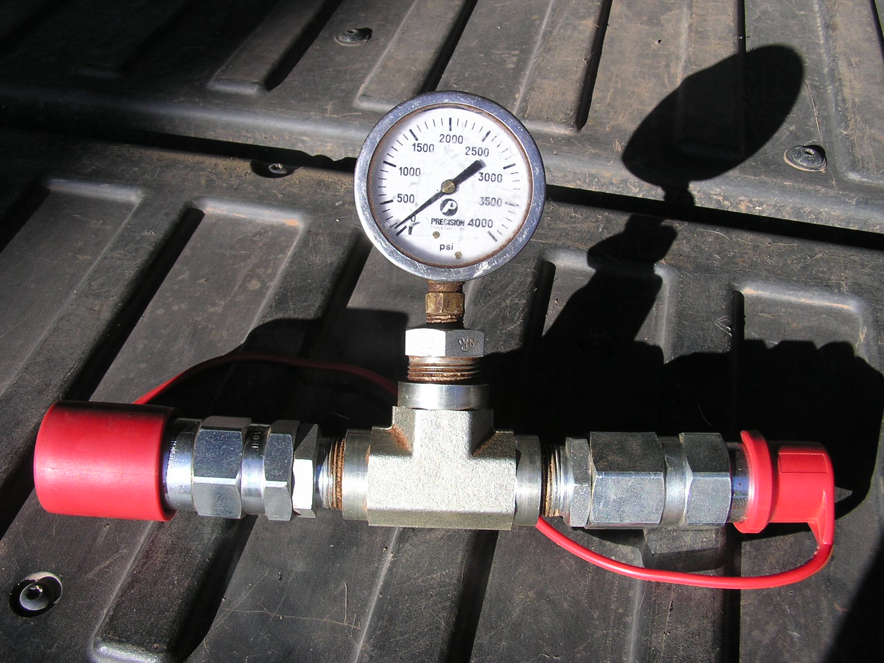

I have a pressure gauge on a tee with quick connects that I can put inline with the circuit that I want to check.

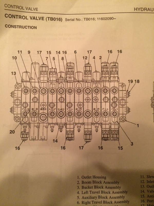

Looked in the service manual today here's the layout of the valve and the functions
And if you're not reading the pressure directly at the attachment here's where you can read them on the pump

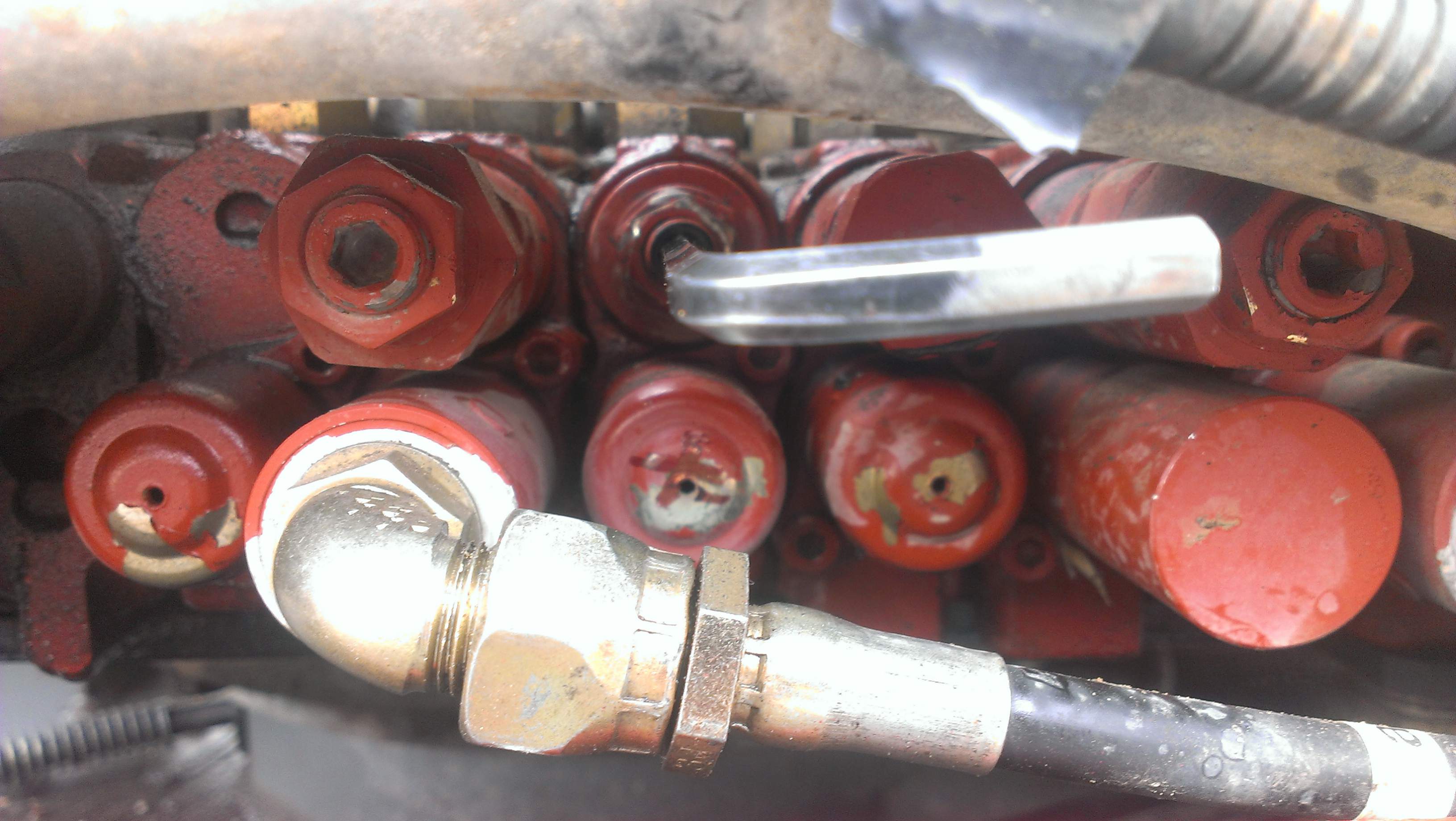

Hey Mike,would you happen to have the description of the valves on the first picture. I don't think that I have relief valves after all. The Allen screws that I'm adjusting does turn down pressure to the thumb but they don't hold pressure. I'm thinking about the cross over relief from Princess Auto that was suggested??? Thanks.

So the allen key is what I adjusted and it does turn pressure down but wont hold. I think the cap below it is the spot for a relief. To the left of where the allen key is what looks like a relief for another circuit and I would say this is what I need.

Here's the description of what each valve is in picture 1 the aux relief Is #5 it should have hoses a6 and b 6 going into it
To adjust it you loosen the jam nut and and tighten the Allen screw to raise the pressure and loosen the screw to lower the pressure than tighten the jam nut again
