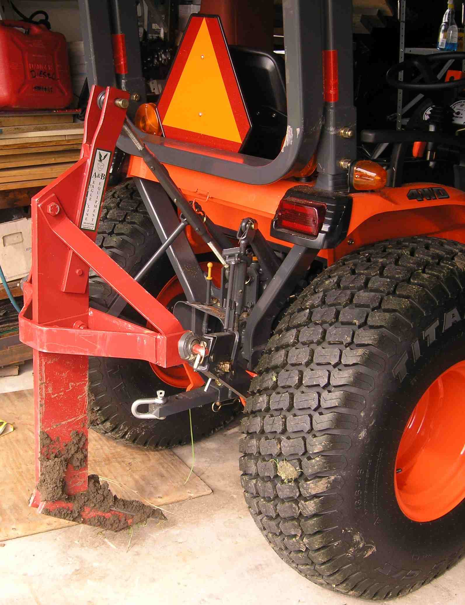

Just picked up a Subsoiler made by A&B Eagleline.
This thing is a real brute.
I did a test dig with my B3030, and it must have gone down 18" or so without any tweaking. (4WD, Turf tires)
Its a bit pricey: $270
I also got 15" middle buster point for it.. I'll report back someday after I do some work with it..

Nice! Post some pics of the soil you are working on!

What will you be using it for?

Looks nice and heavy. It looks like your lower links are almost raised as high as they will go. How much higher can you raise it off the ground?

I plan on using it for a number of projects.. Drainage issues, waterline for garden. etc..
I hope to try ditching with the middle buster point.
As far as the height, I think this is about it.. (~4" off ground)
I just hooked and quickly tried though..Havent gotten back to it
You can reposition the shank by re-drilling the holes for brackets, to raise it, which would give more clearance.
It is built really well - 138# worth of steel..
