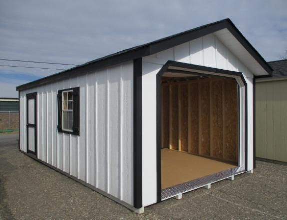

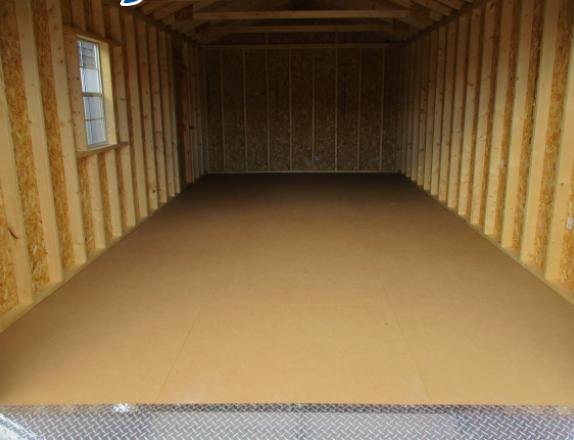

Hello all,
Given all this extra time I have on my hands while staying home I have finally searched and found a 12'x24' portable garage to store all my toys in. I contacted the company and purchased it. It has a 3/4" tongue and groove engineered floor in it. I would like to apply a floor coating on the garage as soon as it gets here before putting anything in it.
I will be keeping my JD 318 and its attachments in this garage. I keep my chains on the tractor year round so I am looking for a very durable long lasting coating. Most likely something oil based.
Any recommendations?

Chains on a wood floor? I don't think coatings are going to work out very well. Maybe truck bedliner coating?
/ New Shed Floor coatings? #3
agreed, even epoxy will not hold up to that abuse.
A urethane MAY
/ New Shed Floor coatings? #4
Heavy duty vinyl or rubber runners would likely serve you better than just a coating...
/ New Shed Floor coatings? #5
Put down something easily renewed. Water based latex paint. THEN heavy duty vinyl or rubber runners - like /pine recommends. Chains on a tractor are going to tear the H*LL out of that floor. Probably NOT something oil based either. Too slick with rain & snow.
/ New Shed Floor coatings? #6
You can get some rubber horse stall mats at TSC they have 4x6 3/4 or 4x3 1/2.........
/ New Shed Floor coatings? #7
Yeah, get rubber horse stall mats. Chains would massacre that floor.
/ New Shed Floor coatings? #8
Even place plywood would help.
