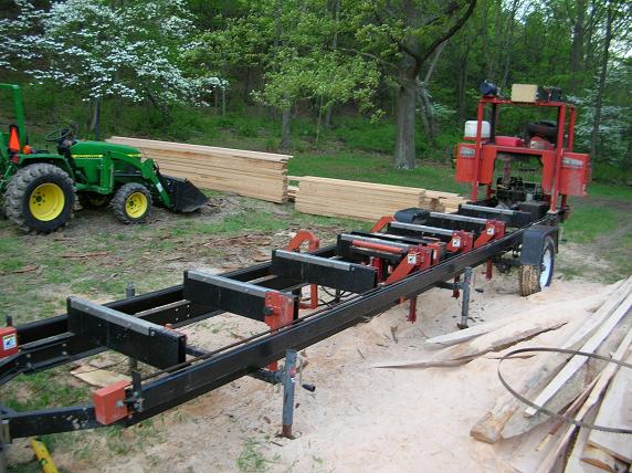

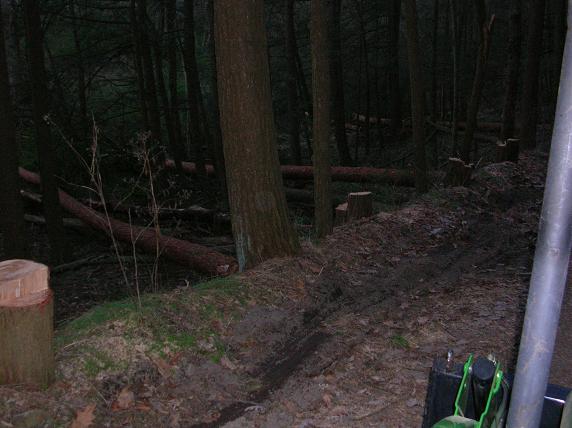

I have since got a Timber King Sawmill and have cut up a bunch of Hemlock trees for lumber to build an implement shed. The Hemlocks are dying because of the hemlock woolly adelgid, a pest that lives under the bark. It looks to me that I am going to loose all of the Hemlocks on the 92 acres that I have for hunting about 2 hours from my home. There are other people intrested in boards for barn siding and I wont let the trees go to waste. There is also alot of mature hardwood (mostly Red Oak) that I was going to have timbered but now I can cut them up myself and have a hobby that should last serveral years. The sawmill will be a handy thing to have around.

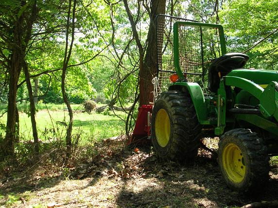

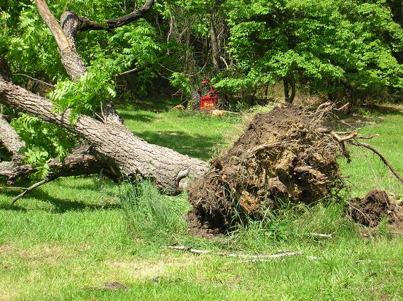

I also got a new model 40A Tajfun winch and am amazed at how much power it has. I needed to remove an old black walnut tree and I wanted to save the root ball to see if I could get some gun stock blanks out of it (the stump needed to come out to make room for the impliment shed anyway). I didnt really think that the winch would pull it down but I hooked the cable up high was suprised to see that it pulled the tree right out of the ground. It wasn't easy and it lifted the front end of the tractor a few times but it did the job.

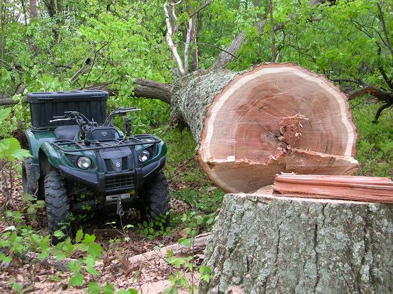

I am adding a few pictures of the Hemlocks, an oak that I cut and the Black Walnut that I winched out.

Is that a screen on the back of the tractor to catch flying objects?:D

Nice mill, it looks like it's in excellent condition. That's a great winch too - I've been wanting a Tajfun for some time now.

Do you have forks for your loader? They really work well for moving logs and lumber around.

I do wonder about the picture of the tree you dropped. The picture does not show any hinge on the butt of the log. Not sure if you did some trimming after dropping or if that is the way it was originally cut. If you are not leaving a hinge you will be an accident waiting to happen and I strongly suggest that you do some searching for proper felling techniques. The Forestry Forum would be a good place to get some good advice on all aspects of your woods work and projects.

Neat setup. The pivot point on the mechanical log stops may be a weak point. Some one I know with a model 1600, we had to redo all four of them. We also installed a remote throttle and replaced the crank scissors jack with a 12V DC one. I'm not sure why the log loader is so high off the ground either. Other than that, it seems to be a true workhorse.

good looking setup.......how do you like the tongue jacks for leveling? 3 or 4 on each side??

bitternut The tree does have a hinge but the picture doesn't show it well. It is just under the holding wood but in the picture it looks flat.
Flatheadyoungin it has 3 jacks on each side and leaveling is easy. Good luck with your Lumbermate, I'm sure you will like it. I did get a "Wright Machine" automatic sharpener and tooth setter with the mill but I want to sell it. I plan on getting the blades sharpened at the shop, just don't have enough time.
