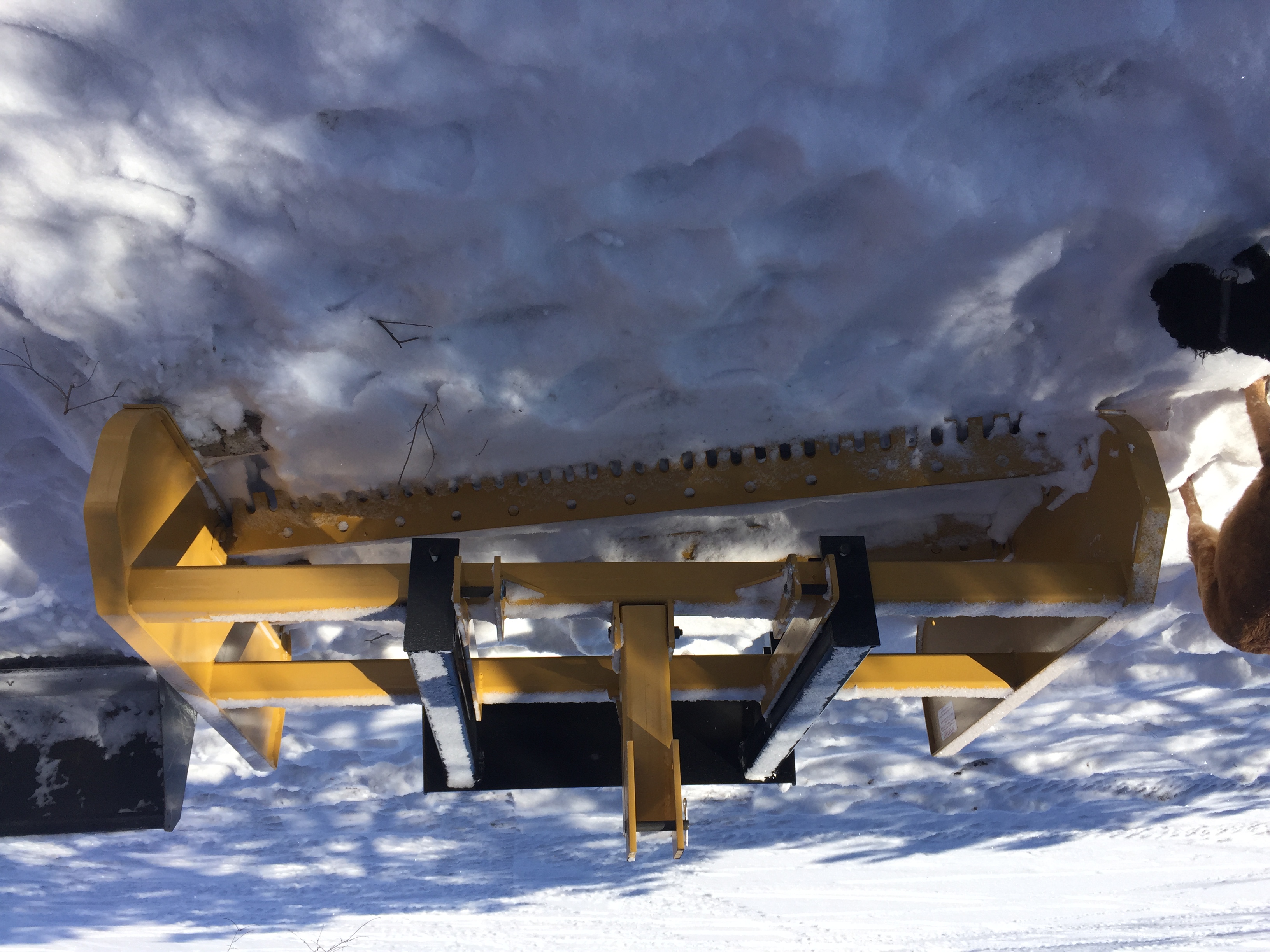

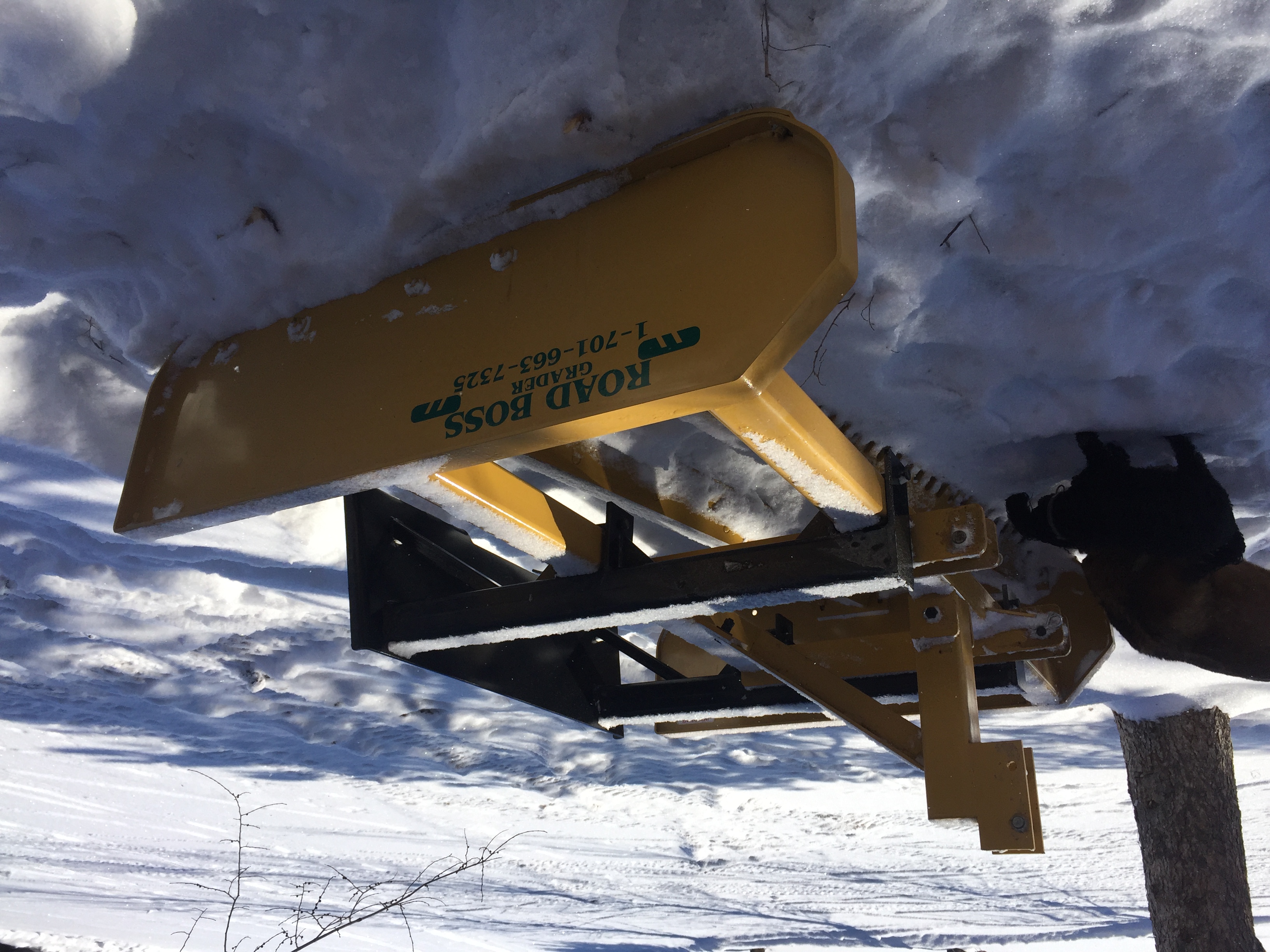

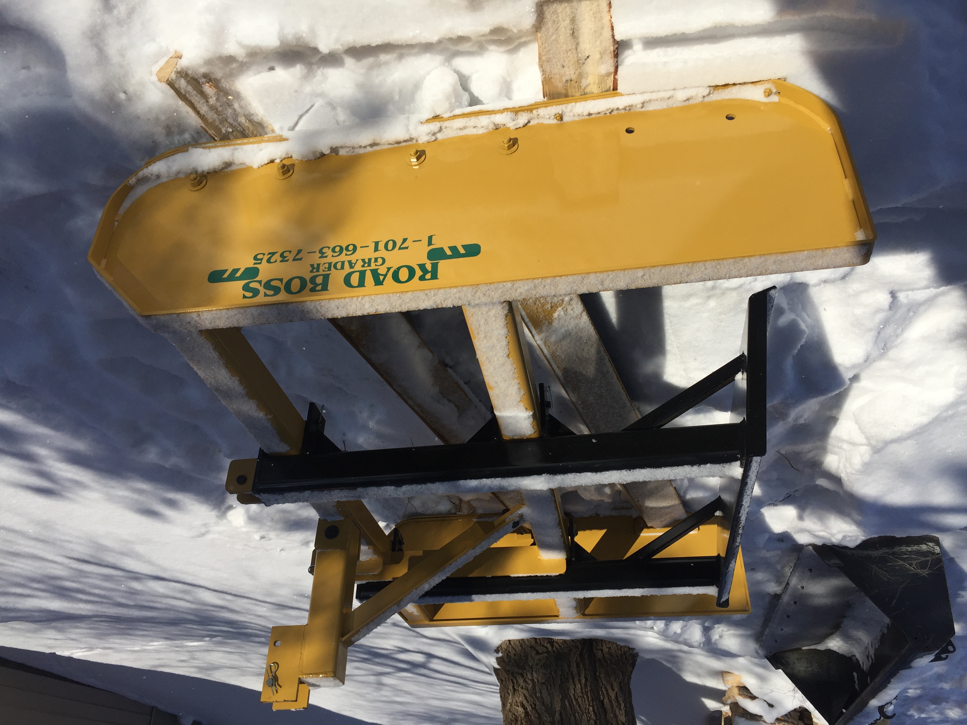

Just brought home my new 7' utility model Road boss grader. Now to wait until it thaws out here to give it a try. One of the USA based manufacturers for them is only 30 miles from my house. Ordered it directly through them and picked it up directly yesterday for a heck of a deal. I ordered it with the skid steer attachment for ease of moving it around with my tractor and if someone wants to use it who has a skid steer. $1850 for grader, $300 for skid steer attachment plus tax.

Ha Ha not sure why the thumb nail pics are upside down but they appear correct when opening them to view the larger size. My dogs even had to check out the new toy.

You spent a lot of time upside down taking the pictures, I hope you did not end up with a headache, one of the moderators will fix it for you if you ask them to.

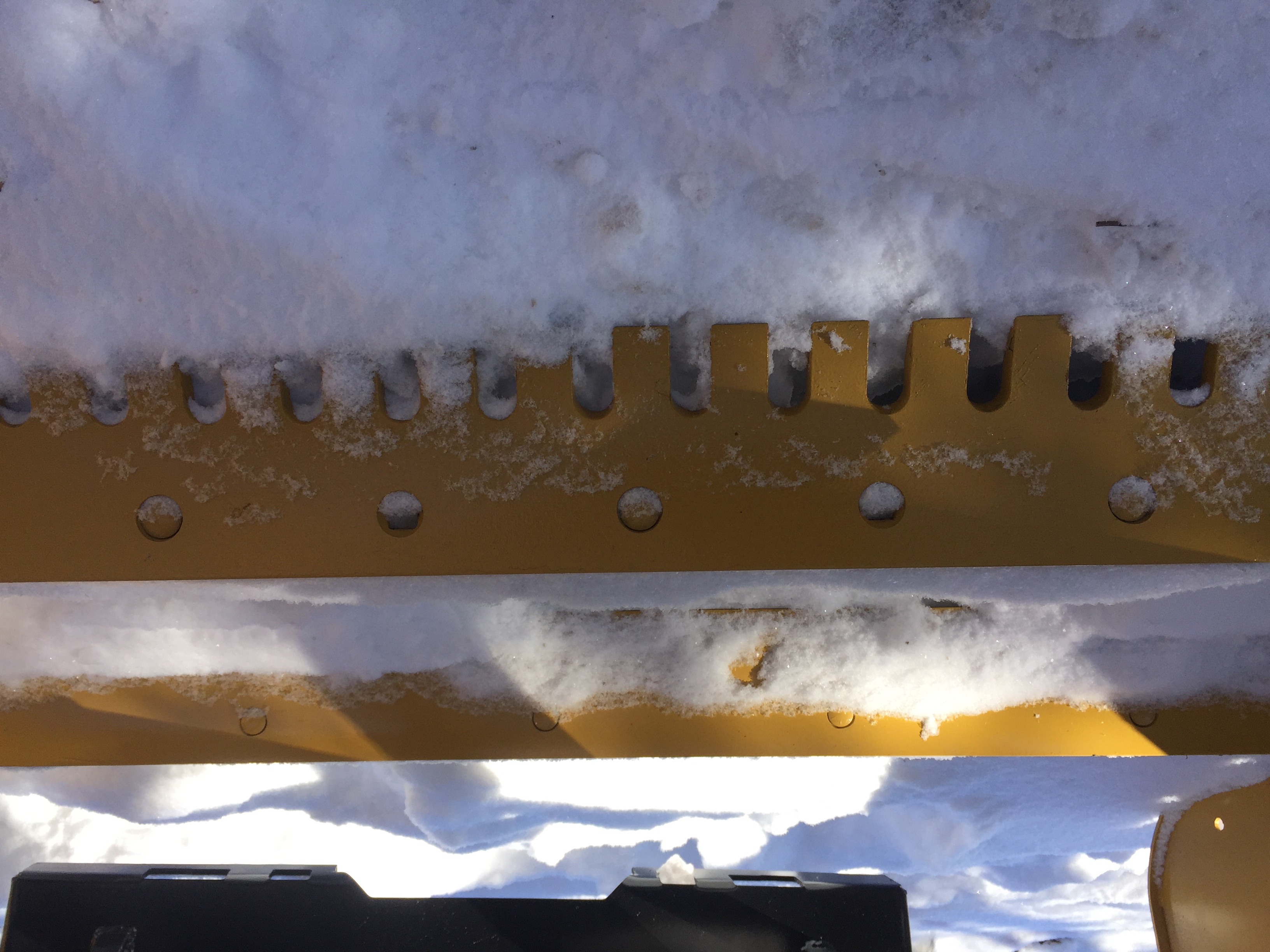

Congrats ! Those are nice units. I like the serrated cutting edge on those.

A fine looking unit. I bet you will find the serrated blade is going to be a big help. Exactly what is needed to scarify potholes as a first step in repair.

Just got to use it for the first time today. Did an excellent job on the gravel road in front of my house where it was mostly dry. It cut the wash boards out and filled and leveled the ruts beautifully. If the dirt / gravel was moist or wet it balled things up and made a bit of a mess I had to feather out a couple spots the best I could. Took me a few passes to get the hang of things. One definitely needs to raise or remove the front serrated edge if getting into any top soil or edge of road with grass ect. it pulls this material up and plugs the unit real quick. The directions said this would happen and they were right. I will let things dry a bit more and then remove the front serrated edge to pull the good gravel along the edge of the road that naturally ends up on the edge in the grass and to cut the sod down before summer to get a bit more crown built up. All in all I like it a lot. This 7 foot utility model seems to be a perfect match for my 49 hp tractor as well. Just the right size for the road and and driveway.
