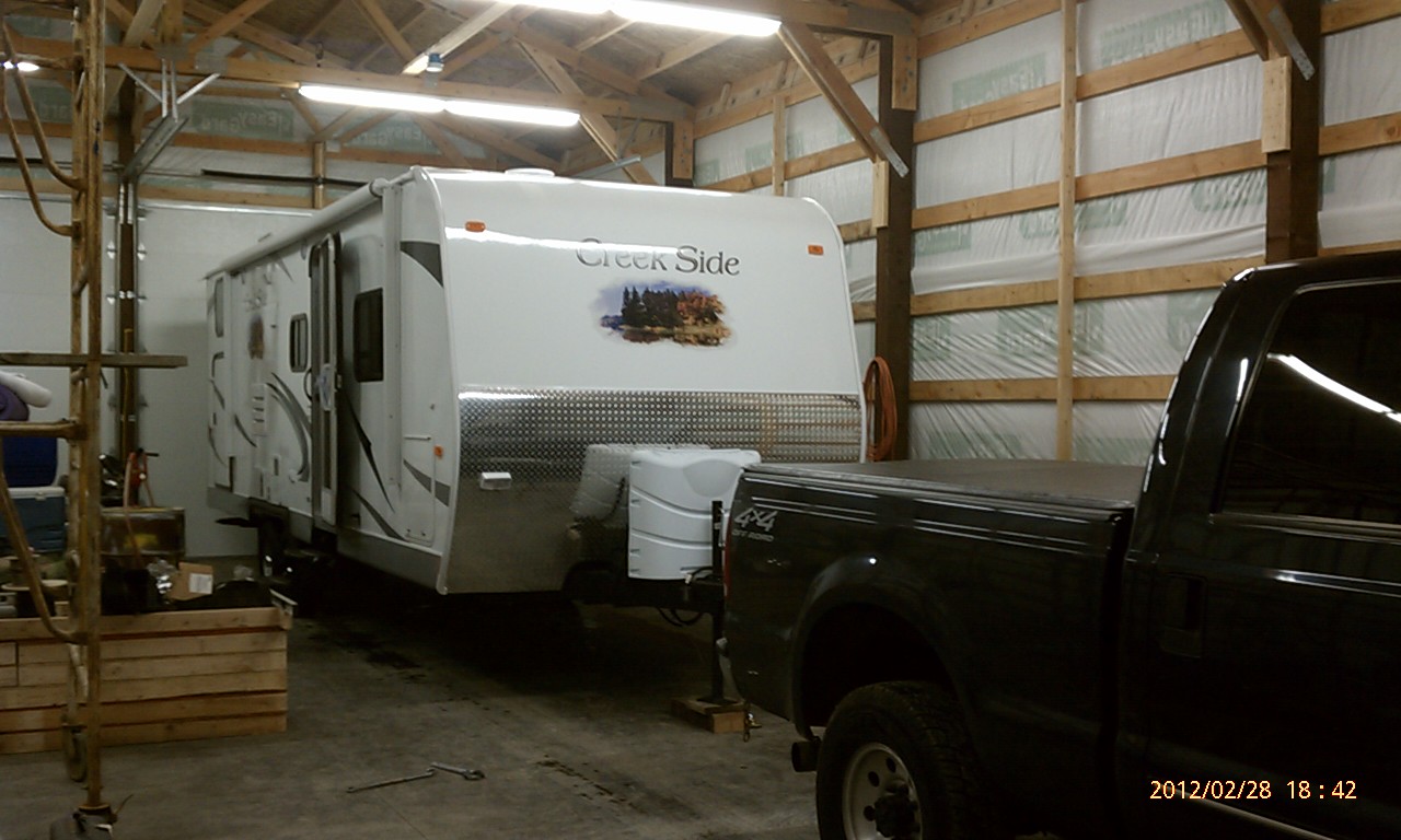

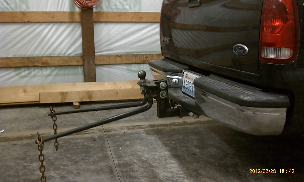

So I haul RV trailers and my PJ 10k rated equipment trailer but not at the same time. In the past the ball height was very similar for both of these trailers and I used the same WDH setup on them. I replaced the RV with a modern one which is much much taller. The ball height is way at the top of the grave digger drop shank. This is unacceptable for my equipment trailer and I am now looking at buying a seperate WDH setup for 300$ for the equipment trailer. I will NOT be raising and lowering the ball height on my current WDH setup each time I want to tow.
Even on a big honking diesel F350 the factory receiver is not rated to tow the equipment trailer without a WDH system. I believe the weight carrying hitch max was only 500# tongue weight.
So I discovered that it is actually cheaper to replace the Ford receiver with a class 4 or 5 receiver rated for a 1000 lb tongue and 10,000 lb trailer without a WDH and then buy a hitch and ball that can also be found rated for 10,000#. This will mean that my receiver is more substantial for RV duties, and also it will be easier to hitch up the equipment trailer.
What is the boards opinion on upgrading the factory receiver instead of buying a second WDH setup?

The new trailer. We love it but boy is it tall.

Thanks guys. I absolutely will keep and use the WDH for RV towing in any case. As you can see in the photo I have set up the hitch system for that tall RV trailer and now need something else for the EQ trailer. I have no problem finding adequate receivers and hitches to carry the EQ trailer without WDH.
I've just always used WDH with heavier trailers in order to obey the ratings. If I upgrade the receiver so that the WDH is not required then I can skip the WDH on the EQ trailer but will still use it on the RV for the normal WDH benefits.
Was avoiding the 2.5" receivers since then you need to either buy a bushing or the very expensive 2.5" stuff and since my trailers GVWR is 10,000 I don't need the 2.5.

The good news is that each of the hitch components is clearly marked with its rating. It is very easy, if you choose, to check the specifications and be sure that you know what your weak link is. Ignorant bliss is the other method and I agree that too many people are ignorant to the fact that most heavy duty trucks on the road can't tow a little car hauler trailer without a WDH hitch.
I am unimpressed that the manufacturers of trucks don't supply the receivers with ratings that are on par with the rest of the truck. The F350 should have a more substantial revceiver than an F150 for example.
For a couple hundred bucks, I can have a class V 2" hitch bolted up and fix this. The new receiver will not look any different but will have the all important sticker on it allowing huge amounts, way over what my truck can legally tow, to be towed without WDH.
My new weak link will be GAWR of the rear axle which is quite high on an F350. I should have replaced this receiver long ago.

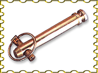

Not sure if it's related, but the hitch pin holes on my hitch (a Curt) have begun to slightly elongate/ oval out. It's hard to tell by just looking, but you can feel it with your hand and see where the paint is starting to crack. I haven't towed heavily on it, biggest load was probably around 9,000 lbs. Nowhere near the 18K it's supposed to be good for. Not sure if it's worth contacting them about, as I moved on to a gooseneck trailer.
/ New receiver to avoid WDH setup? #20
Most of the times I have seen the pin hole elongate its due to the pin design. The standard pin with a bend in the last 3rd are the biggest culprit.
I give all my customers Cat 0 top link pins. They are 5/8" just like a standard hitch pin, are nice gold plated, have a square shoulder, and cost just $2 at TSC.
I have ran nothing but for 20 years and they work great plus the lynch pin seems to be more secure than a standard pin clip.
