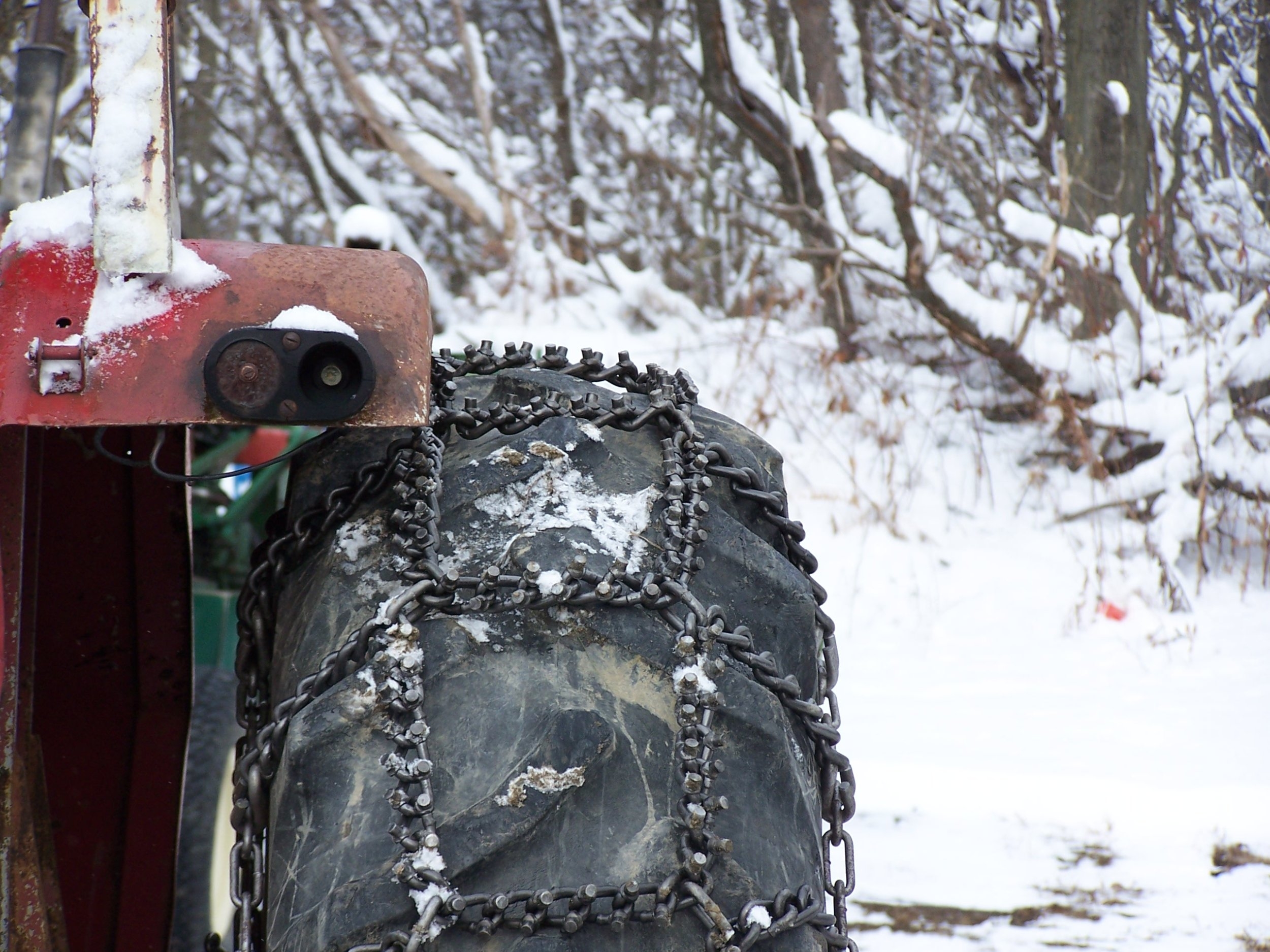

Many tractors will get several thousand hours on a set of tires, the fronts (on a 4wd) will usually be replaced 2-3 times before it's time do do the rears. My IH574 has an unknown 1000's of hours on it and the rear tires, if it was being used on hard pulling jobs it would need new sneakers but as it's a generator and backup tractor that doesn't get much mileage on the tires they still hold air and only have a couple of repair boots inside the tires they still work.
these tires have numerous cracks in the treads and sidewalls each one has at least two boots in them to patch punctures/tears in the carcass. But they still hold air and keep the chains on for the winters.
If they were on a primary tractor doing lots of work I'd change them, but even when the tractor gets a hundred hours on the engine she is likely to only get 5-10 miles on the tires.
