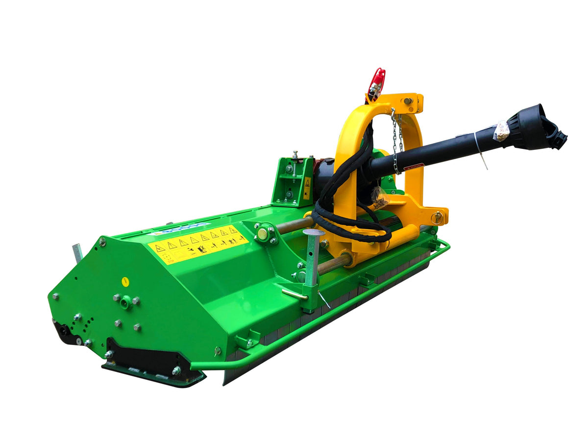

Hi,
I am seeking opinions regarding a Flail mower with Hammers (CAT 1). Use is mainly to cut and maintain a perimeter trail around a 28 acre forestry parcel I own. The land is mainly flat, no rocks (on the NC coast). Small pine trees/weeds/etc are the main thing to be kept cut.
My main limitation is likely the Tractor's 35hp. Manual or Hydro offset would be a plus as I have a rear remote for that.
Thanks
   / New Purchase Flail mower with Hammers #2
These flail mowers from Nova-Tractor are some pretty heavy duty mower. I'm thinking of going with one of these after I've sold my ditch bank flail mower that was a little too small for what I do. They use Italian Comer Industries gear boxes.

Hello and good afternoon AB4D,
Your mules available PTO horsepower places a limit on how large an orchard and vineyard shredder flail mower with
hammer knives you can have. One pair of remotes limits you to a simple side shift model which will be an easier implement to take care of.
1. The Maschio brand the Giraffa S model with the 3.8 foot cut with 24 hammer knives is as large a flail with side shift is the largest shredder you could consider for a flail shredder with your mules available PTO horsepower and useable torque.
With the 5 foot Giraffa S flail shredder you will be using all of your available horsepower and torque with little
power in reserve. With the 4 foot flail shredder you will have plenty of reserve power to use.
The double acting swinging side shift frame design that the Maschio unit uses avoids having cut brush and dust build up on a side shift hydraulic cylinder that is center mounted on the flail mower shroud and it can cut a wider swath
when extended.
2. the Del Morino Funny Top model has a manual side shift that is 8" left or right of center and is well within your mules PTO horsepower and has no hydraulic cylinders.

If you decide to get an offset flail, get a hydraulically controlled unit. I bought a Maschio Tigre 300 that was mechanical slide and it didn't take me long to go to Ag South and get a cylinder for it. I'm not a fan of ditch bank flails if you are just cutting flat places.
