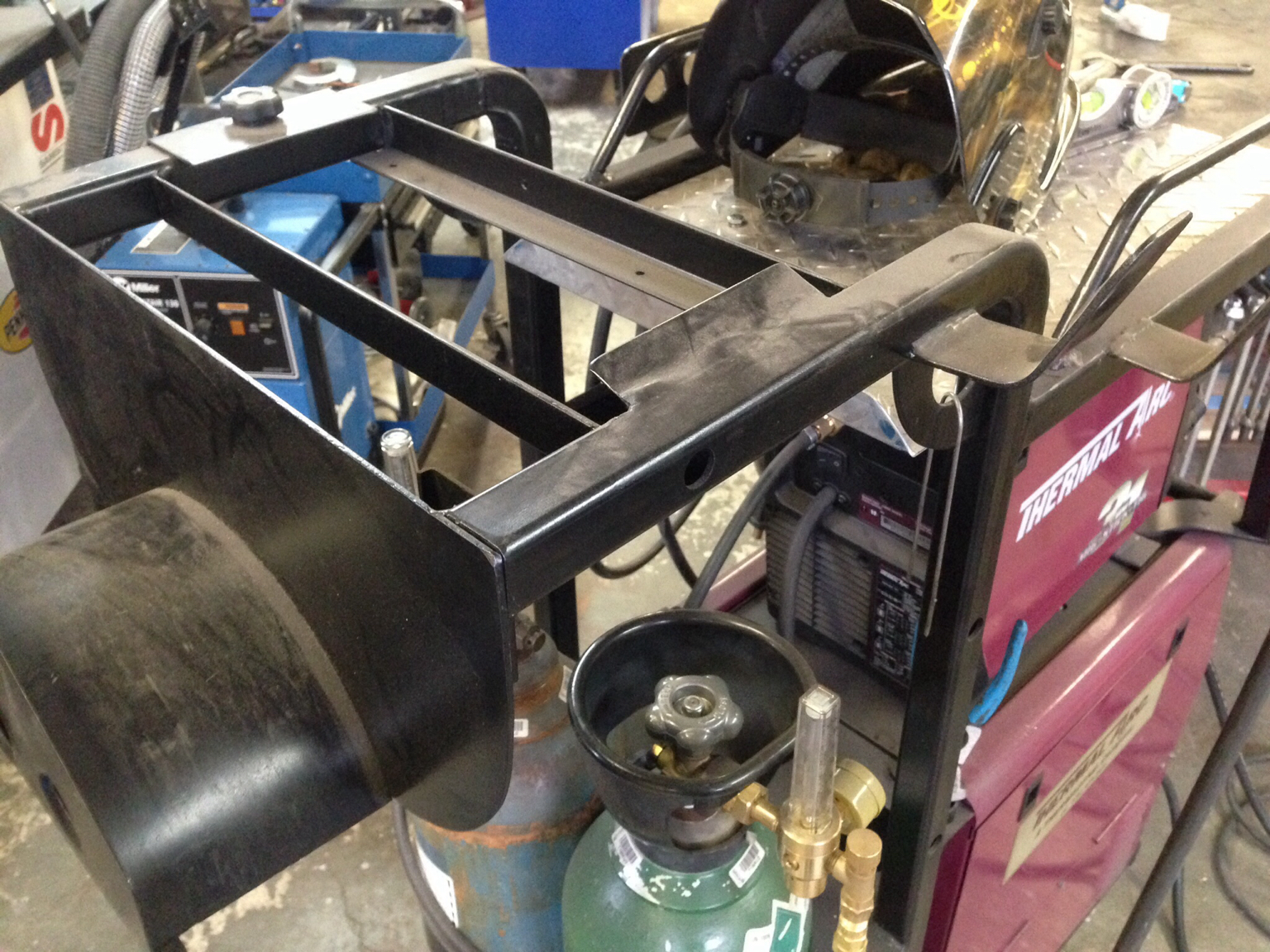

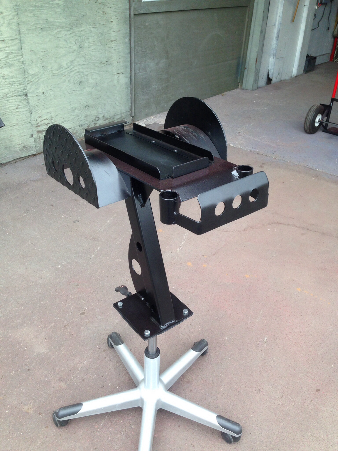

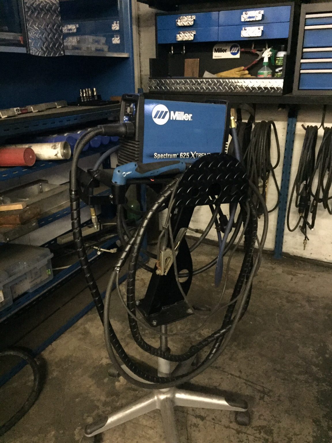

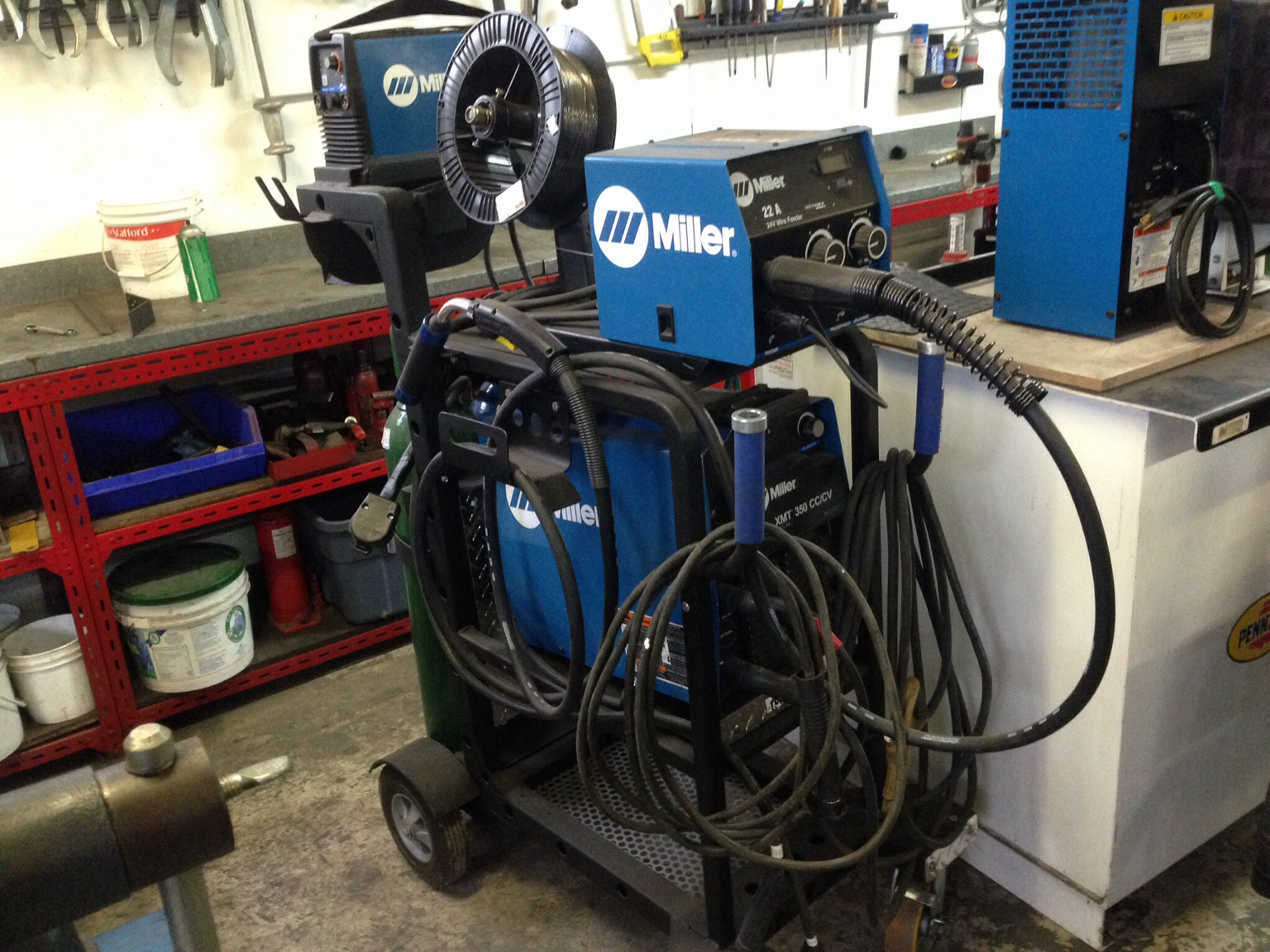

Mark, here's a couple ideas to consider for cart-mounting your new plasma cutter.
My carts have a tilt and slide design to secure the machine without fasteners, straps or tools.
The top photo shows a Miller Maxstar which shares the same dimensions as my Miller Plaz.
Third and forth photos show a dedicated plaz cart
Hope this gives you some ideas.
Terry

Whoa! Thanks Terry... I like the plaz cart idea! Is that a shop fab from an office chair? Is it top heavy at all?
   / New Powermax 45XP! Crap... I was just about to pull the trigger! #29
Not top heavy at all, Mark. Prolly the only thing tipsy in THIS shop is the old fart who works in it after a few beers. :=)
