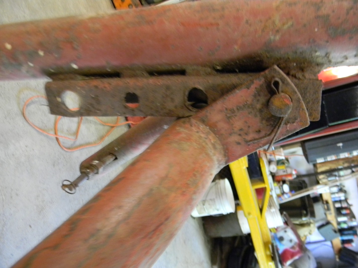

Well, new to me.
Found a good deal on CL for a PHD. Went to look at it. Gearbox felt nice and tight, no slop. But frame has seen some abuse. Auger is the heavy duty 9" double flight but shear bolts are wrong size and bent. Boom adjust holes are all oblong. Lift pins are loose. PTO shaft yokes are good but U-joints are bad. Generally sound just some U Joints, new pins, make a new boom adjust out of C channel. Unit weighs 198#. I found the center of gravity and will weld on a lift hook.

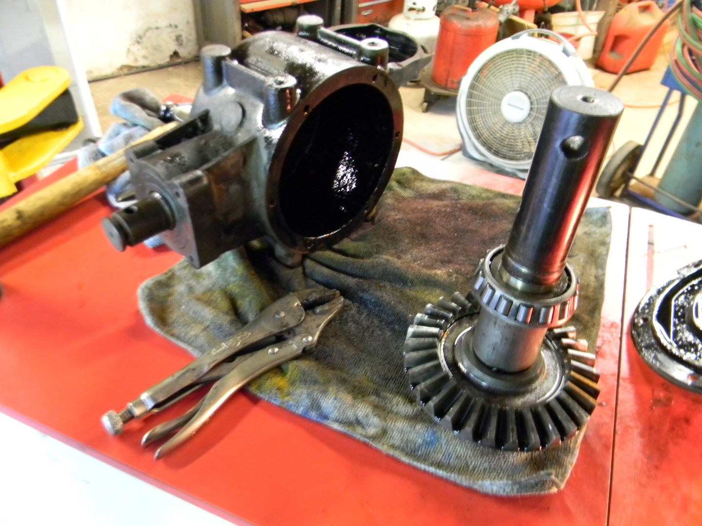

Some pics are out of order but you get the idea. Cut off the old boom adjustment C channel and made a new one and welded it on. Gearbox is a Comer (made in Italy). 3:1 ratio, 1 1/4" input shaft, 2" (w / sleeve) output. Took gearbox apart for inspection. Everything looked good except the gear lube. It was old and black but was still doing its job.

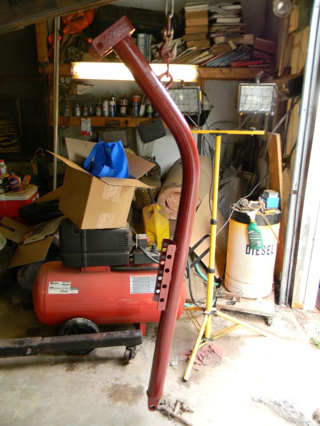

Reassembled gearbox and painted. Welded on lift hook. Painted boom and lift yoke and assembled with new pins. Refilled the gearbox with fresh 90-140 lube. Local TSC store only had one U-joint in stock so will have to make another trip to get the second one. Once I install that it will be ready to go. Still need to get a couple more different size augers but other than that I don't think I did too bad for only investing a little time, effort, some materials and less than $400 in total.

That's why I welded on a lifting loop. I can now hang it from the rafters with a rope and pulley or from a tree outside. The 9" should be good for setting 4x4 and 6x6 posts. For 6x6 it will be close and holes would have to be near perfect vertical. A 6" for fence posts and maybe a 12" for larger shrubs or small tree balls. Depending on how much use I get for it I may convert it to hydraulic driven instead of PTO driven. Then I'd have reverse to unscrew it. This same PHD was available as a hydraulic driven unit.
