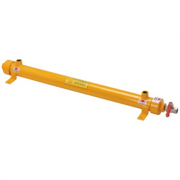

So today UPS arrived with my PowerPlasma 60. I'll post pictures below as I upload them. I quicky connected a 50 amp plug, the one that looks like an over sized 110v plug and connected up the cables. The cutter came with a small in-line filter, one thing I would like to have seen is a bracket to mount it to the back of the cutter. Other than that with in a few minutes I was ready to cut.
I ran into a few problems though. First I didn't have anything I didn't mind cutting. I finally found an old flywheel that I had welded a pipe to so I could drive ground rods. It had been sitting outside for a few years and was kind of rusty. So I cleaned some of the rust off to get a good ground and I was ready. Well not really. My pressure regulator was/ is stuck. Mark has said that if you put a full 175 psi into the back of it you could blow off a line inside the cutter so I shut off the compressor at 95 psi. It's 33 degrees out so I didn't want to run my refrigerated water separator (don't think I needed to). So I was ready to go.

So I had some time to play with the plasma cutter a little more. First I had to clean my regulator and mount/ plumb my air drier. The in-line filter that comes with it didn't include the mounting bracket shown in the on-line manual. After looking through the consumables I found the bracket and the screws needed to install it (much different looking than the manual). I ended up installing a small regulator before the filter and it's set to 80 psi. I also replaced the push lock connectors for the air line between the filter and cutter with ones that are 90 degrees. When I get a chance I'll take a picture.
