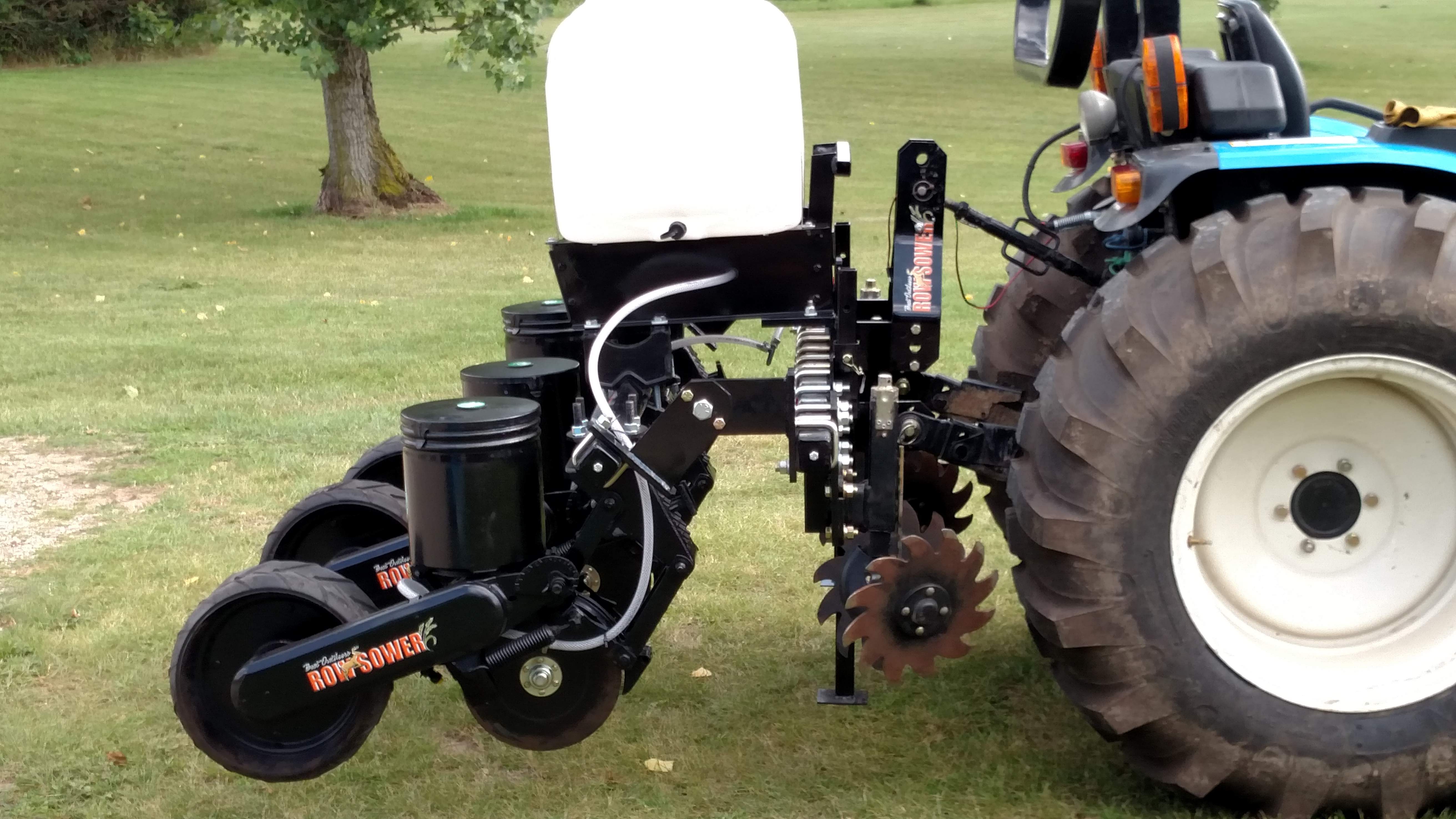

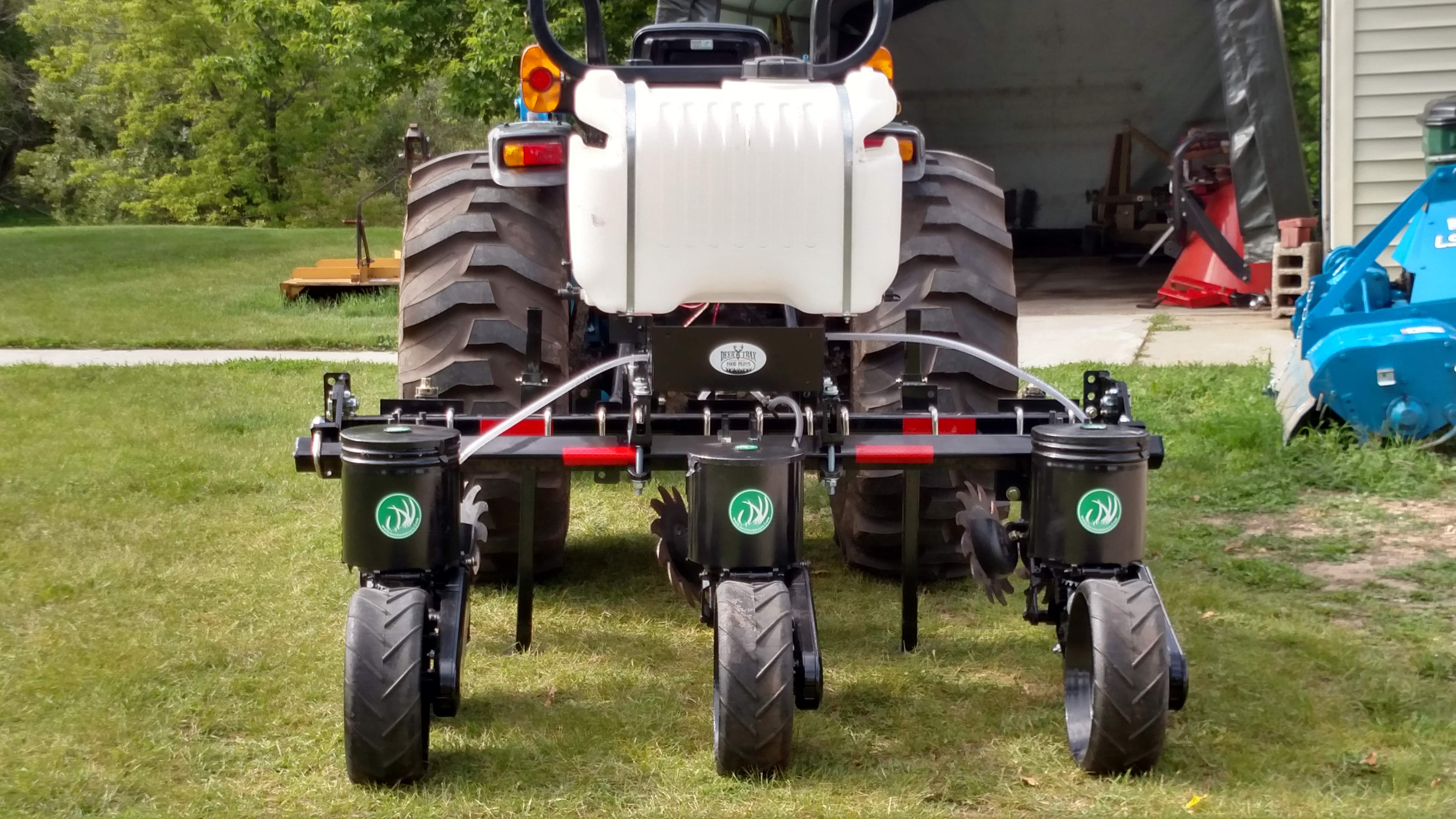

had this planter built with some deer 71 planters ive collected over the years
and decided to donate my 3pt spray rig for liquid starter fertilizer also tried the row cleaners
still plumbing up the liquid and I know its late in the year but got use it sooon im all grins. if I can remember how to put

I'm curious about the fertilizer set up. Is it just gravity fed?. I have a old injection (John Blue, I think) for injecting application. Do you not need a pump? bjr
/ new planter
no there is a pump at 20psi should put down 15gal an acre, I am still in
the process of getting it set up, im having a fab shop make me up a nice stalk
to mount my flow moniters , so I can easly see from the seat to verify there all getting
juice.would do it myself but but layed up with a bike accident at the moment haven't been to work in over a yr

Just curious, after planting, is cultivating going to be possible with the 2 outside units planting in the wheel tracks?
would a 2 row setup between the wheel tracks work better for possible use of a cultivator for weed control?

first off my tractor is set up a little diff as rear tire spacing wont allow it to navigate 30'' rows which is what the planters are set at so therefore the outer planters ride just to the outer edge of rear tire track not uptimum but 30'' rows is whare its at for corn and soybeans and RR corn can just be sprayed,also this is mainly just for food plots so no cultivating lol and at two row with 30'' spacing would be to the inside tire tracks, we are splitin hairs but with a good weed control plan starting out will have little problem with weeds if the corn gets a good start with the liquid starter fertilizer it gets up before weeds can get ahold the corn or beans will over power the weeds by growing faster and if weeds become a problem can always spray but keep in mind this is mostly used for food plots for wildlife, the starter fertilizer will be a great benefit

keedeep thanks for your post as far as the special equip, thought about adding another culter just for the liquid to put it 2'' off to side would require another incorporated tool bar, nope to much hassel instead ill be using MONTYS liquid starter fertilizer they say can be directly sprayed on the seed so im spraying directly into the double disc opener, will see. after my liquid system is complete im going to hit MONTYS up for further support local co-op says rep will come out to advise. sounds like you could broad cast something like oats drag in, plant a short 60 day corn with planter over top of the oats, once everything is up flood, 6'' water should allow ducks to almost reach the ears of a short varity of corn. a soil test is always the key. my quad can run 30'' rows to use a foiler type of liquid fertilizer in spray rig with less getting to weed and more to crop. happy to share my exp. with ya also interested on you results. I have a batch of corn that I just broad cast with tilled in urea is going gangbusters almost head high now have not sprayed for weeds but got up before the weeds can be trouble
