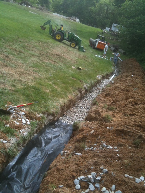

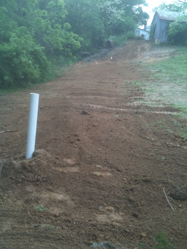

About the leach field. My 790 had the #7 hoe as well. Very good for what it is. The new to me 4310 has the 47 hoe on it. Just a bit beefier. But still a kick in the a** to dig a field with it. I did about a 125' field with it and was on that thing the better part of a weekend. The guy I know who sucked my tank out before I started had a good laugh when I told him I was going to dig with the Deere. Said I'd be all weekend. I was. Oh well I told him that's all I have. Got it done but if I had to do it again there would be a mini ex rented.
Just saying...

Forgot to put the proof pic in
Boy..that's a heck of a slope you're working on...with the ROPS down too!!
I mean..it's so steep, the houses are built on an angle!
Well Roy. You caught me. The first owner damaged the top bar for the rops. So I've never had it. I know I know. I'm being not only cheap but stupid. Let the safety police stoning begin:-(
