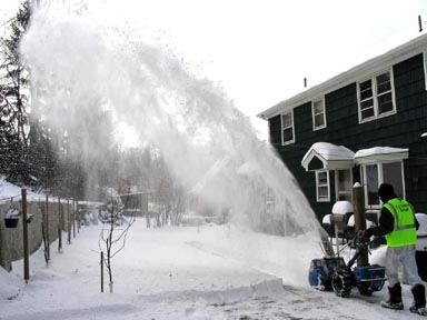

For anyone who wants to see a BCS with and 8hp Kohler engine blowing snow here is a picture sent to me years ago by Dave_in_CT. I believe he told me it was so much fun he blew the whole backyard. If you aren't having fun with your machines you have the wrong machine!

Very cool picture!
