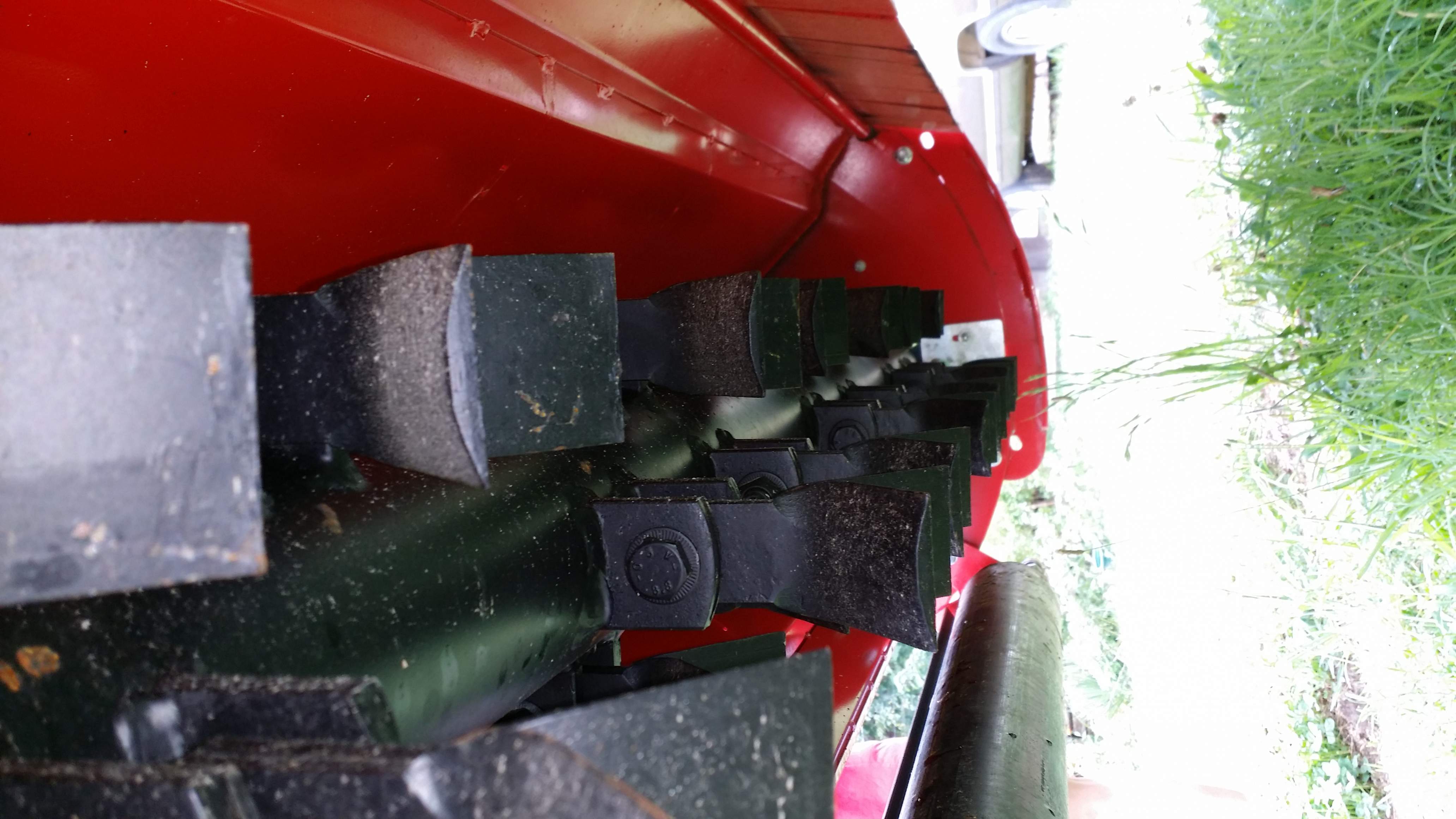

Thanks and beats me. The gentleman was 75 years old, though. Dealer that sold it confirmed it had same hours on it as when they dropped it off and put it in the man's garage. The flail mower still has all the factory paint on the y-knives. I didn't get a manual for the mower, either. The manual that was strapped to the pto shaft was for the pto shaft :(

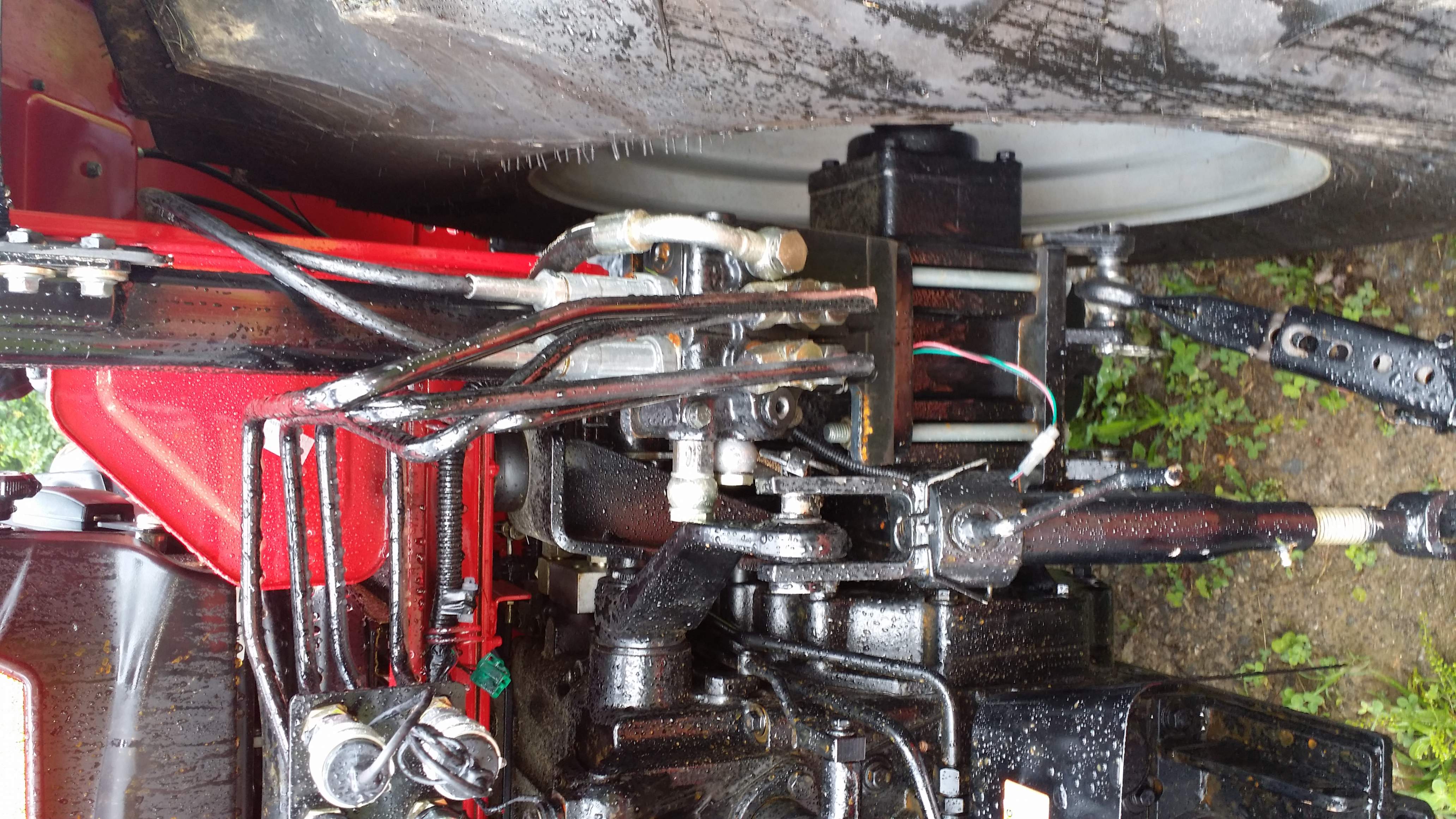

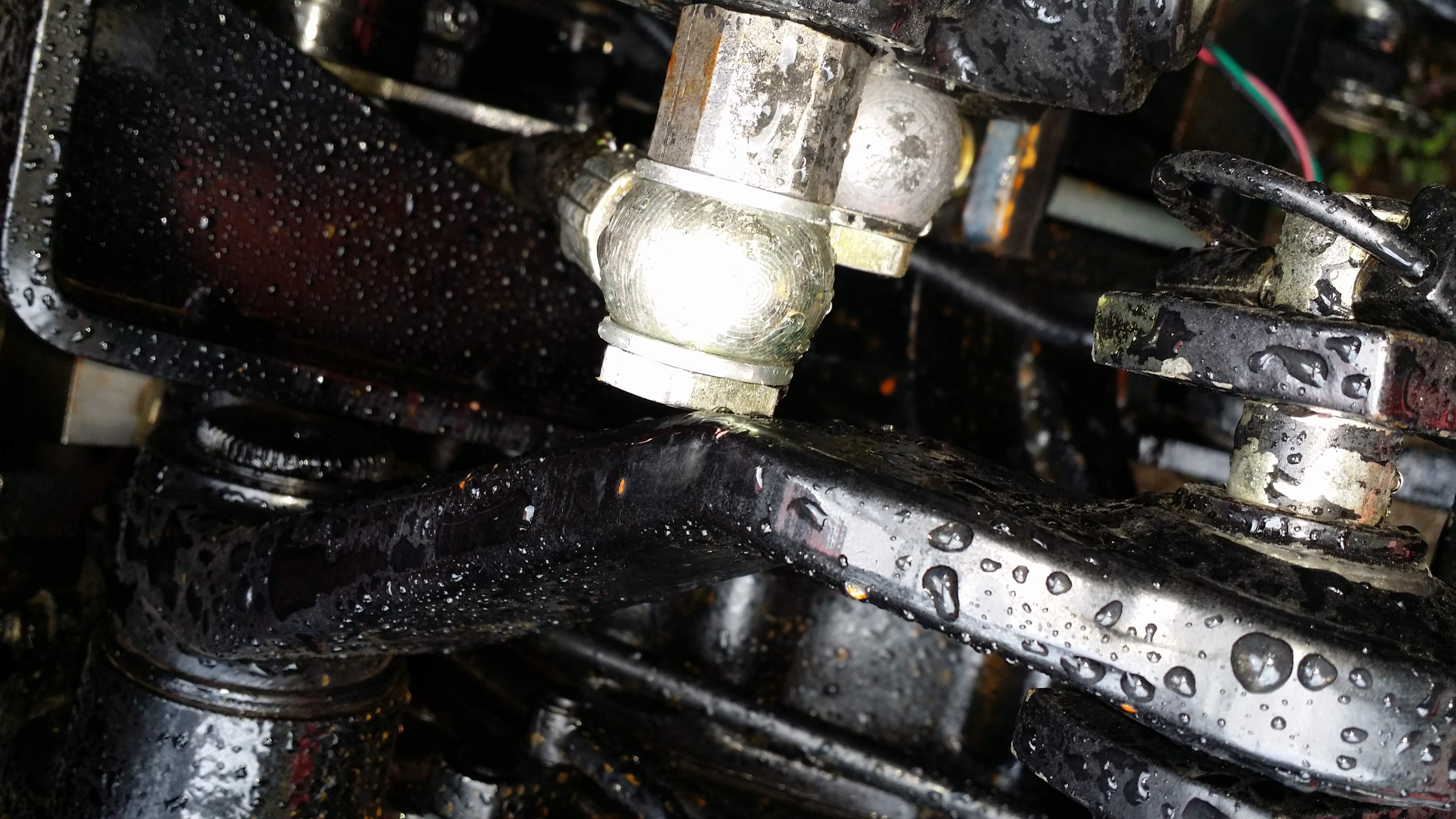

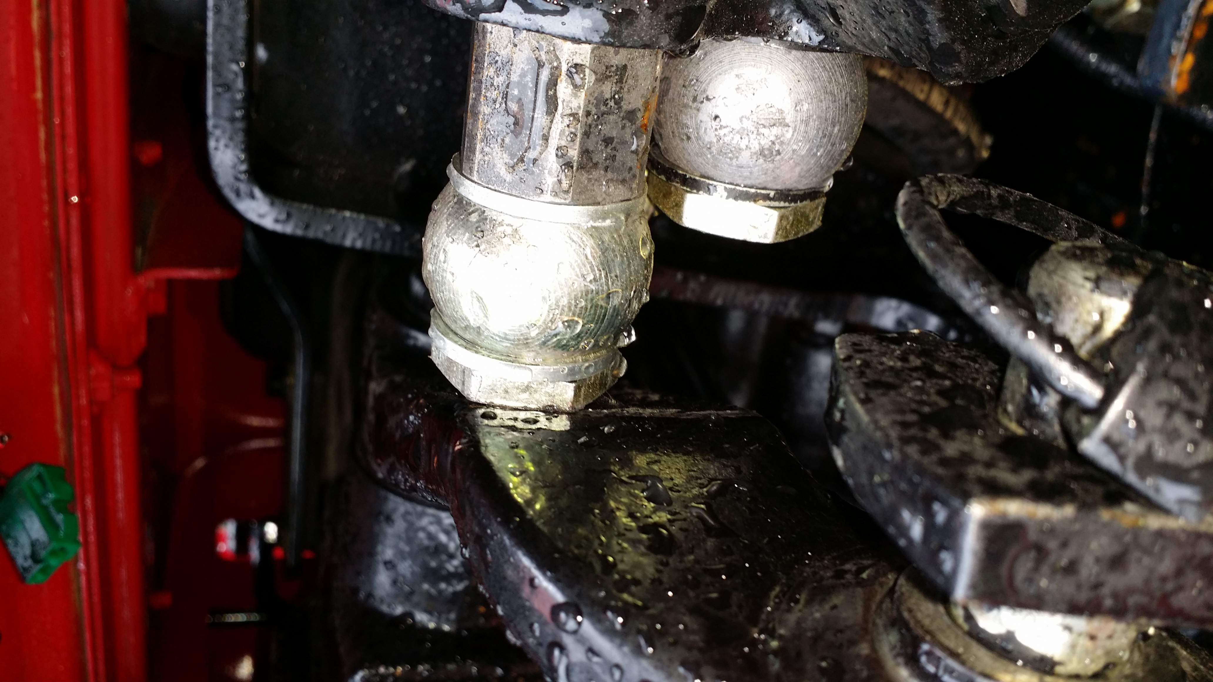

The rear tires have fluid in them, but I forgot to ask what they used and how much was put in them. It's been raining here off and on since I got back, so haven't been able to use it. Did drive it down to the barn and the R1s printed the ground , but as wet as it is, I'm sure the R4s would have done it a bit, as well. The routing of the hydraulic lines could use some fine tuning and when they put the second remote on, the upper lift arm rubs against a bolt which marries to some kind of spacer or adapter coming out the medial side of the remote valve body. The rest of the bolts attach the hoses directly to the remote valve body, with out the spacer. Does anyone else have this same setup or a different dual remote setup? I'm wondering, if I can get rid of that extender. The pics will explain it better, but you'll have to pretend your from the "land down under" to view them :cool:

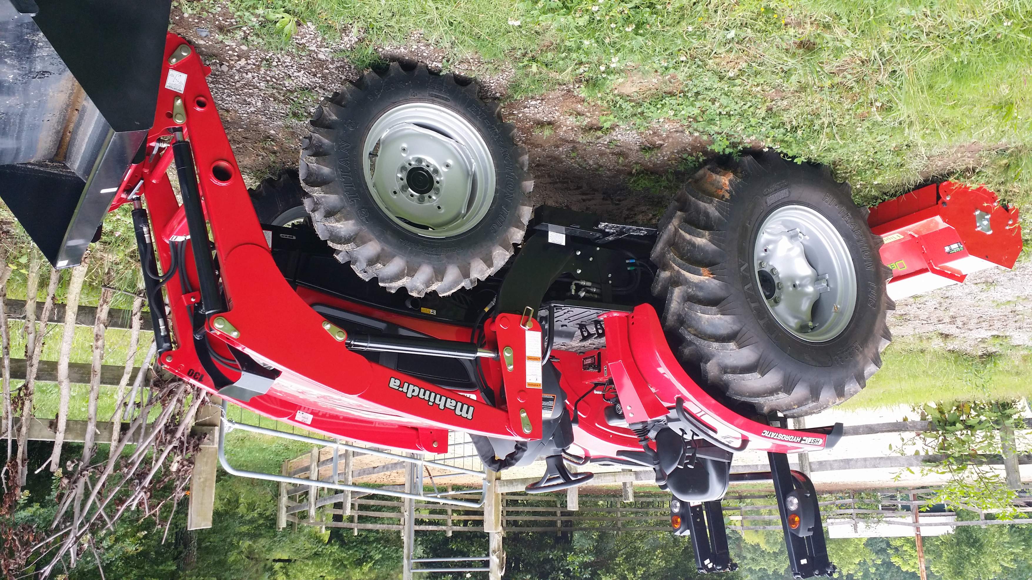

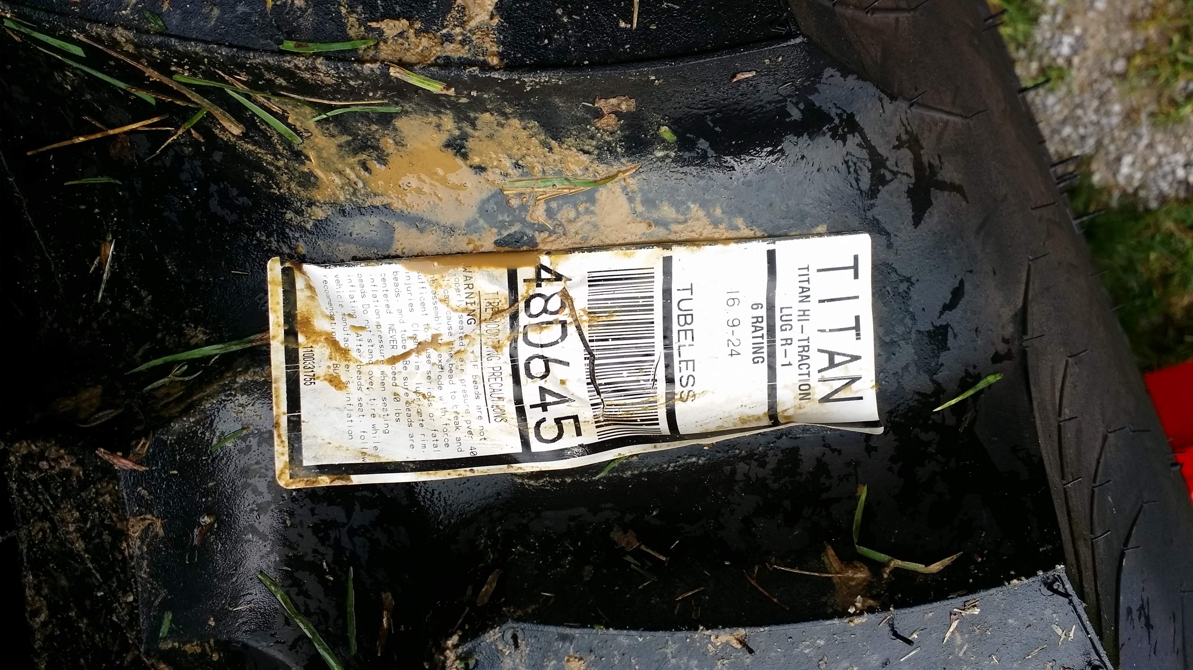

Here's a side view of the beauty and the tires still had the labels on them anim_lol.gif holy-sheep.gif, I can't get the pics to orient correctly. I hate Photobucket! does anyone else use a different photo service?

I took a closer look. There are 2 aftermarket hoses, one that comes in under the one with the spacer and the one running up to the front inside the back right fender. They used, what appears to be a the factory hose for the one that has the spacer. It is routed between that triangular shaped body mount and the draft pivot linkage. It is rubbing on both sides. There is plenty of clearance between the banjos to mount the hose directly to the valve body, but the hose is too short to make the bend. A longer hose would allow me to re-route the hose along the other one, below all these points of contact. I'll loosen those axle bolts and try and scoot the bracket over a tad, until I take it in for it's initial service. Then I'll ask my local dealer to correct this problem. Whoever routed this must have an IQ of a nat. wedgie.gif

Love the grapple you've got there flatpik6. How did you run those lines? Btw, loosened the axle bolts and shifted the bracket ofr the remote valve body and shifted it over and obtained enough clearance to avoid lift from rubbing on the banjo bolt. A longer hose would fix this problem in a better way, though.
