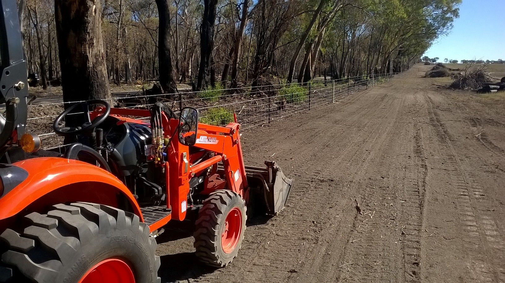

I promised I would post some photos of the new machine - sorry I don't have any action shots. Here are a couple showing the new fence after clearing the burnt timber off the fence line.
The local Council (the government body that controls the roadsides) is pretty touchy about any tree being removed that was not affected by the fires, so you can see that a lot of trees that could fall across the new fence have to stay.:(

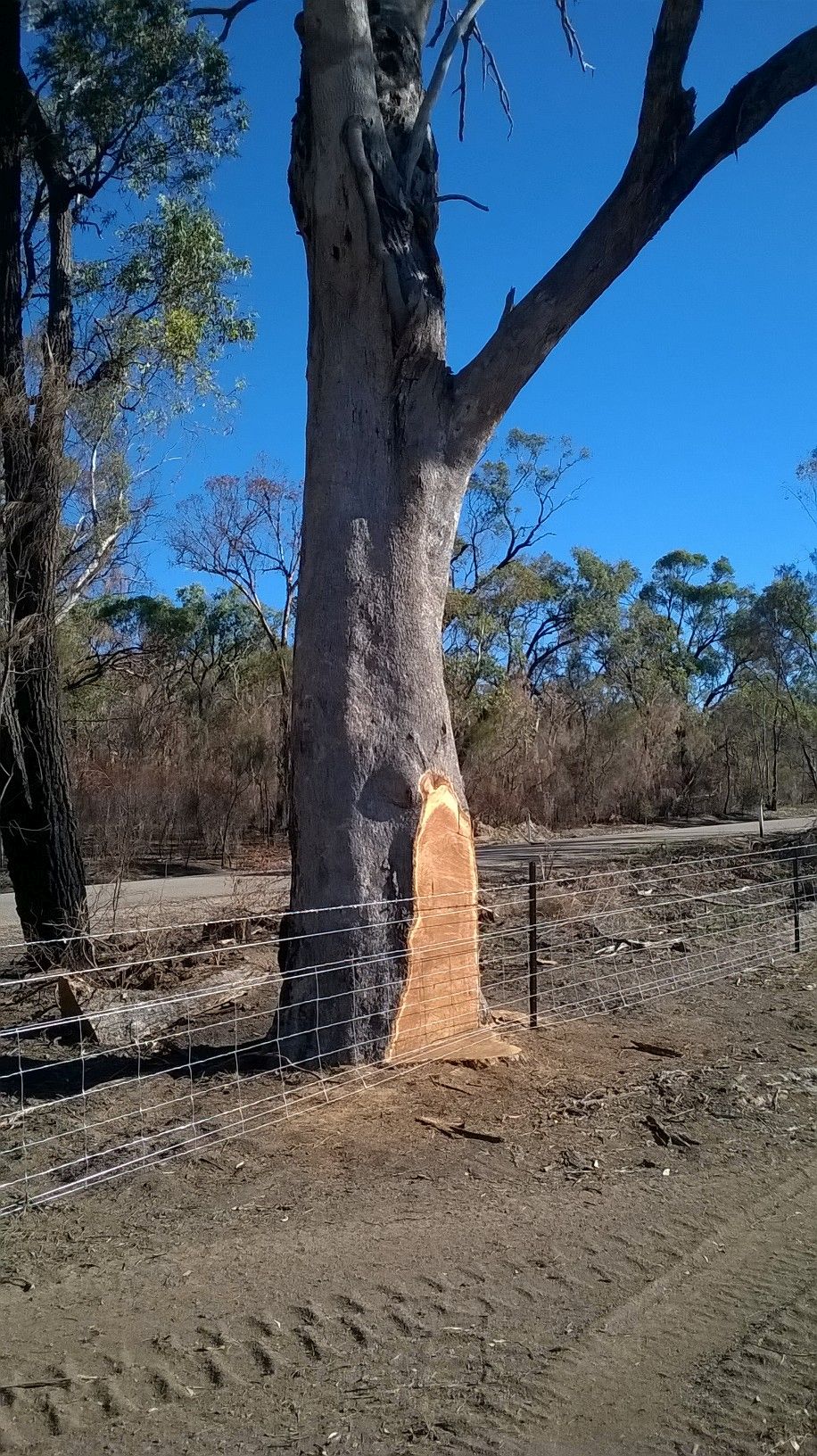

In fact, if you want a straight fence you have to make "adjustments", such as in this photo, to some trees that you are not allowed remove.:eek:

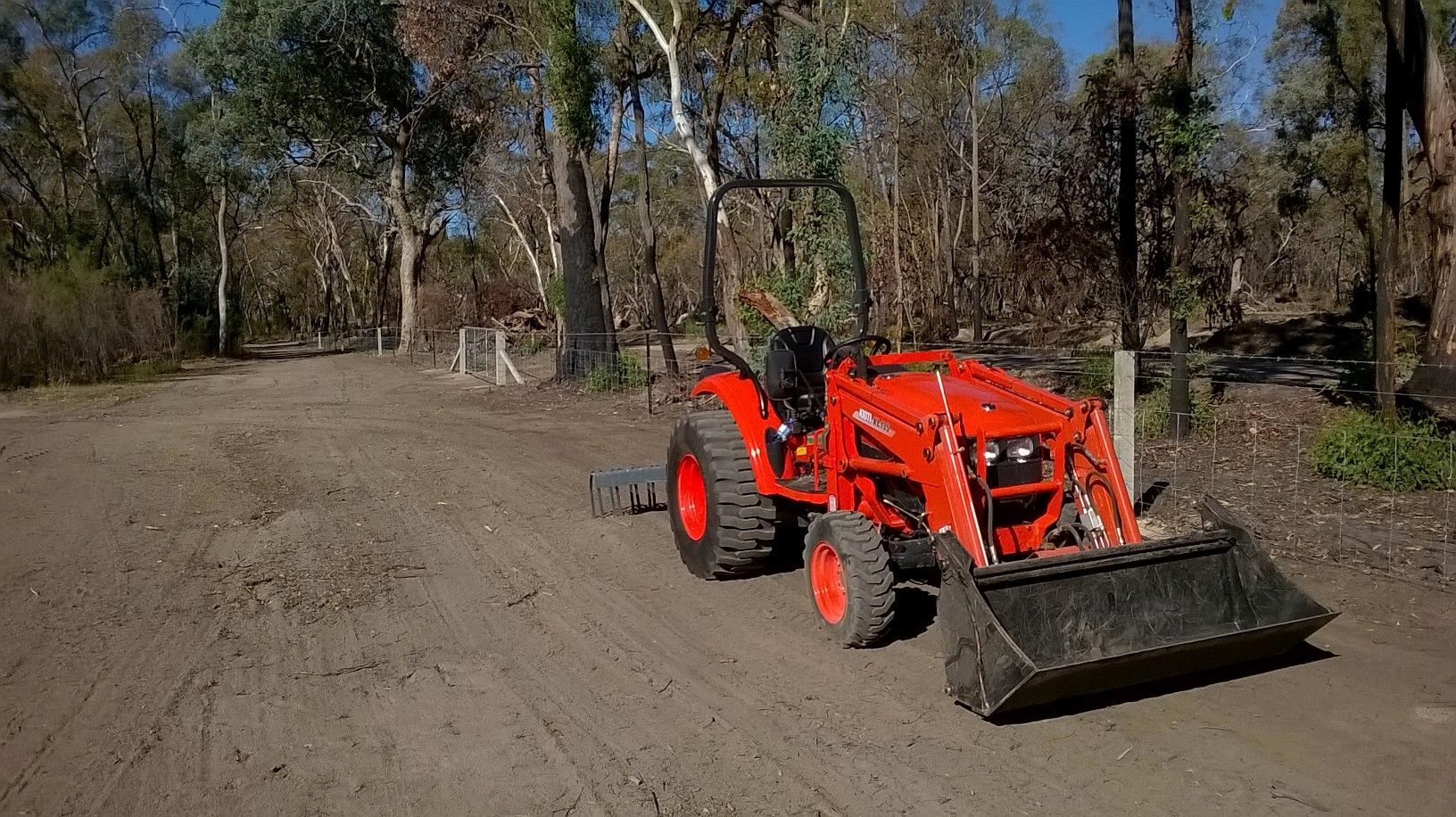

There is still plenty of work to be done, but the FEL with the 4 in 1 bucket sure makes life easier.
This is a shot of what another 3 or 4 miles of internal fencing looks like. The black ground sure is a contrast to the feet of snow I'm seeing from you guys in the northern US and Canada.:laughing:

First, welcome to the forum. You have a very nice machine there. That clamshell bucket will really help with your brush piles. Keep the pics coming.

Nice fence. What are your main fenceposts made of? They look like concrete.

Nice looking tractor!! Looks like a different front loader than the ones here in the states. It looks well built what is it rated to lift?

Thanks!
The plate says that it has a rated lifting load of 350 Kg (770 pounds) with 200 Kg (440 pounds) ballast. I have been feeling my way with logs, getting slowly bigger and have not tried anything yet that it would not lift. I have loaded tyres and usually a 6 foot grader blade on the back (not the stick rake in the photos). It has not felt close to raising the back off the ground.

Yes, the main posts are concrete, 20 metres (65 feet) apart, with steel posts every 5 metres (16 feet). This is pretty much the standard type of fence around here these days. The distance and height varies depending on what you're keeping in or out.
My late father in law used to make his living cutting timber fence posts in winter (bee keeper in summer) but more and more regulations and restrictions on what tree could be cut down just made it all too hard in the end. (It got to the stage where every individual tree had to be inspected and approved - even on private property.

Yes, that is the KL135, my loader is the KL130. If the specs are right, its about 400# less lift capacity than the KL130. Looks like a slightly different layout too.

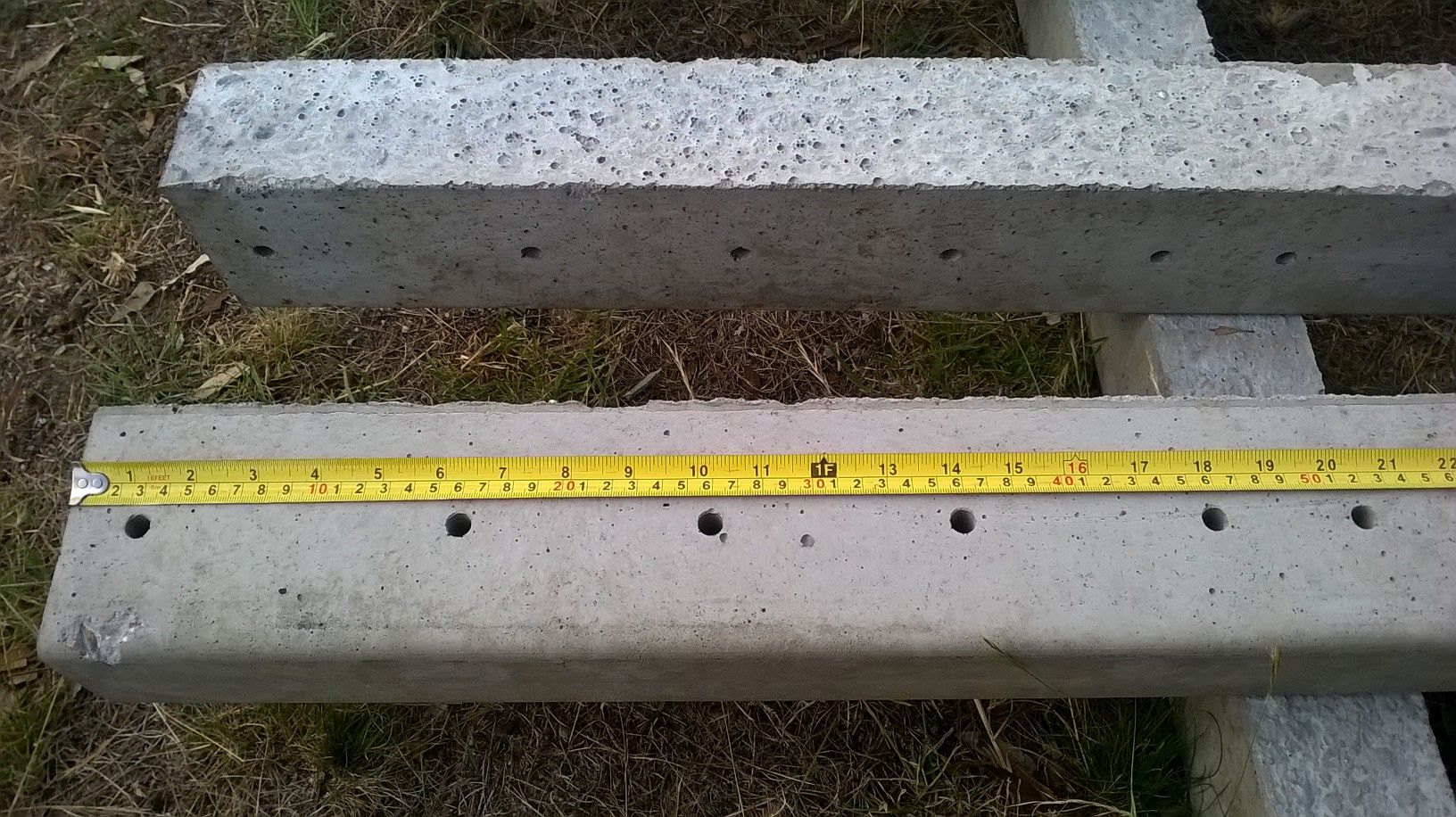

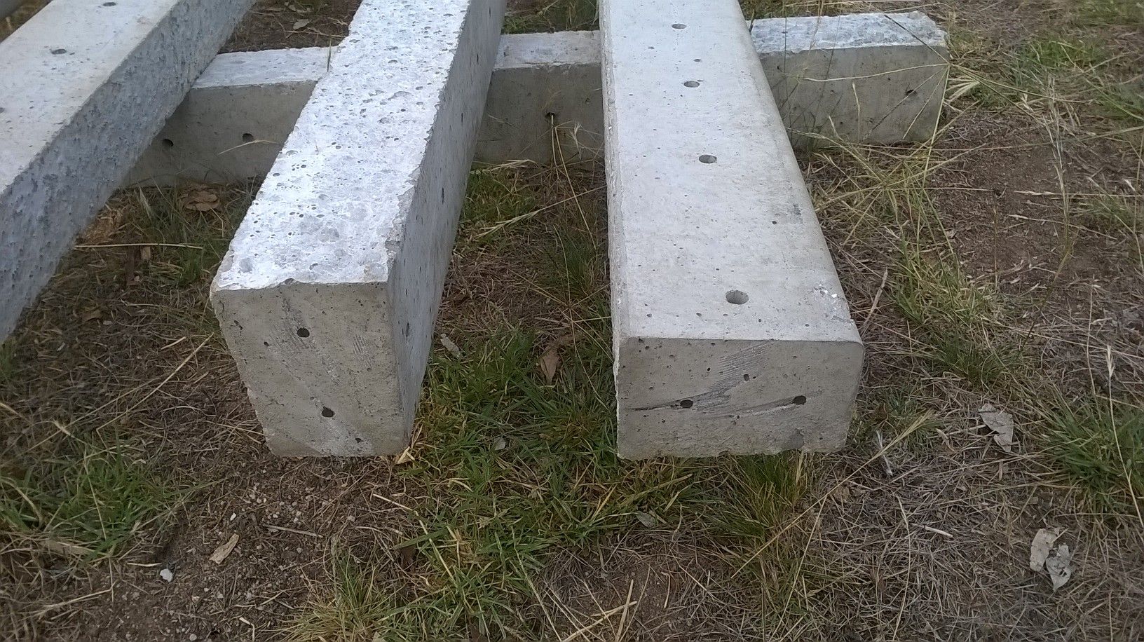

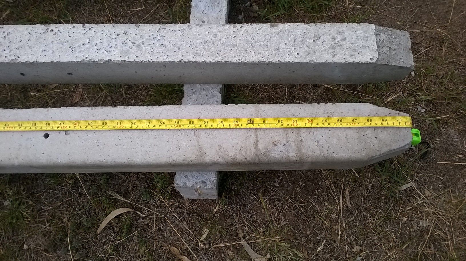

Here some close up shots of the concrete posts available locally. They are slightly different to the ones on the website you found (no larger holes for barb).
They are 6 feet long - 2 feet in the ground, 4 feet out - with holes matching the steel post layout. They are 4 1/2 inches wide on the hole side and taper from 3 1/2 to 2 3/4 inches on the other.

Thank you. So far I have been making only the larger end and corner posts and using steel posts in between. After seeing these line posts, I may try to make some forms for those as well. It looks like they are tapered to the back, so they must be just lifting them out of the forms. I break down my current forms which is time consuming.
