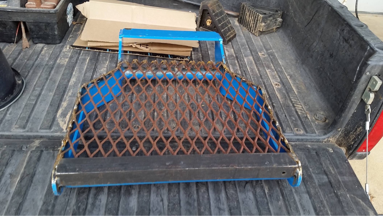

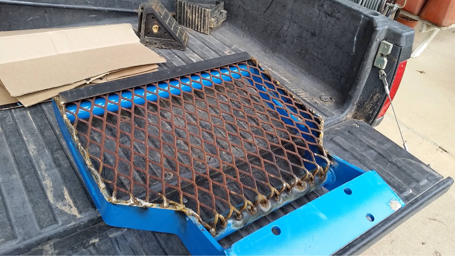

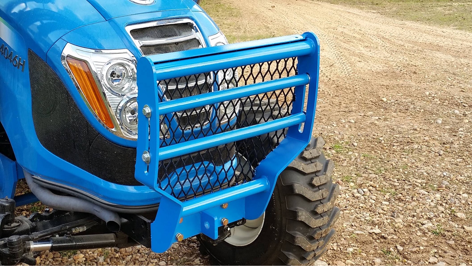

Brush guard was pretty easy once I got the expanded metal cut and bent. I added a piece of angle, at top, to have a flat plane to install magnetic base for front video camera. I posted a Sherwin Williams recipe perfect match for LS blue paint and I painted the expanded metal satin black.

What did you use for your additional bars? Black iron pipe?
   / New LS owner with a few questions: XR4046 #27
I built everything from materials I already had. The two middle bars were some seamless tubing I had. Tacked a 3/8 nuts to fender washers then welded the washer / nuts to end of tubing with nut to inside. So, created captive fasteners. Used 3/8 bolts and flat washers thru the slots on side of the guard.

I have some 1" square tubing, that I was thinking of using. My thoughts were welding it to 1" angle iron then bolting that to the guard.
My welding skills are not on par with yours.
To me your guard is a work of art...
I like my tractor a lot, but LS certainly did not put a lot of effort in their guard, or maybe they want to sell more hoods and grilles:)

That's purty, been thinking of doing the same to mine,
