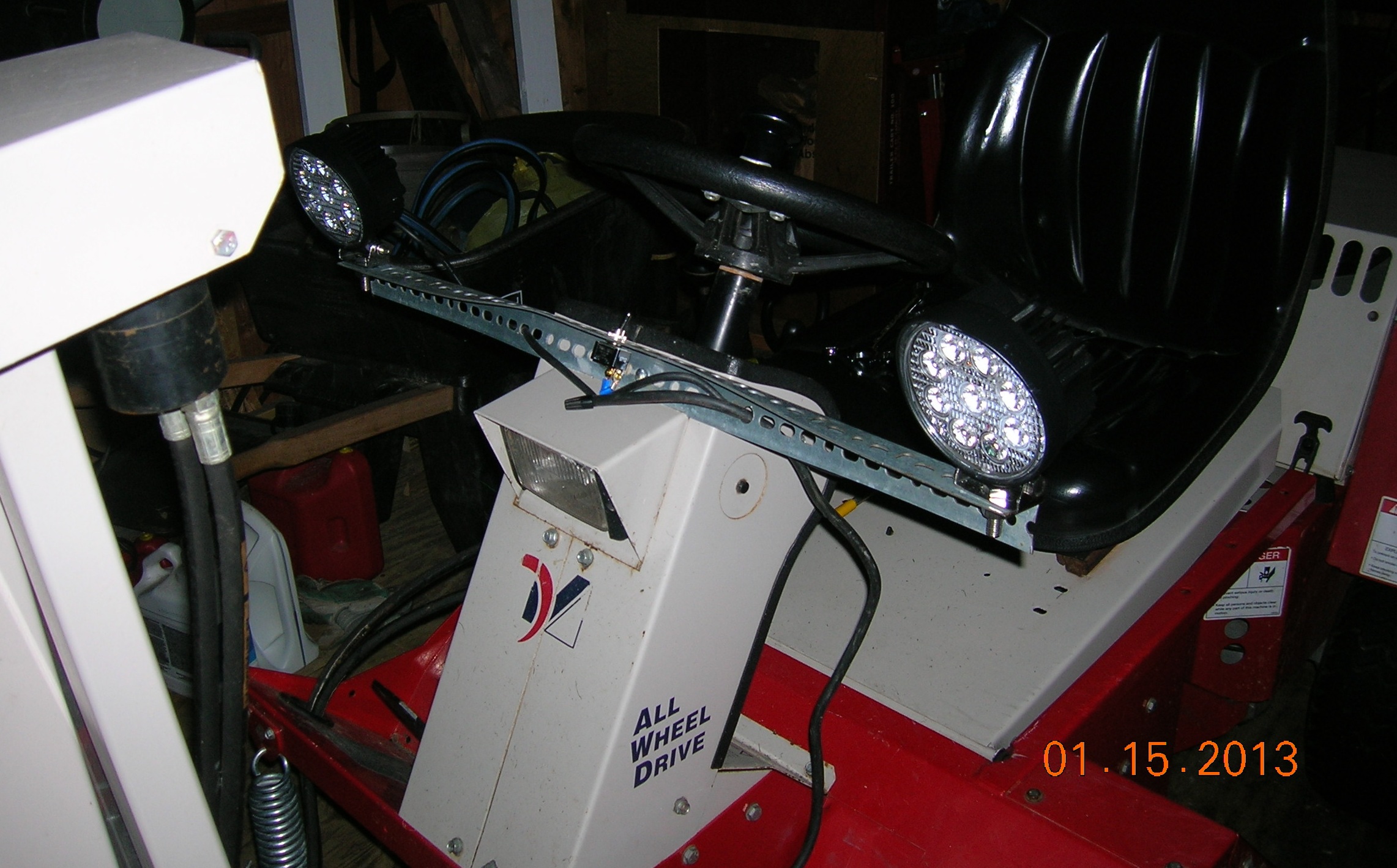

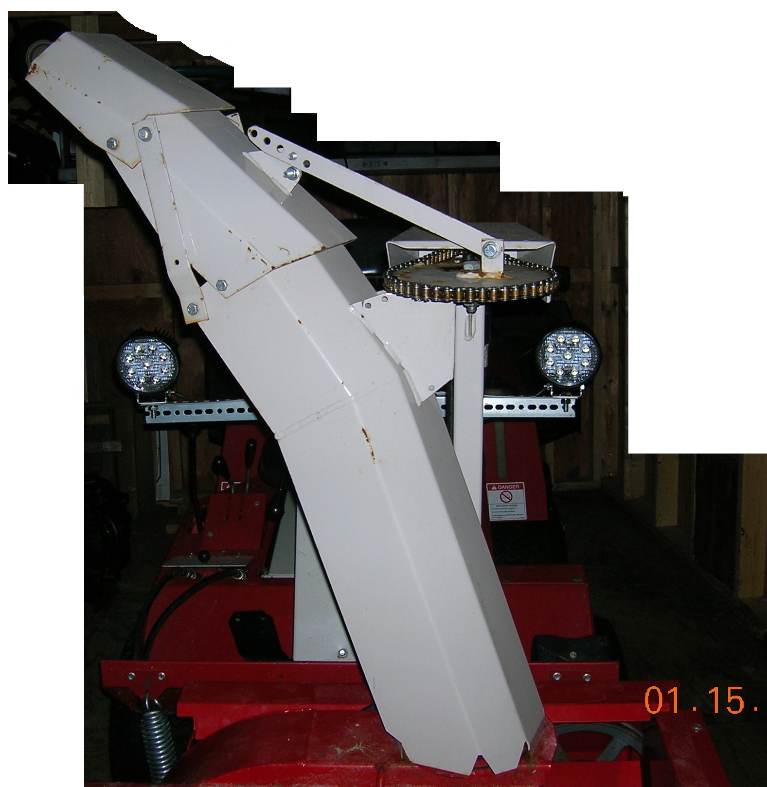

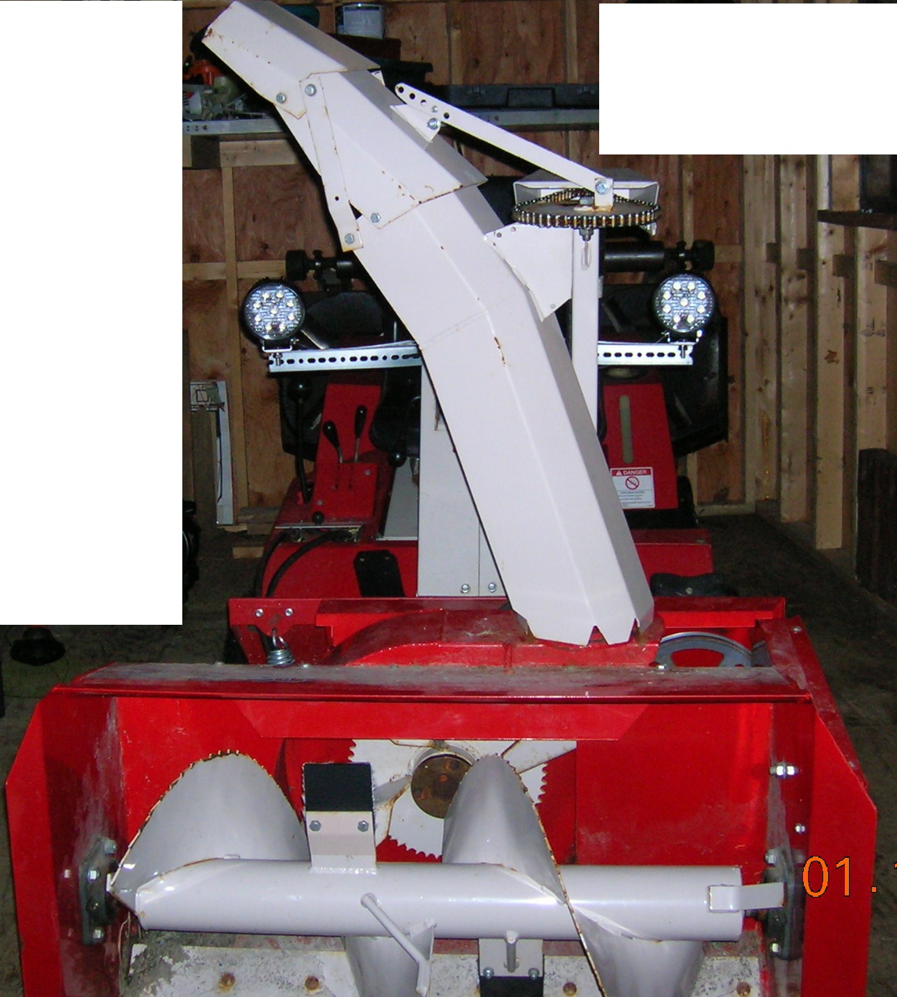

I got my lights yesterday and they are mounted! One was bent in shipping but ledstores gave me $10 off to just keep it. It won't affect the function of the light but it definitely is noticeable if you're close. KUDOS to ledstores! Good communication and great to work with! If you need LED work lights I highly recommend them as a seller! Not the prettiest mounting job but it was easy and it WORKS!

dnrsslr. Does your Ventrac have ROPS? If so, I think you are going to find that they are a better place to mount them. Getting light up high will get you a better close field view. In your setup you will find that the equipment in front tends to create a shadow, and with all the lumens you got coming off the front, the contrast will be pretty high.
Just a suggestion, I wouldn't take them off the bar, just tape / strap / bolt your bar to your ROPS.

Thanks for your thoughts and advice. No, I don't have ROPS and yes, I wanted to mount them higher. But, I couldn't justify buying ROPS to mount my lights. lol I keep thinking maybe I could build some sort of "frame" to mount the lights higher but just can't figure out how to do it. I guess I'll see how this works in action then decide if I need to do something different.
dnrsslr,
Just a thought... since you don't have a ROPS, maybe you have more of the angle material you used for the cross piece?
Just add some pieces to the ends at a angles to make them higher. (please see and excuse my crude modification of your photo)
Like you said.. won't be pretty, but it will get them higher and wider if necessary.
If you could find some nice square tubing it would make a better job.
Also not raggin'... just suggesting... at the very least, put some tape over the switch connections and the wire nut. Maybe it's not the final wiring?
Snow from a snow blower has a tendency to blow everywhere except where you want it. :D

I like your idea with using the angle material to go higher and wider. Too bad it's not as easy to do as it is to draw! But, I think it could be done fairly easily! You mentioned square tubing; would you do it all with the tubing? Are you suggesting it would then be welded rather than bolted together. I'm not sure how to connect the pieces and angles if I use tubing.
Yes, tape over the connections would be good. I was trying to do it fast because I had somewhere else I was supposed to be. But, when the lights arrived, I couldn't just let them sit in the box now could I?!!!! About the wiring; I'm actually thinking it might be better to just wrap the wiring around the screws on the switch rather than crimp them into the spade connectors like I did. Any thoughts on that? I also need a wire clip "thingy" to hold the wire against the tractor. I will probably use the bolt under the word "Drive".
