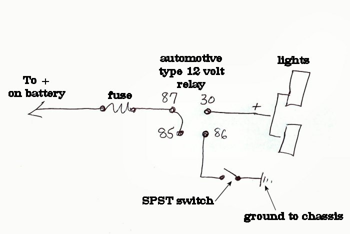

PineRidge, I appreciate your offer. Might have to take you up on that. I have thought about using a relay, but wasn't to sure of how to set it all up.
Sorry I didn't get back to you sooner.
If you have any questions just ask.

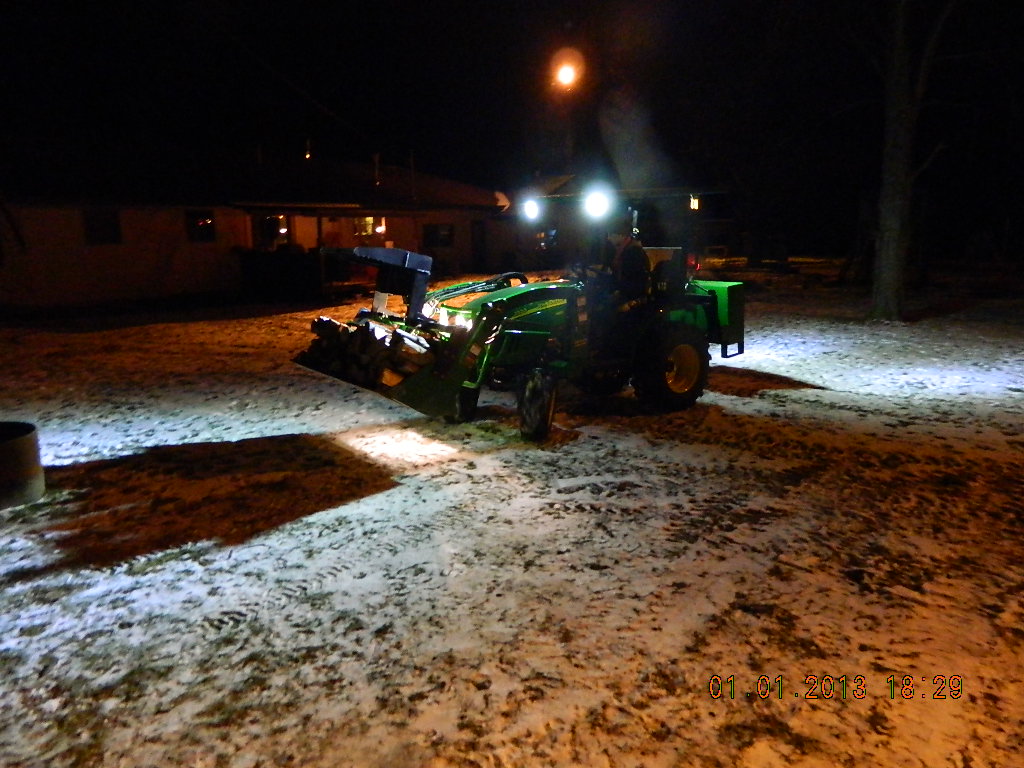

I must say they work very nice. iI have only used them in temperatures from 80F down to 42F so far.
The housing for the light is made of a cast aluminum with heat disapating fins on the back.
Nice stainless steel bolts and brackets.

The big problem with LED lighting in the winter usually involves lights on the rear of tractor trailers [ brake, tail, marker ], where they get packed with snow in the back draft of the trailer. They also suck in some traffic lights and can get covered in snow under certain wind conditions. But these flood type LED lamps get warm enough so that tractor lighting does not seem to have a problem..even when snow blowing. Several folks have mentioned that they do not attract skeeters/moths/etc. at night, too.. :)

Heck yes they are working great!
I have 18 Watt for the rear and 27 Watt for the front.
I used them quite a bit for leaf pickup and mowing after dark in the fall. Lately hauling wood after dinner and a little snow plowing.
very happy with them.

I see some discussion about using a relay for lights. Why would you use a relay and not just a switch in the hot leg of the wire going to the lights?
   / New LED lighting for half the price #20
Switching the hot leg is far easier, so long as current doesn't exceed capacity of switch. A couple of traditional lights can easily exceed switch specs. LED is less likely so.
