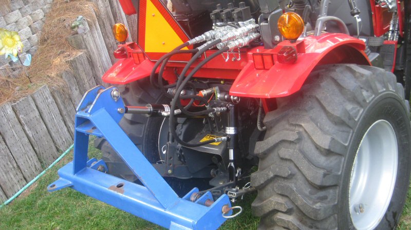

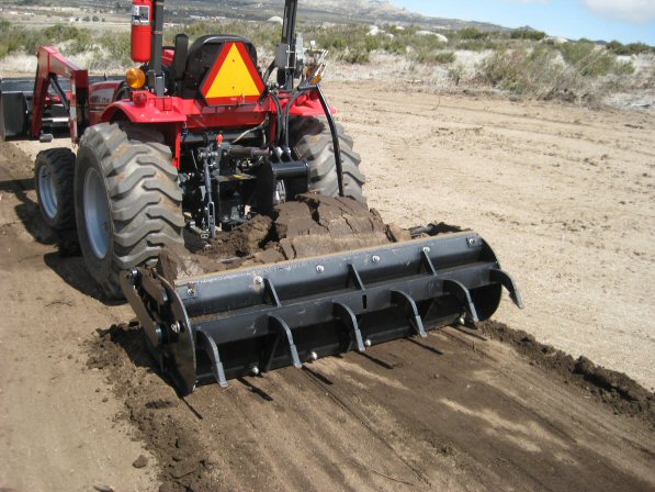

Catherine, I will give you advice on things that I know about. Top and tilt is mainly used for grading purposes. Most commonly with a box blade. (see pictures) Would run $650 for your tractor.

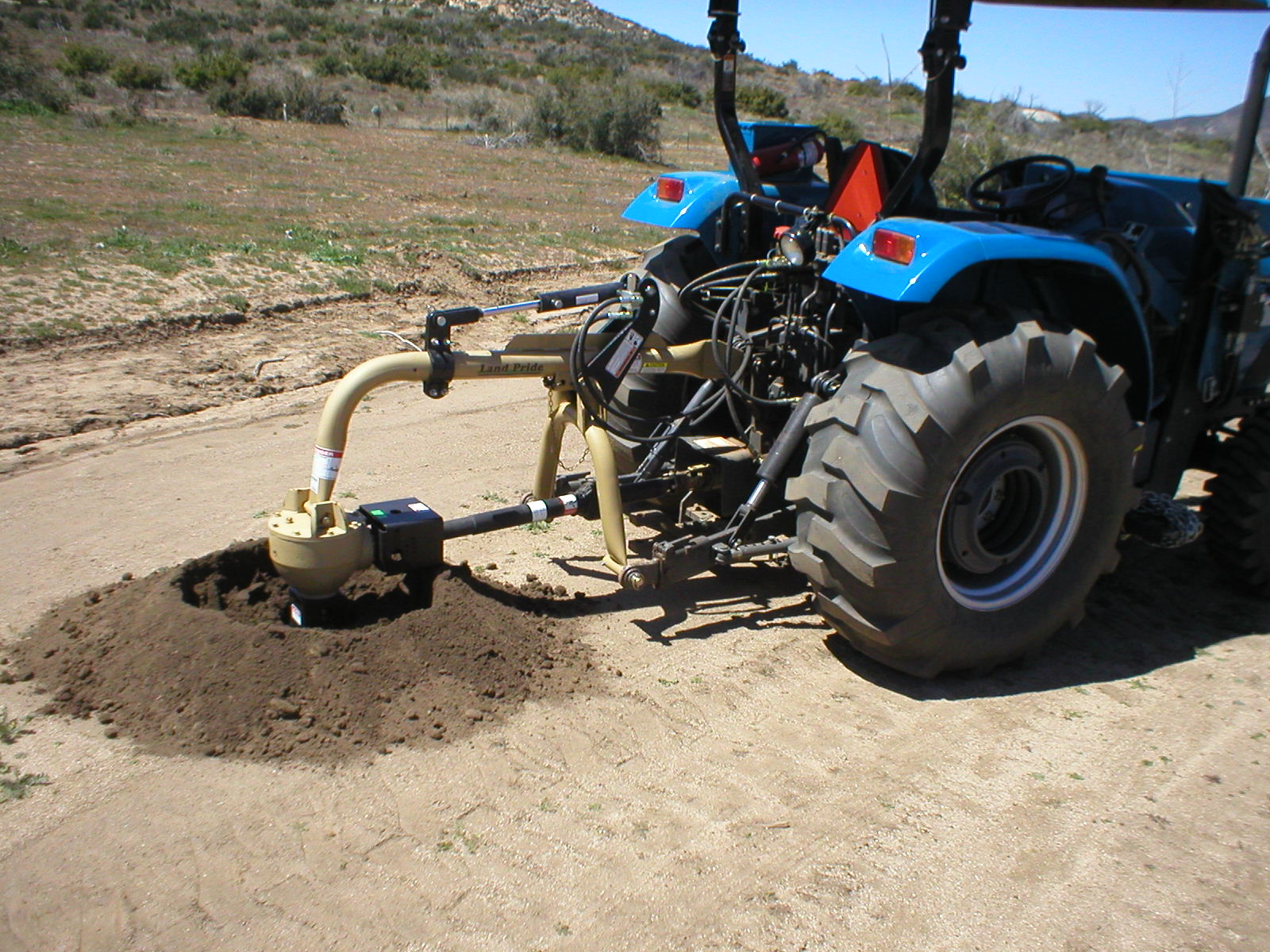

A PD25 is more than adequate for your tractor and I believe less money than the HD25. But depending on your ground conditions and your experience, you may be best of with the HD25 unit. If you have a lot of roots, is where I would think that the HD unit would be most useful. (able to reverse the auger to get it unstuck):cool: Another part of any 3pt post hole auger that most people don't think about is a hydraulic down pressure kit. This can be used with either unit and can be a HUGE HUGE time saver. The down pressure kit on my PD35 has literally saved me days of time spent drilling holes. :cool2:
