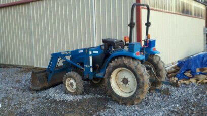

So, some of you will know, but a bit of background is in order. I bought an adjacent 9.7 acres that was solid woods and scrub last August I think. I drove the trackavator around a bit in there cleaning things up so I could at least walk (well, drive) through and made some burn piles etc.

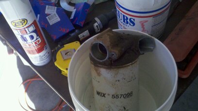

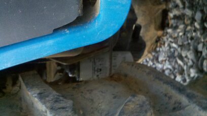

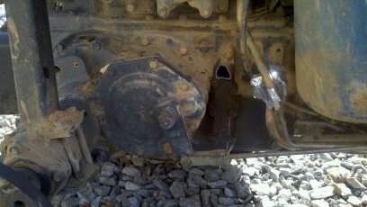

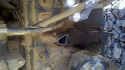

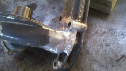

So, as you see when large stick comes up and wedges between Transmission filter body and transmission, cast aluminum filter housing looses the war........... First I thought I had broken the actual transmission case, :barf: but after calming down, realized it was a bolt on casting. :ashamed: So a quick look in the book for part #s and a bit of internet trolling to Messicks determined it to be a $130 or so mistake.:thumbsup: Don't like making those, but they are a whole lot easier to live with then $1000 plus change transmission casting mistakes.

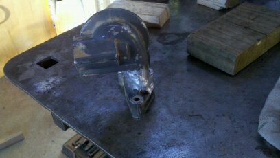

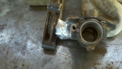

So, upon even closer examination, I realized it was a pretty decent looking aluminum casting, so hey, what the heck, I talk with a guy that welds every morning while shaving, so figured, to give it a shot.
So, pictures, would be, a hydraulic filter where it should not be (on the bench) and a hole where it should be, then a bit of welding, and now it is good as new (well close enough) maybe even much much better then new, as rod is cheap once you have the application device.:laughing:
