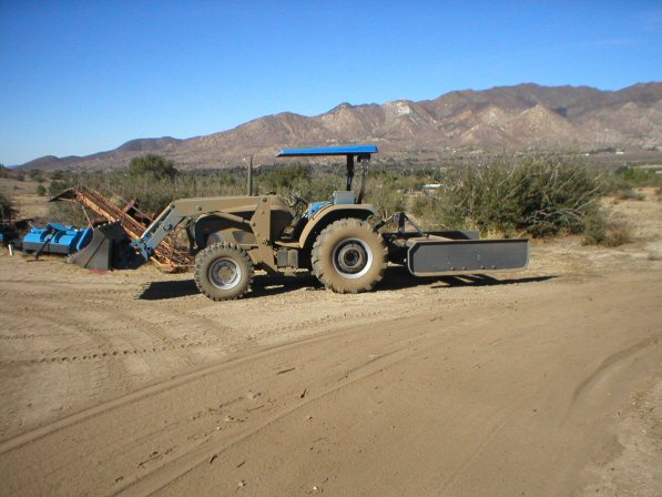

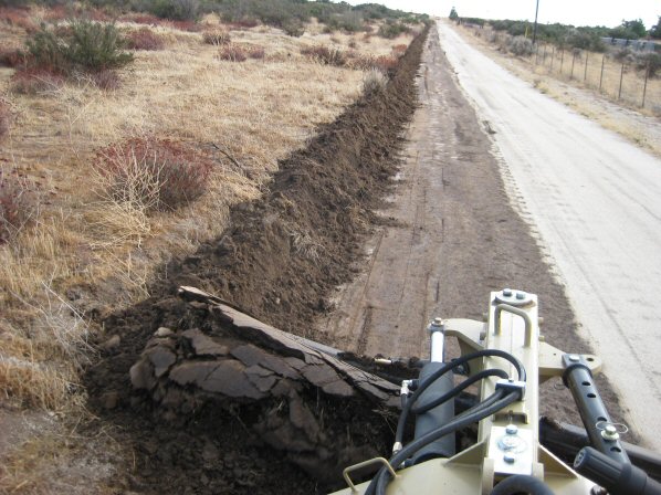

This is the exact misconception that most people have regarding the use of draft control. I can make a cut a mile long, 3" deep with my rear blade and never touch the top & tilt. Draft control picks the blade up maybe 1/16" to lessen the load and then will drop back down allowing me to continue along and never even be concerned. :thumbsup::thumbsup:
First picture is a taper cut about 6' wide from 3"-0" and the second picture is about a 1" cut through varying ground density. Look at the windrow, a constant amount of material being cut and moved. :thumbsup:

MtnView---that is a beautiful job.

Thanks. People think that I know what I'm doing, and maybe I do some what, but knowing how to operate the features on the machine you are operating sure makes life easier. ;)
