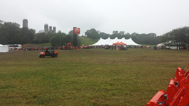

Sneak peek of the dealer meeting field demo grounds. I'll be posting more photos when I return.
