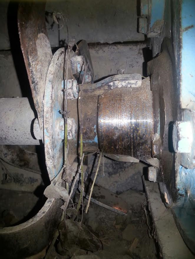

One thing I did notice that the KK did not have in comparison to the maletti tiller was what I call "trash guards" that extend over the output bearing housing from the tine flange. Just two pieces of about 3/4 inch wide buy 1/2 thick strap is all they are... They very effectively keep twine, vines and other things from wrapping around the shaft then into the seal that ruins the seal causing gear box oil to leak.... I will be welding "trash guards" to the tine flange on new KK:thumbsup:
