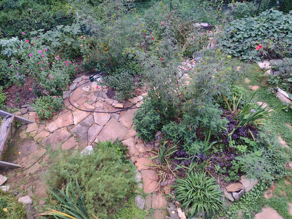

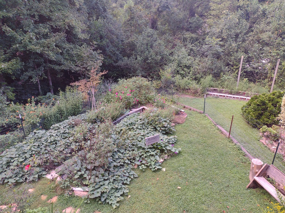

What I would recommend, run the sub-soiler then spread lime / fertilizer based on a soil test, then get from the City of Raleigh, Organic Compost ($30/yard; best to pickup with a 5x10 trailer but pickup trucks work) and spread that out to hold moisture, THEN till the area to mix the top layers.
I would not do deep tillage, you gain nothing by chopping up red clay. Add organic matter. I use leaf mulch from the city, 4 yards at a time, twice a year. That's just maintenance for our flower and garden beds.
Our back yard was a gravel driveway with red clay under it... Looks better now, that is sweet potato growing all over the place...
