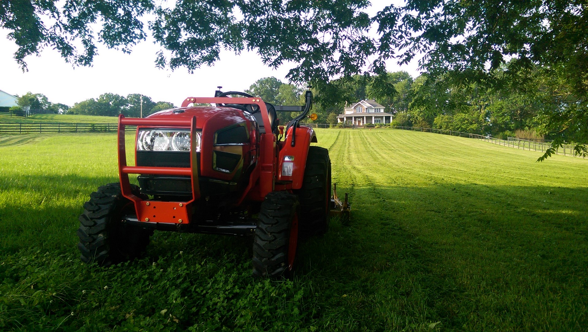

ROPS mounted LED lights is something I intend to add. Can I ask which ones you are using? Did you add them yourself or have them dealer installed?
Did them myself. I actually have 3, 2 on the ROPS forward, 1 rear facing next to the SMV and toolbox. I got fancy and wired all 3 with a switch on the dash, you could easily do a switch on the back by the toolbox.
Amazon.com: SHANREN LED Work Light Lamp Off Road High Power ATV Jeep 4x4 Tractor 27w 60 Degree Flood Light: Automotive
Those are the lights I used, work great, nice illumination, no issues through high heat and heavy snow and rain. To put one in the predrilled hole on the back of the tractor, I've had to flip the SMV and move the toolbox over an inch. I mounted the lights under the ROPS with U-bolts. All three are wired into the accessary circuit wires that come out of the big bundle that runs right under the SMV. lights, wire, switch, connectors, bolts etc, cost me about $100, well worth it IMO, and cheaper than any kit out there. No blown fuses either:thumbsup: Let me know if you want more details. Sorry, no pics right now.

Wow thanks for the awesome overview of the light system you set up. I may reach out to you for more detail when I finally get to this project. Right now it's staying light out pretty late so not bugging me enough just yet.
