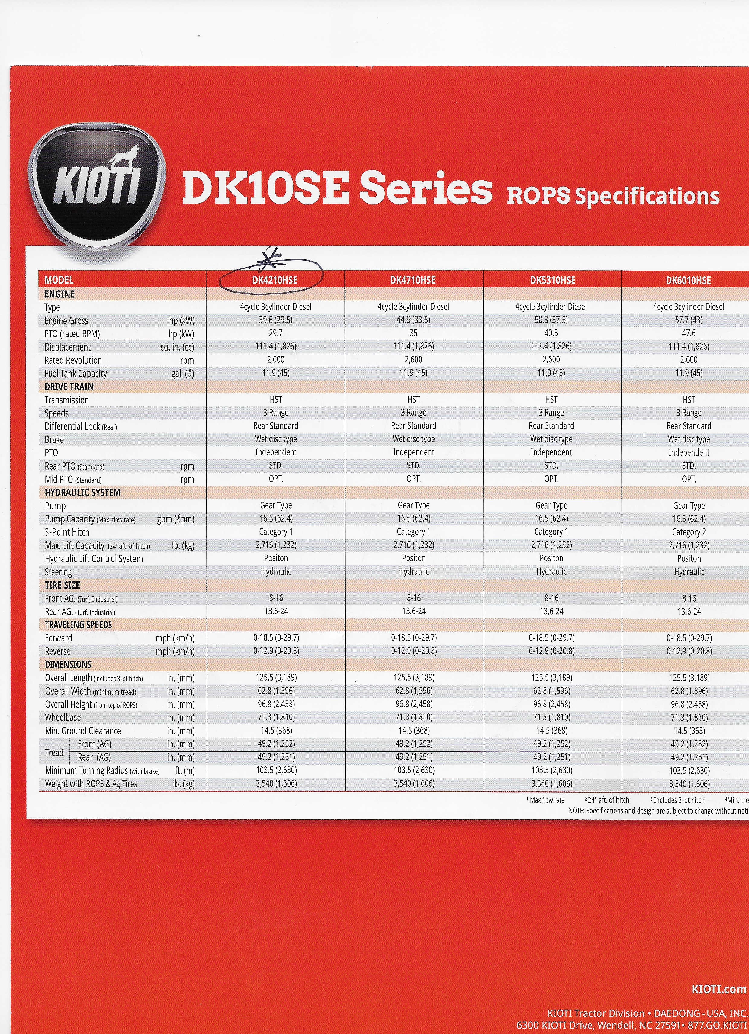

Anyone get any info or specs on the new kioti models? Dk4210 hst? Got a price from the dealer but nothing else. Weight, lift capacity, pro hp, etc.?
/ New kioti models #2
I have been considering the DK4210HSE Cab due to the frame/loader size and rear tire width. See attached spec sheet. The CK4010HSE Cab looks like a really nice machine, but it is definitely top heavy and the narrow stance concerns me.
/ New kioti models
Thanks for that. I've been waiting to see specs. Now the decision is the 4210 for $23.8 or the nx4510 for 25.8. Hmm. Also looking at the tym 454 for $24k
/ New kioti models #4
The only reservation I have about the DK4210 is the low PTO HP. If PTO HP is important to you, I would certainly consider the NX45 or TYM454 over the DK. I was kind of disappointed when I saw the 29.7 pto HP on the DK.
Also, the DK42 has the EXACT same motor as the much smaller CK35 & 40.
/ New kioti models
Yes I was also surprised at the PTO hp. I will be using a 6 foot brush hog to cut about 25 hilly acres a few times a year. The extra weight and a few more PTO hp I think makes my decision. So it's down to the NX or the tym. Both dealers same distance and both have been great to deal with. $1800 difference worth it for the kioti is the question.
