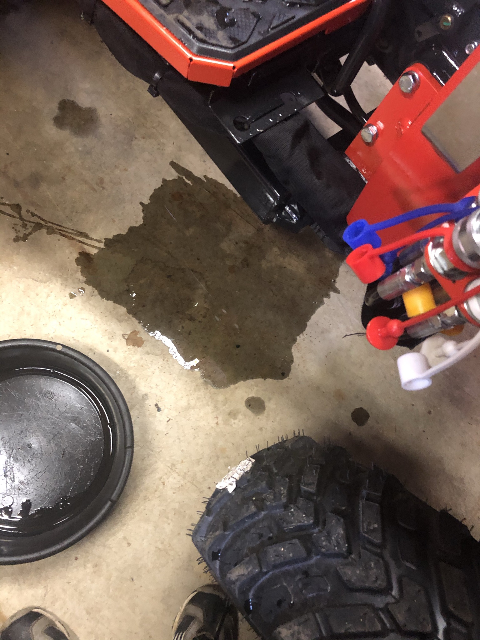

I took delivery of my new CK3510 yesterday afternoon. It was pouring rain so it came off the delivery trailer and went directly in the garage. Came out this morning and this is what I find on the floor. A pool of oil. Looks like hydraulic oil. I opened the hood and the back of the engine looks as if the engine is cover in oil spray. Needless to say I am pissed. Dealer is closed today. I was so looking forward to my new tractor, now I think this tractor is a joke!

Probably just a fitting that didn't get tighten properly. No big deal considering how many fittings a tractor has.
Just try to locate exactly where it's coming from and see if you can fix it, otherwise just wait till the dealer can have a look at it.

Understandable that something may be left loose, but quality control is something to be desired when a tractor that only has .7 of a hour on it is leaking oil. It looks like its hydraulic oil leaking from the smaller line on the pump. It has a slight red colour to it as it drips off the line. It may be coming from back the line further. It does have a backhoe so maybe that connects in there somewhere and is running up the line. Everything is tight around the pump. The spray on all the engine looks to be preservative oil because it is all over the tractor. I’ve cleaned the floor up and now have a clean pan under it. I ran the tractor for a few minutes and then shut it down. I’ll see if I can track it better now that it’s cleaned up. I hope maybe they just overfilled it when they installed the valves for the backhoe.

I’ve narrowed it down to the hoses that come back from the loader to the rear of the machine. Its after the quick disconnects but before they go into the hydraulic unit. The fluid is coming out through protective sleeve so it must be a bad hose. There isn’t anything else that it can be coming from.

The leaking hydraulic oil will be a super simple fix or a tractor replacement if it is a seal that requires splitting the tractor. Not the best time for a tractor to be down. I understand the frustration but nothing man made is close to being perfect.
