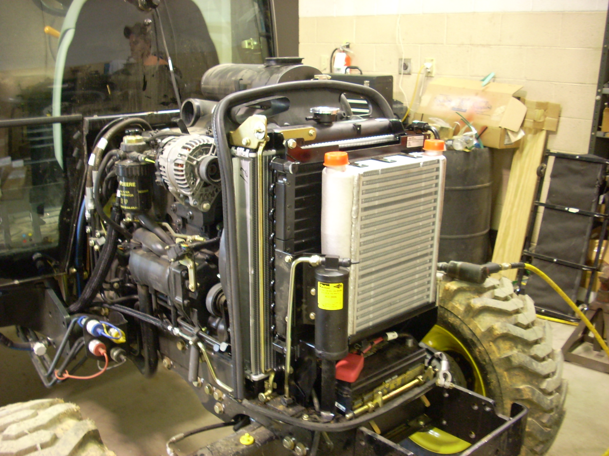

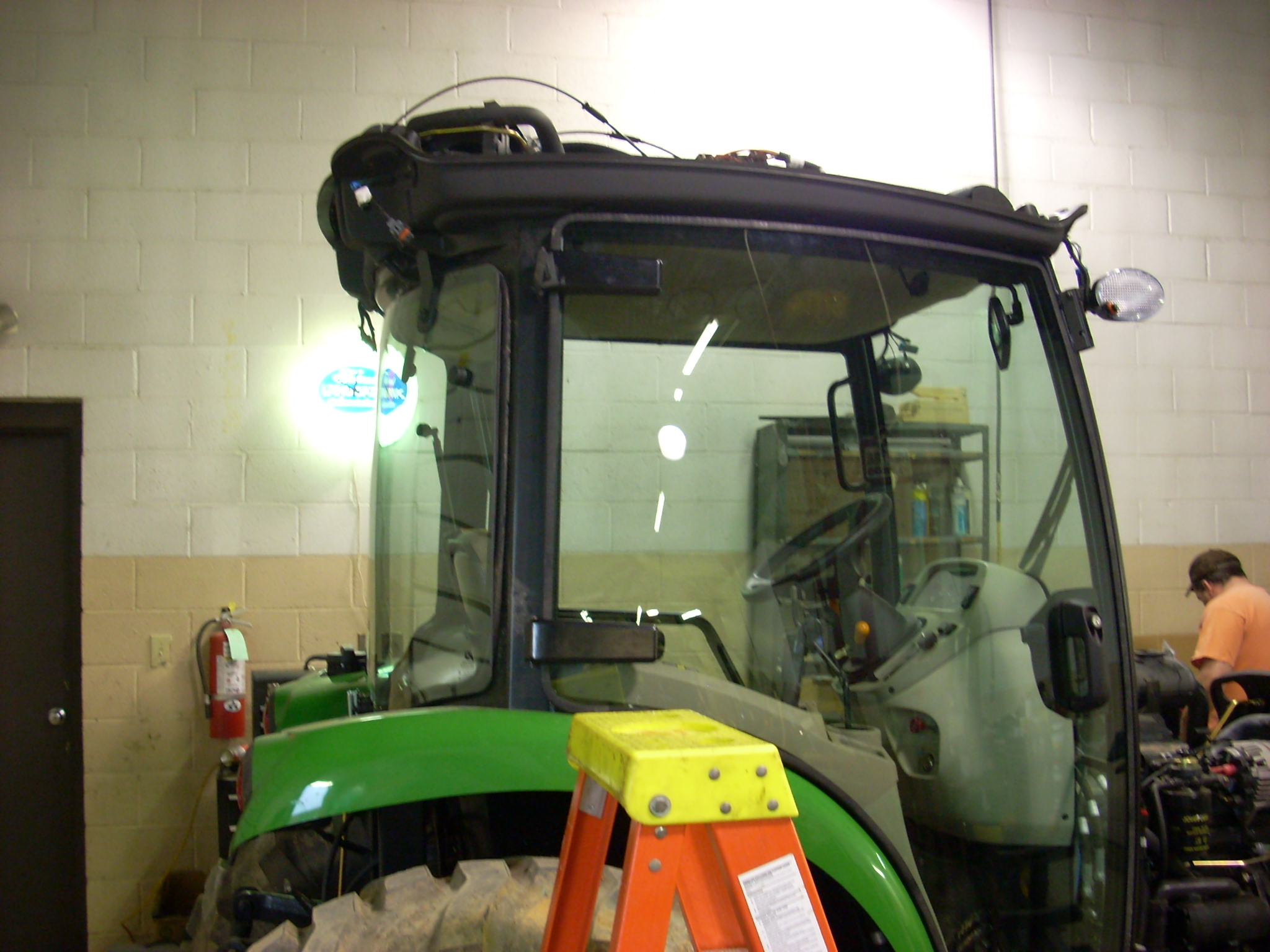

Deere dealer emailed me these pix of the work in progress. They had to re-order some parts due to a serial number break they missed, that's OK. It's nice they are keeping me informed and sending pictures.
No word from State Farm yet on anything, will contact them this week. Mid week is two weeks since the adjuster was here, and a week longer than what they said it would be to get back to me with an update. I'm glad I didn't hold up repairs waiting to hear from them.
As for the conversation piece, we'll see what debris is left. I did have them keep the hood so I can cut the remaining good side with the decal out. I should get the front headlight piece (less headlights) back, don't know if they will re-use the Deere emblem or not. It's just nice that that such thought can even be pondered at this time.
Pete

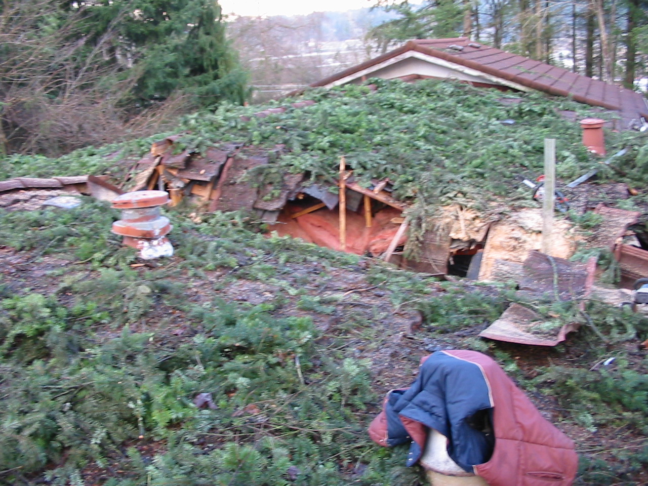

It is important to take care of damaged trees! This one had root-rot which wasn't visable until after it came down.
