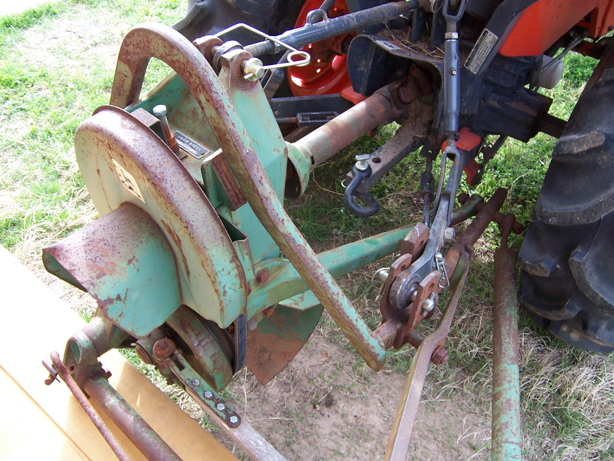

I just SCORED a good JD#39 sickle mower. Got it mounted to the tractor (yup, B2410) and it works! I can lift and carry the mower ok, it's not unstable or tippy at all but in transport position the front end is a little light, but no worse than with the tiller :)
Can anyone help me? He didn't have the OM for the unit and neither does the local JD dealer, although they would gladly order it for me for about $40 :(
I understand the general operation and lubrication points but am having difficulty understanding how the lift (drawbar) system is SUPPOSED to be set-up.
As it sits right now, there are two large cast plates attached the to mower arms with u-bolts, big ones. When I raise the mower these contact the bottom of the drawbar arms causing the upper "hoop" on the mower to pivot forward.
It appears that this is supposed to add pressure to the sickle lift-arm spring making it easier to raise the bar for transport. What I don't know is exactly what it is SUPPOSED to look like when correctly installed.
Photos would be a godsend.
Thanks friends!

Those are part of your stabilizing system on the 9 and 39 mowers. You must have a U-bolt to run through the 2 holes in the upright cast pieces and attach both of them to the lift arms of the tractor. This will keep the mower from swaying left to right. Ken Sweet
/ New JD#39!
Thanks Ken! That makes a lot of sense, I did not get the coorisponding iron pieces for the lower links but if I turn those I have around 180* so they fit on the outside of the lower links that should do the job. I found half a dozen decent photos on Google that show what it is supposed to look like when connected correctly.

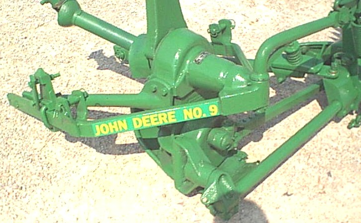

I have a #9 coming out of the shop tomorrow. I will try to post a pic. We could not find the U-bolts and made clamps out of flat stock. Ken Sweet

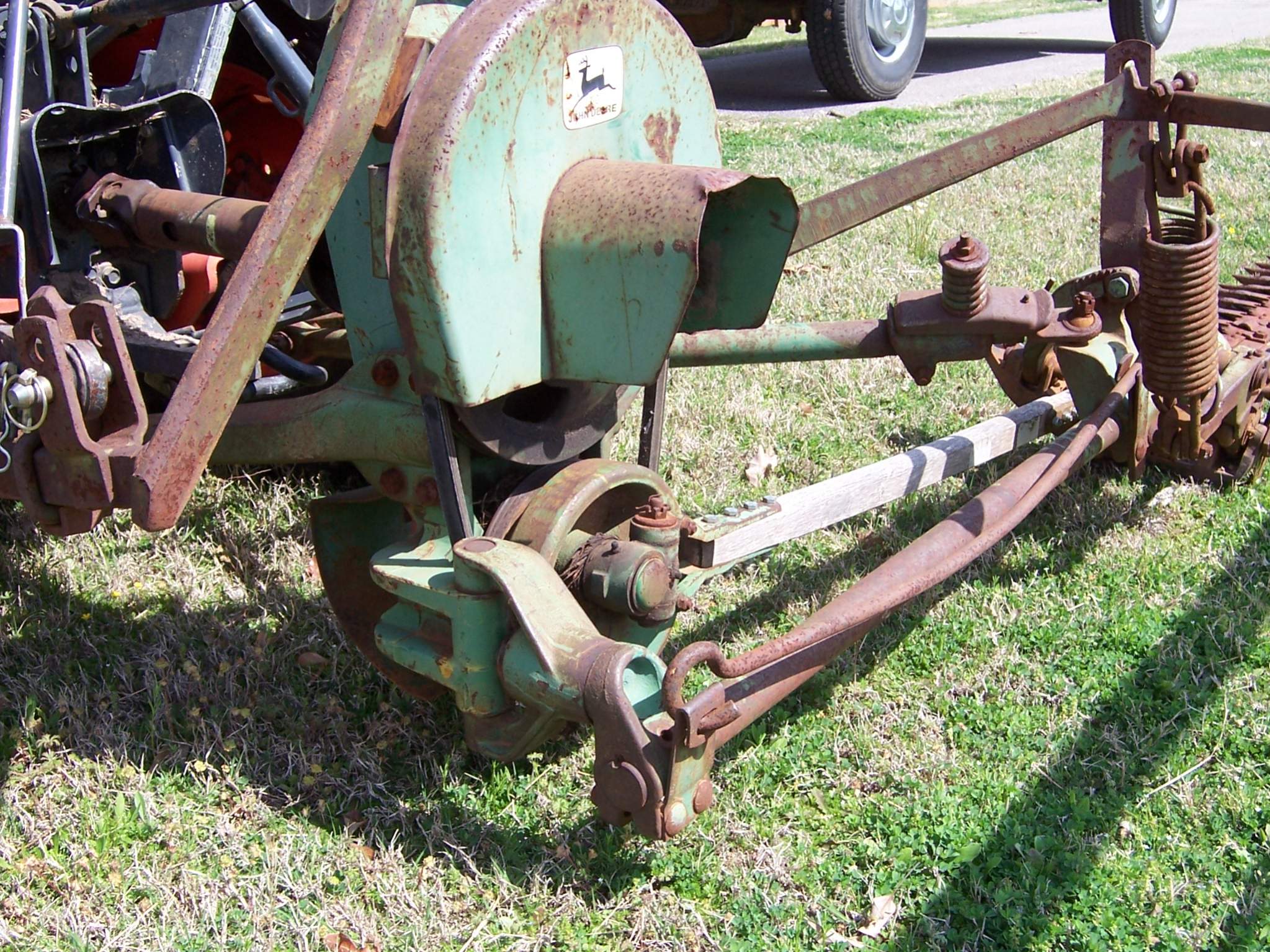

Well I *think* I have everything installed as well as possible. Brief testing proves it works, that is, cuts "hay".
I have to set the top link correctly then the angle of the cutter bar as it's pointed more than "slightly" upward now ;)

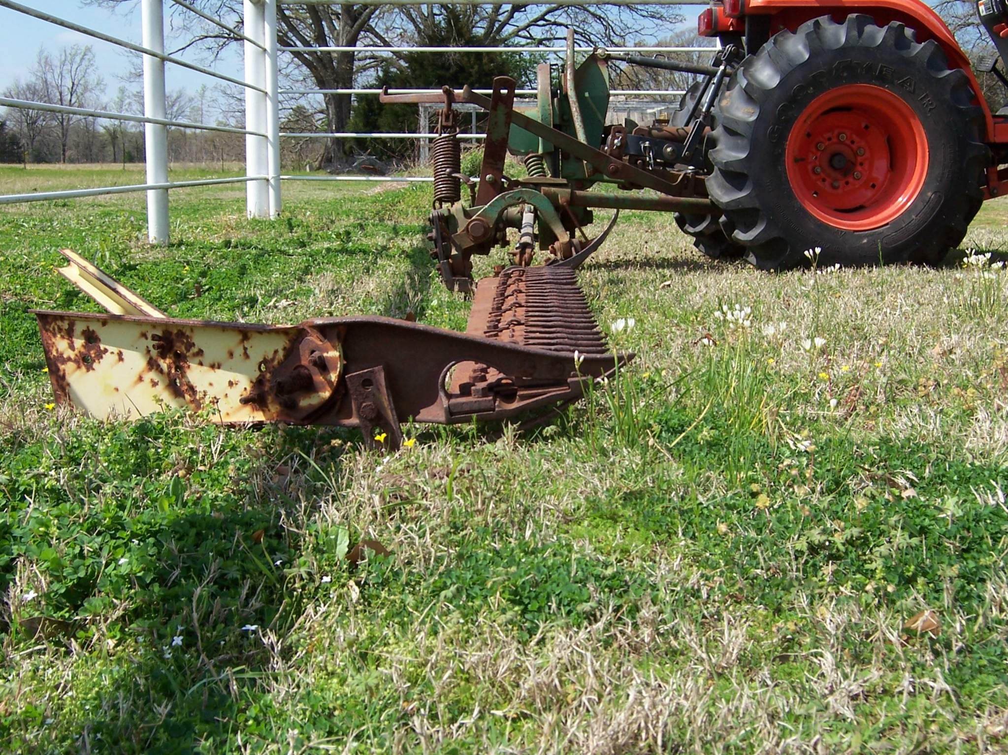

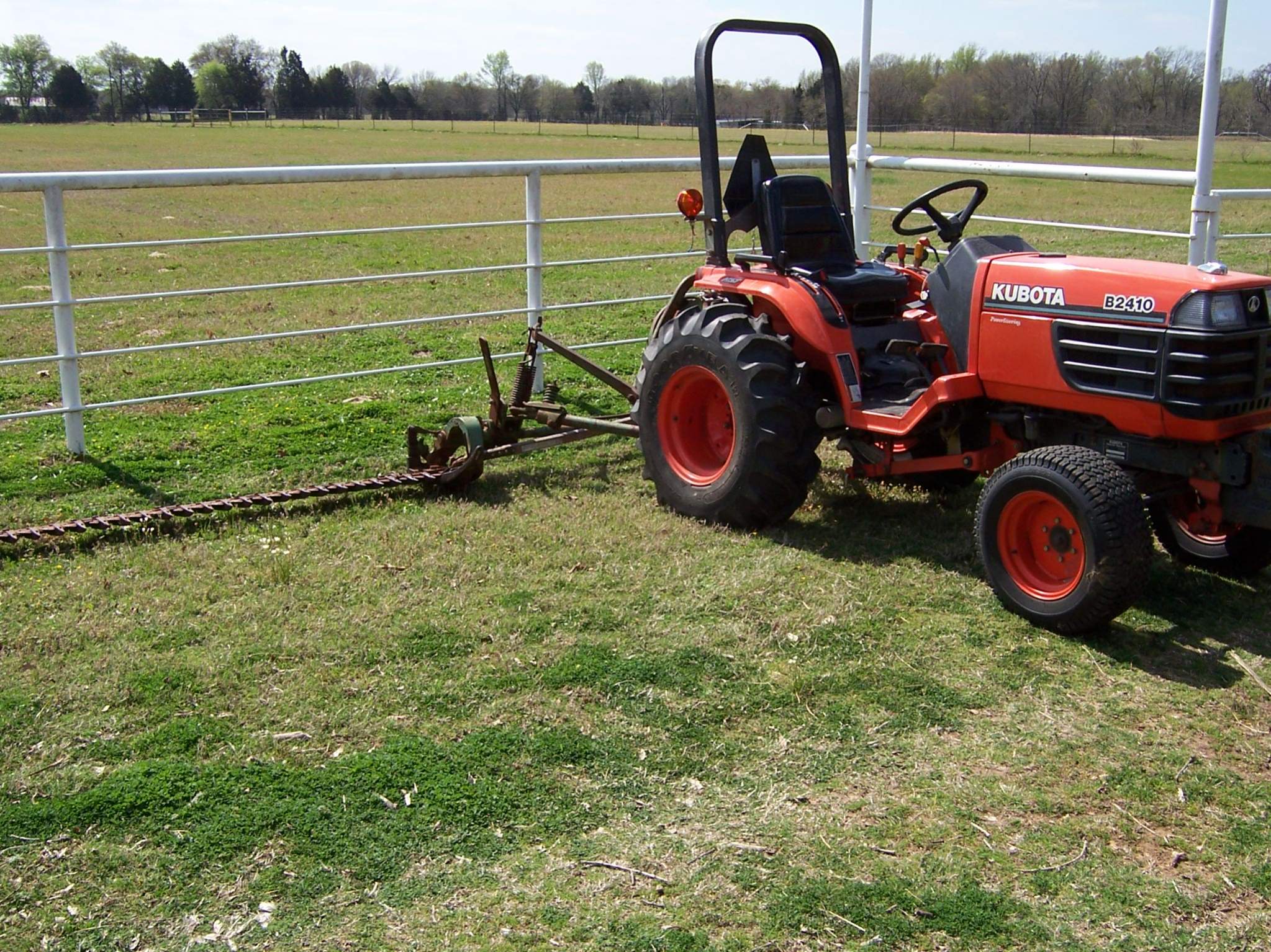

Here are some photos of the #39 on our B2410.

Here is a pic of a #9 with the same stabilizer clamps as a #39. We did not have the U clamps and made the clamps out of flat stock. Ken Sweet
