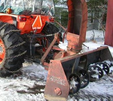

Here's a pic of my 516 - with single 84" auger. We use it on a 40 hp tractor that's enough power. But it would be a bit much for our 34 hp rig. 70995d1172369740-drag-blade-rear-mount-snowblower-snow-blower-manual-jpg.jpeg
   / New Idea 517 value #4
I think a 2-auger would be ok. We use a 516 (single auger) on a 40 hp tractor and there's enough power. I think I gave $250 for the blower. A 2-auger model would be a little heavier but would work fine. On a machine that has been unused for awhile, check there's oil in the gearbox. The fan on these can require a 20-ton pull to loosen from the shaft (ask me how I know:rolleyes:) The 516 got a drag blade and new paint added later. Still going great.
