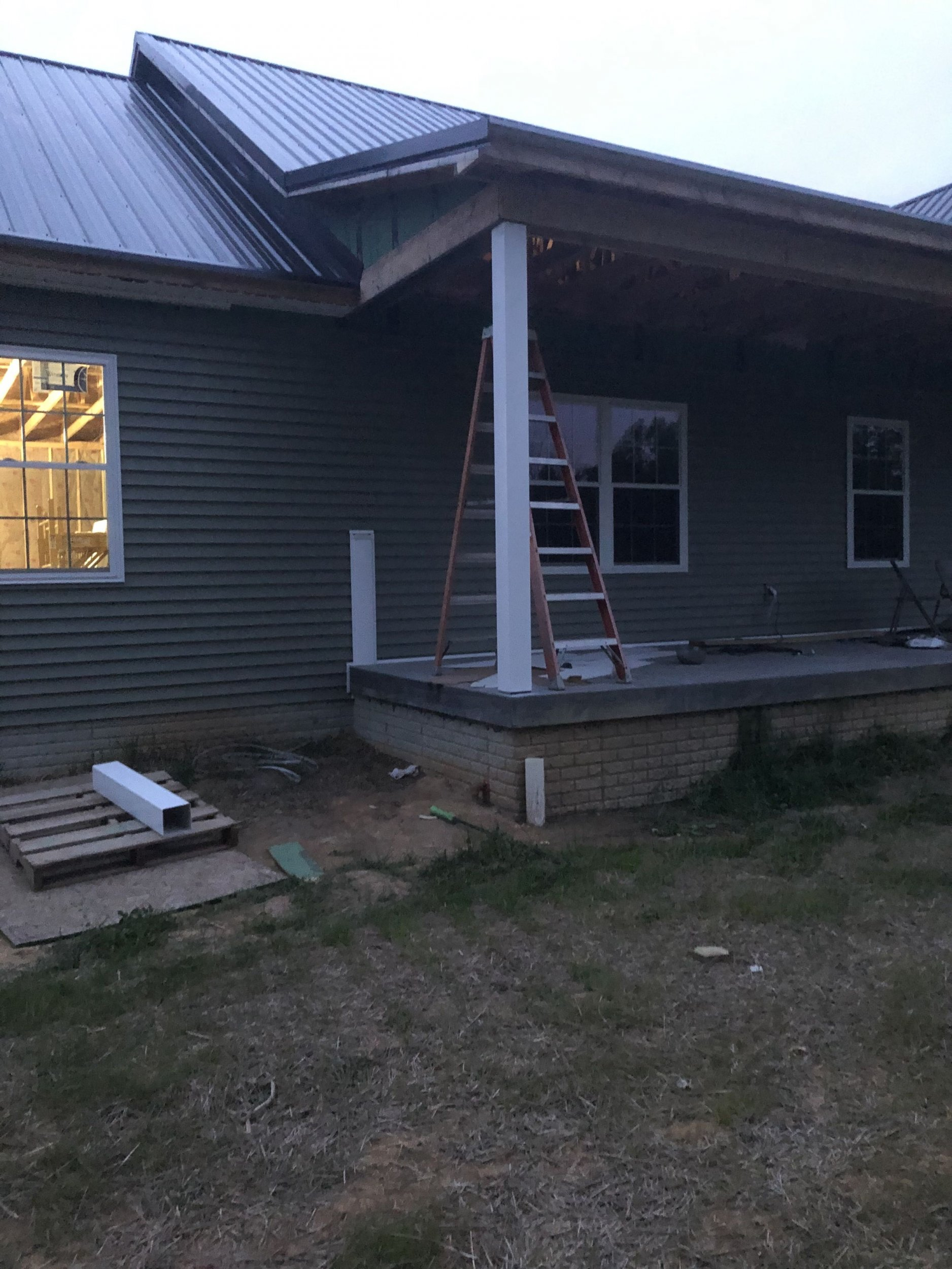

I did get everything in place to get the first front porch post up before going to the game. Hoping to get those up over the next week as well.

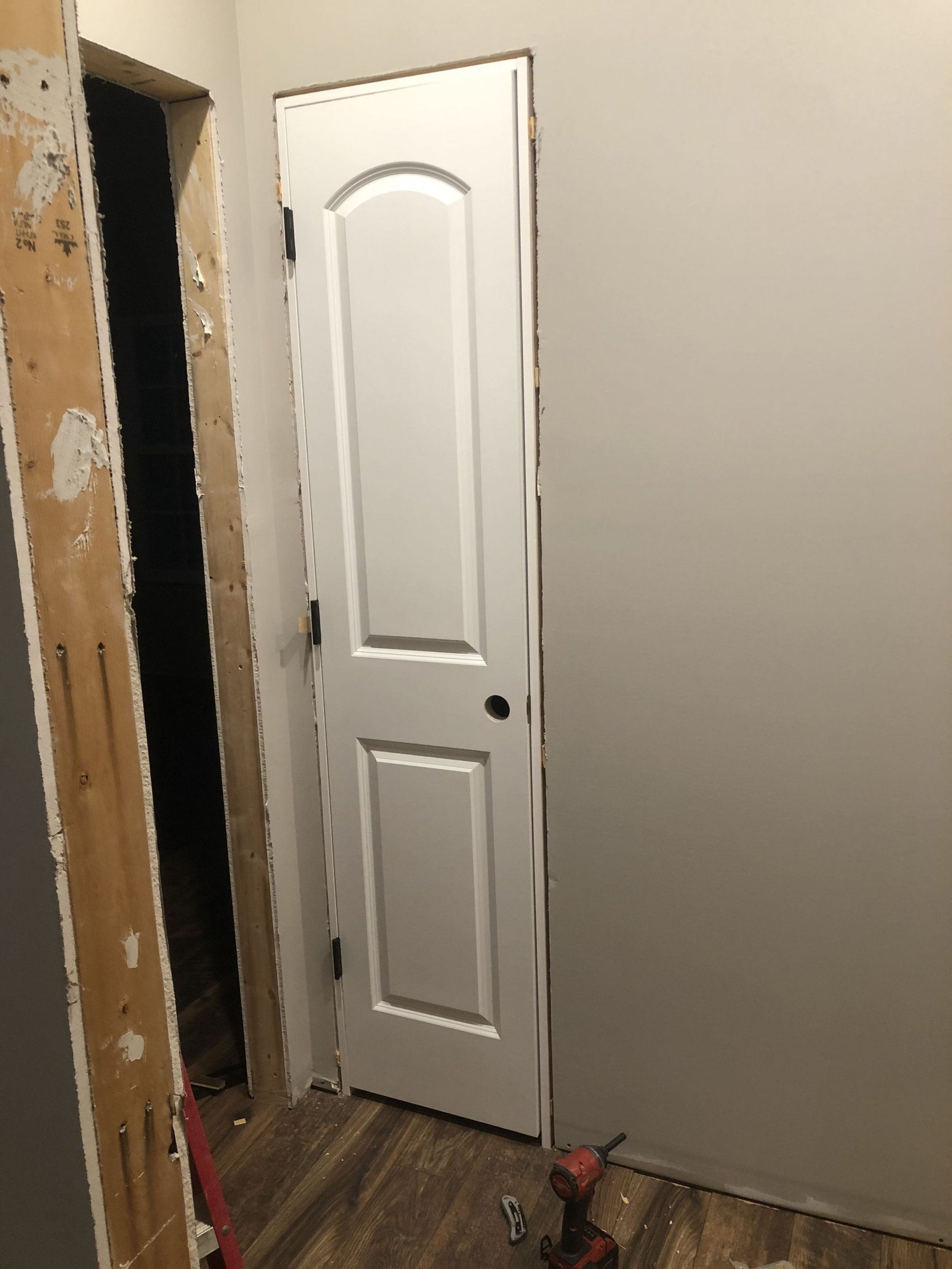

Managed to get one porch post up this evening.
After that, my wife and I installed the first door. Chose to start with a small out swing linen closet. Went pretty good, rest should go quicker. Will continue with doors tomorrow and hope to get them all up by the weekend.

How are you anchoring the post bottom?
   / New House Build in WV
#436
I am using Simpson metal U shaped brackets. I fast the bracket to the concrete and then stand the post up and screw the post to the bracket. I spread the 2x10’s up top apart enough to slide the vinyl cover up to fasten the post to the bracket then slide it back down. Seemed to work well on the first one.
   / New House Build in WV #437
Thanks. My turned posts have a base attached to the bottom and just sit on the porch, they are not made to be anchored. Never liked that, but has never been a problem., yet.

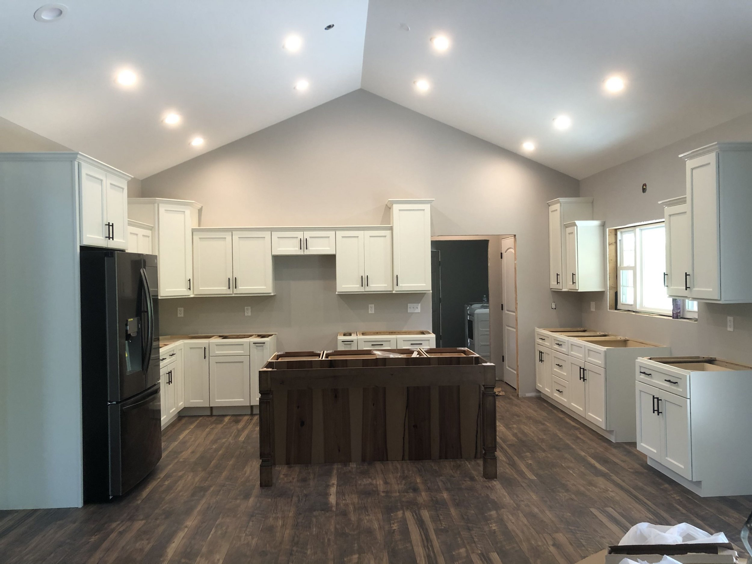

Kitchen cabinets were installed today. They were very efficient and did nice clean job. Very happy with how it turned out. They will be back next week to install the the counter top.
There is one cabinet without handles, it was wrong and will be replaced next week. It was supposed to be all drawers with one drawer being a cutlery drawer.
   / New House Build in WV #440
Why the different height wall cabinets? With my 8 ft ceiling all mine go to the ceiling.
