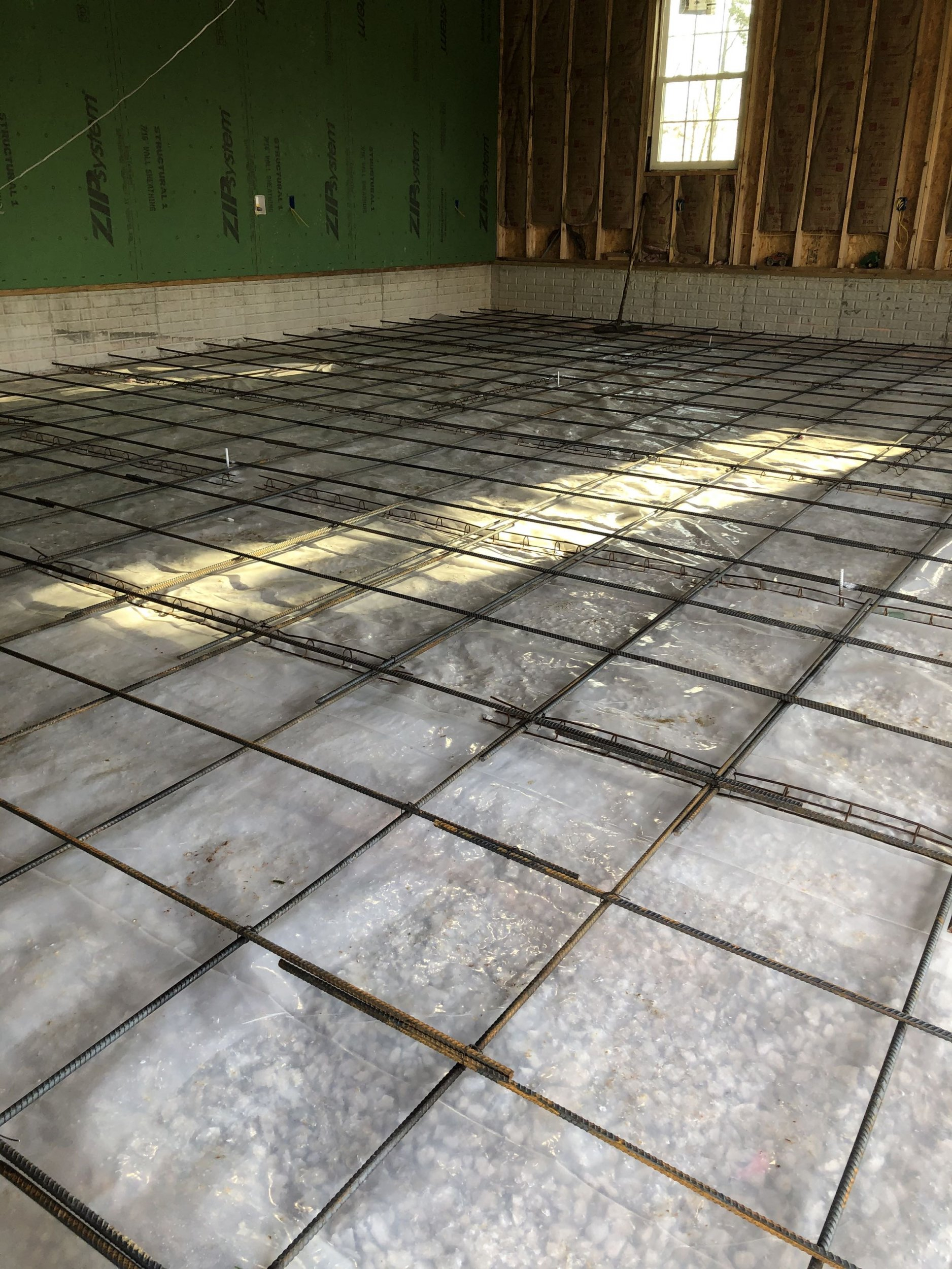

The garage will be heated, so the exposed pipe freezing should not be an issue. I could come up out of the concrete with pex, then put something around the pex to protect it. This would keep me from having a connection under the concrete.
Now that I think about it, maybe running pvc conduit under the concrete to run the pex in is the best solution.

Protection while pouring concrete, and the possibility of being able to pull in a new line in the future if there is ever a failure, is my thinking. I want the pex protected where exposed either way, and it wasn’t much more difficult to just put the entire run in conduit. It’s done now, and other than putting forms at the door openings and snapping lines around the foundation, I’m ready for concrete.

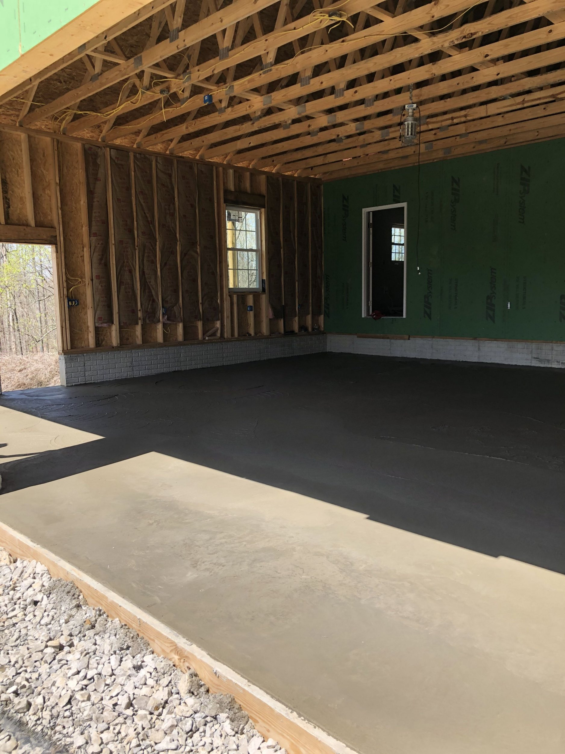

Concrete pour went great today. Ordered 18.5 yards and I doubt there was enough left to fill two 5 gallon buckets, just the way I like it. What a relief it is to have that done.

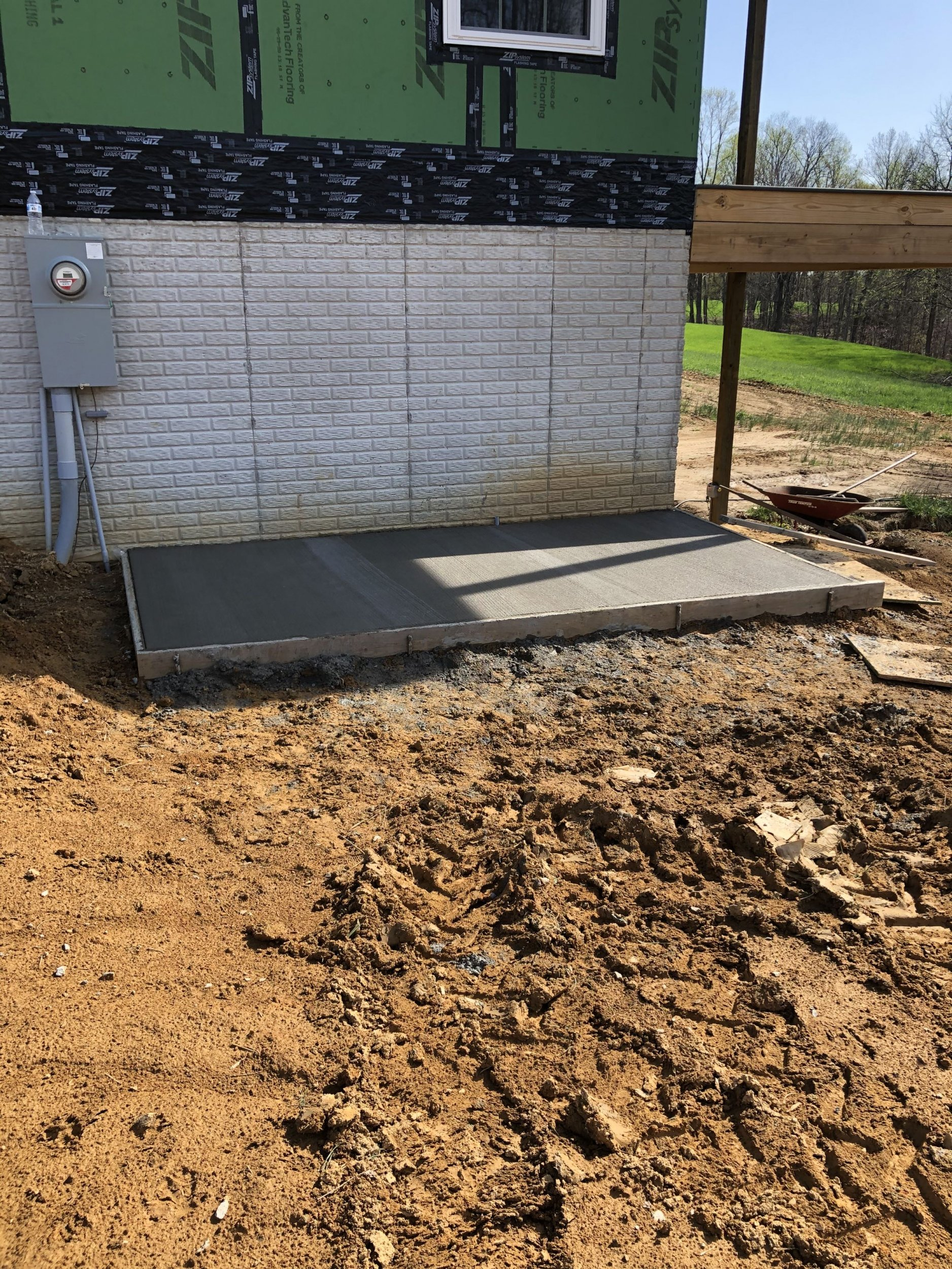

The slab on the outside, for trash cans or wire in a generator?
Air conditioner and generator will sit on it.
Couldn’t get the truck around there, so I had to carry the concrete in the tractor bucket.
