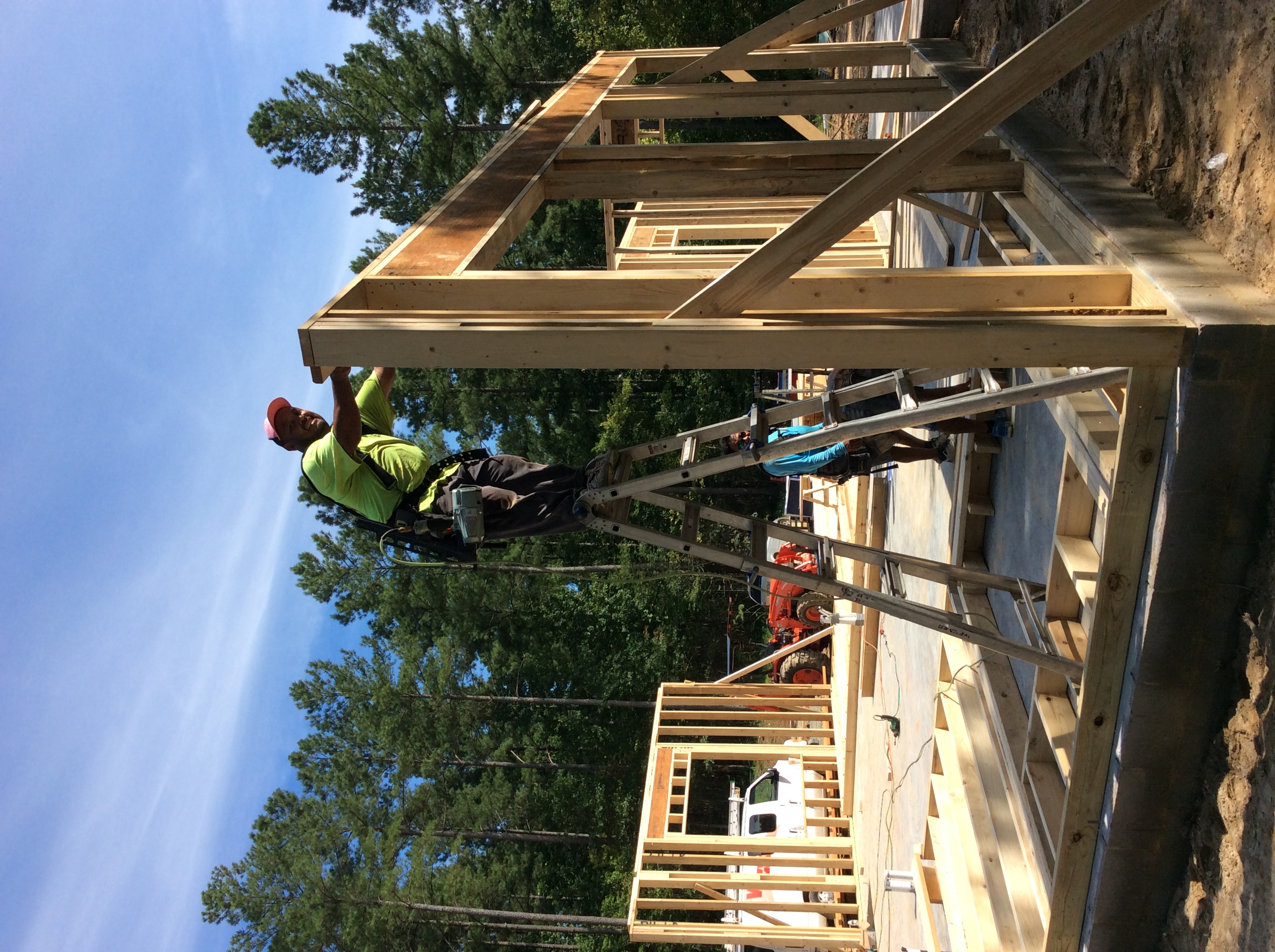

I try to do my best at being safe, but often find myself on top of an 8’ latter. When installing the floor joists, my wife thought I was crazy when I took off walking the 10’ tall poured wall. I try not to do that stuff too often but, sometimes it just happens.

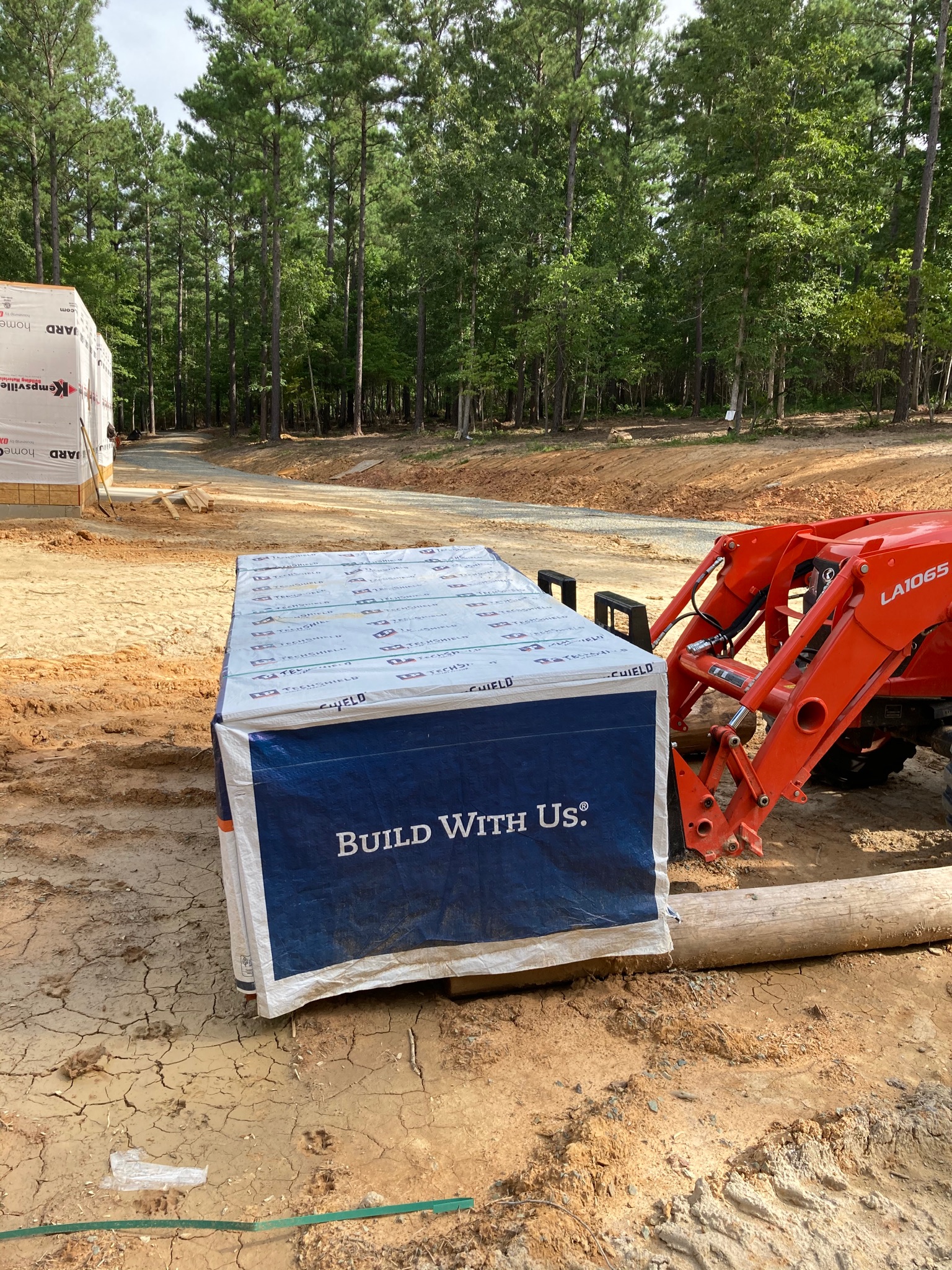

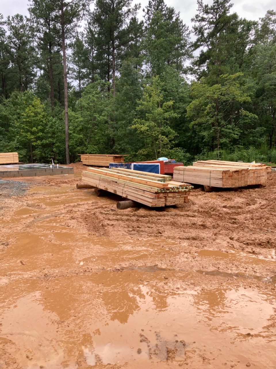

Today was a crazy day. Trusses were not scheduled until end of the week. Got a call while at work from the driver saying he was an hour and a half out from delivering them. Took off for home, 45 minute drive. I had a couple piles of rock in the way of where I wanted them, so jumped on the tractor and started moving it. Of course, it was raining and came a torrential down pour not long after I started. I just kept going and by the time I was done, every inch of me and the tractor was drenched. On the bright side, tractor got a well needed bath.
Tractor trailer hauling trusses could not get where I wanted, it just spun on the wet ground. I hooked my tractor up and pulled it in.
Talked with the crane guy and apparently I didn’t get them where they needed to be, so now I have to move them. Will call and rent a sky track fork lift for the weekend. While I have it, may go ahead and set the garage trusses. Sky track should reach those and maybe a few on the house, without issue. That will make things easier the following Saturday when the crane is here, if it works out. All depends on time and available help.

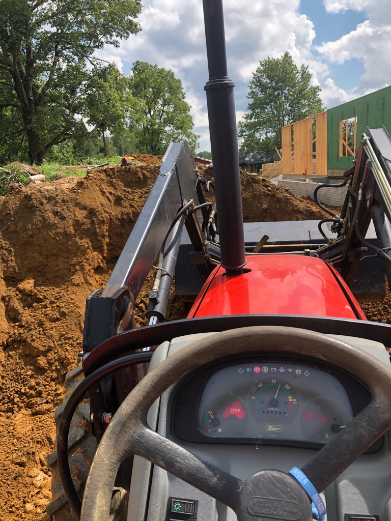

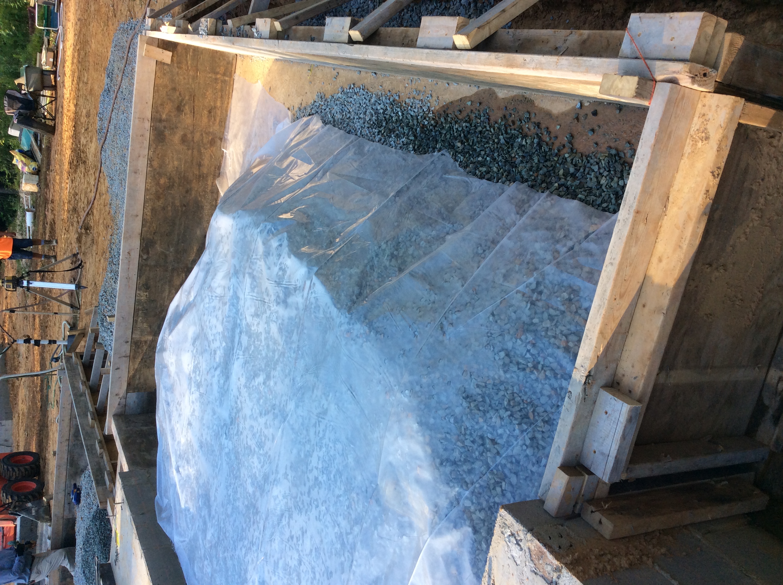

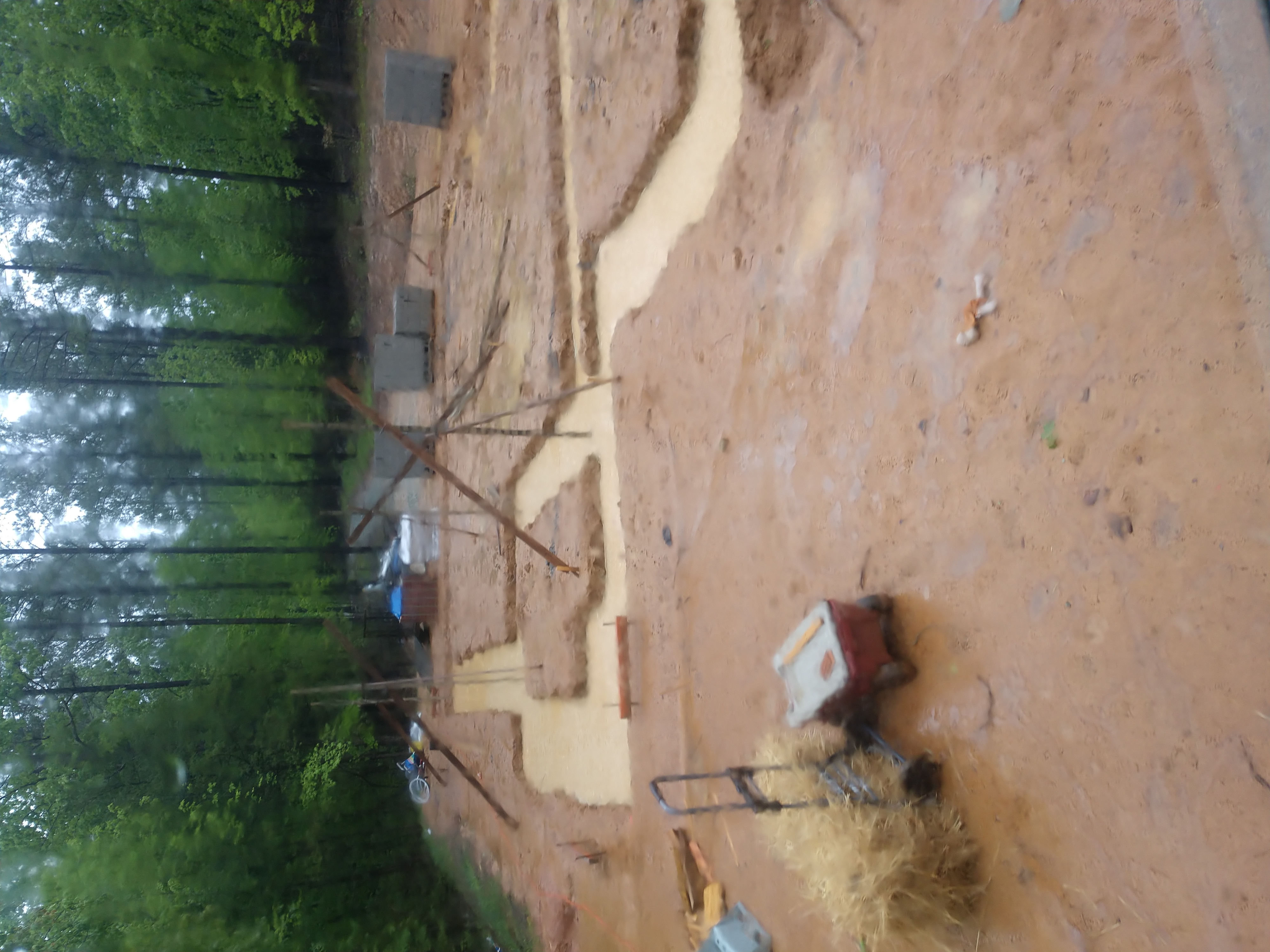

Definitely a stressful day. Today was better. Got lots of tractor therapy moving 25 tons of crushed concrete fill into the garage, moved about 20 times of river rock to just about finish my drains, and moved a lot of dirt out front. Nice to start seeing what the front yard and grade will look like.
I also secured a 10k sky track telehandler that will be delivered Friday afternoon and spend the weekend here. With any luck, I’ll get as many trusses up as possible.
Couple shots from the tractor just before finishing the drainage out front. Too dark for more once I finished.

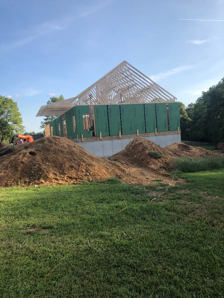

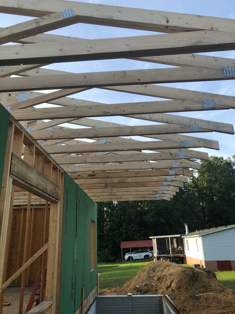

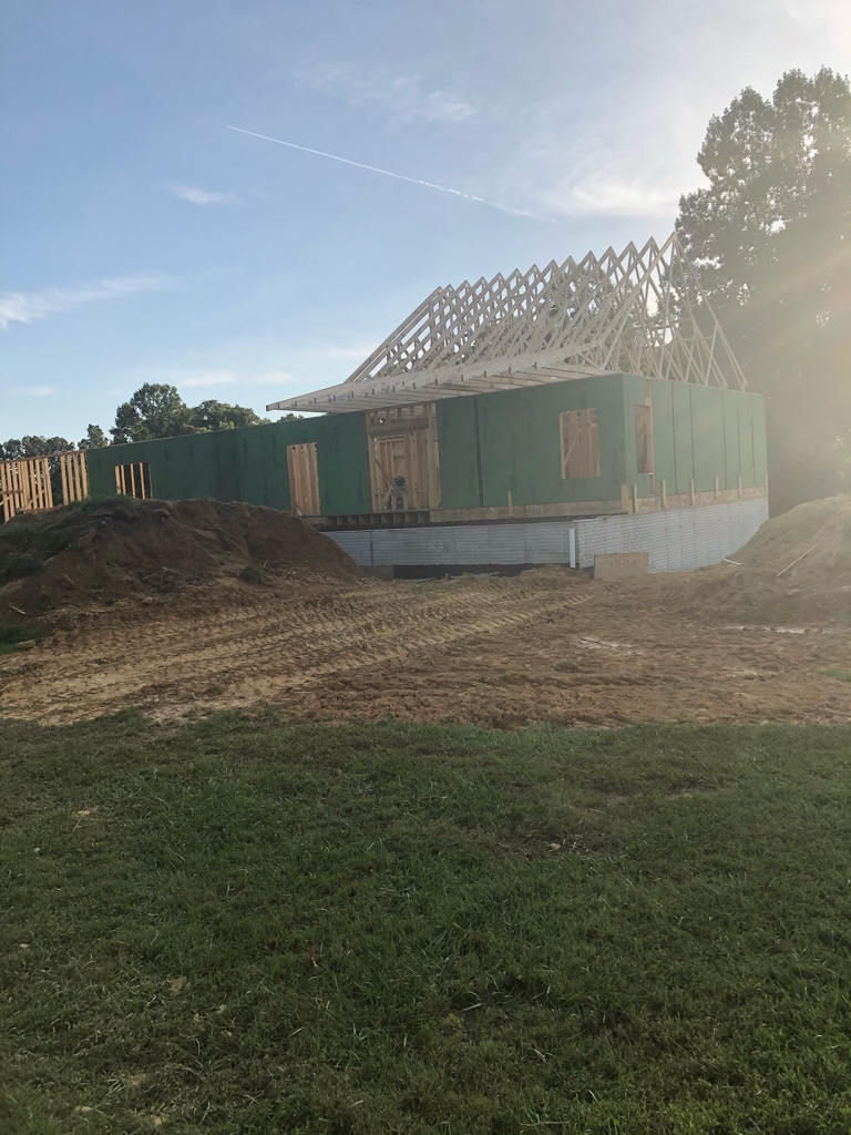

Here is a few shots of where we ended. Still need to do more bracing, but got enough up to make everything solid for the night.
View attachment 668860View attachment 668861View attachment 668860View attachment 668859
Trusses look very similar to mine. Mine were 36' + 8' over the porch. Are you setting some posts for support? Or complete floating them. I have 4 posts over 36 feet of porch width. Thanks for the posts. Looking good. Jon
