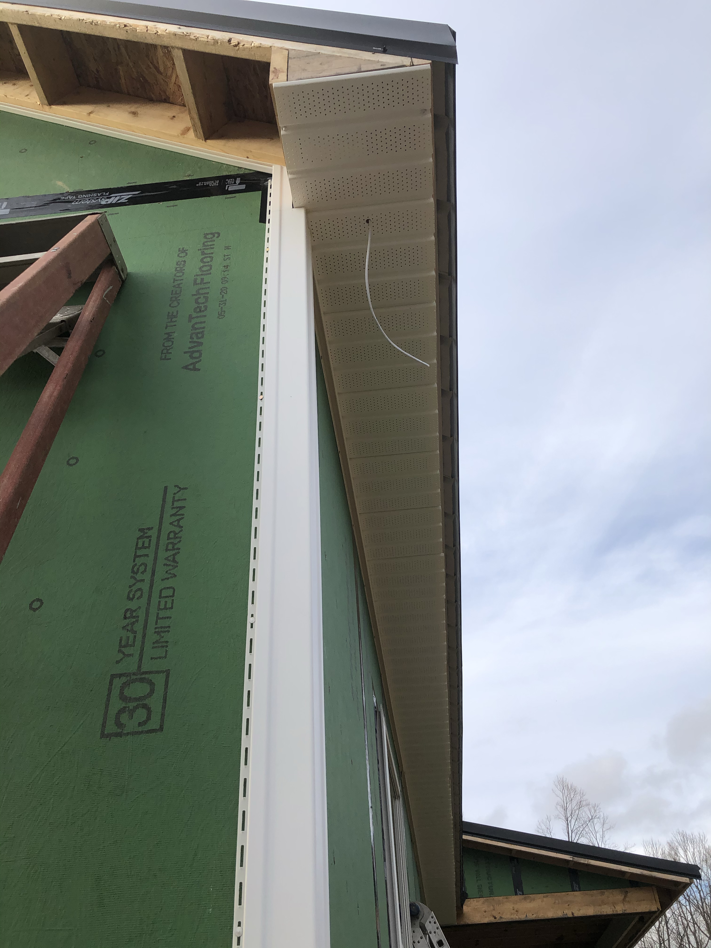

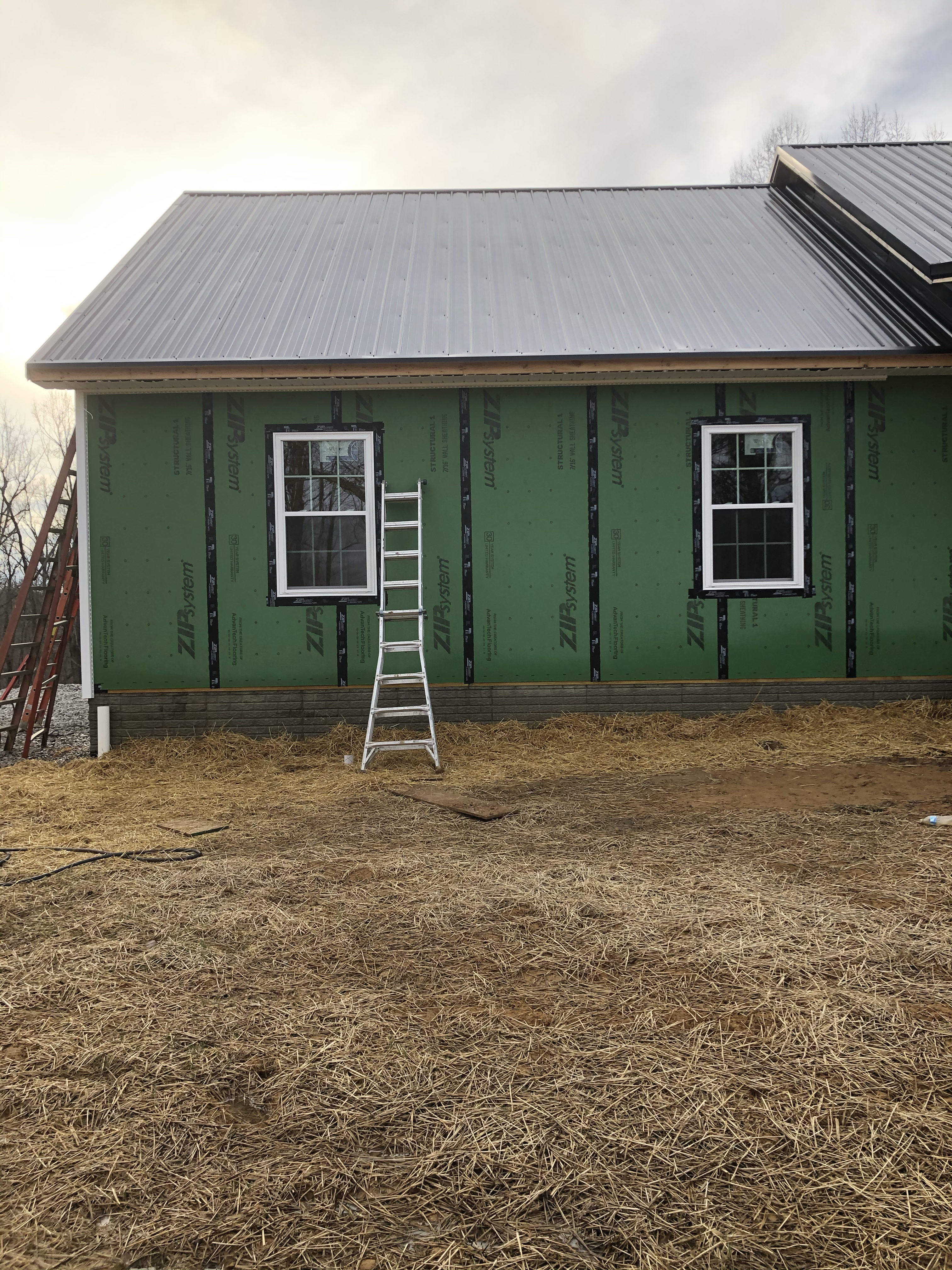

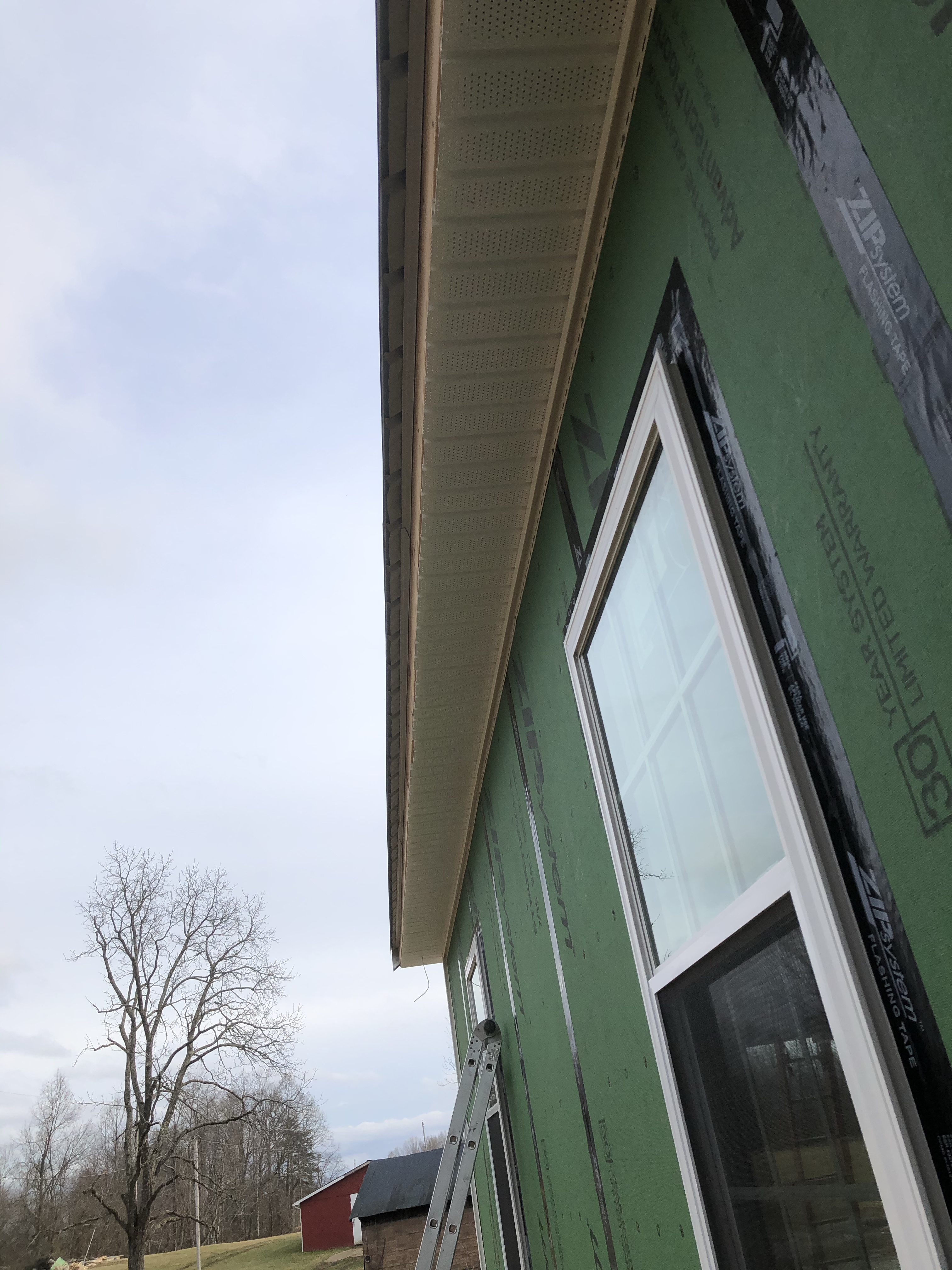

Nice 60 degree day allowed me to work outside. I got one corner up, and all the j channel and soffit on the front of the garage. Also pressure washed the mud off that part of the foundation and put a bunch of straw against the foundation to help keep mud off of it. The white wire is a cat5 for a camera.
Supposed to rain all day tomorrow but I hope to get the starter strip on, j channel across the front porch, and start siding. If rain doesn’t allow that, I’ll work on finishing the garage wiring and insulation.
Forecast looks pretty good after tomorrow so hopefully that will allow me to get a lot of siding on while the drywall is being done.
