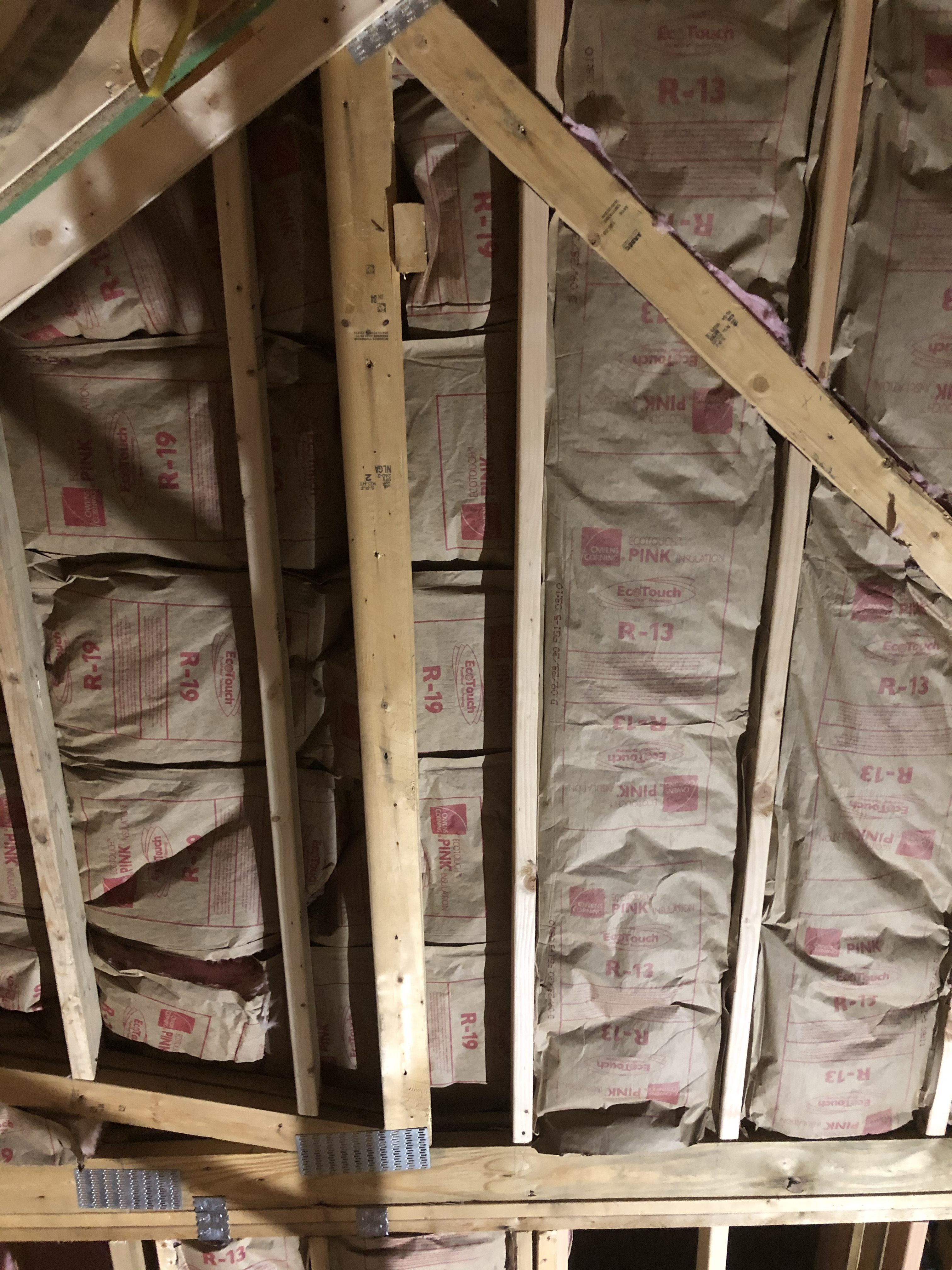

I finished the last of the insulation, other than a few places on interior walls, and got a 30,000btu gas heater set up. With all insulation in place, the house heats up quickly with both heaters going, actually had to turn the bullet heater off when I started sweating this evening.
Drywall will be delivered first thing in the morning, I’ve been told. We’ll see if it happens or not. Still a lot of people without power and some roads closed as they continue to clean up the fallen trees. It seems just as they get it cleaned up, more fall. We actually got another 3” of snow last night.

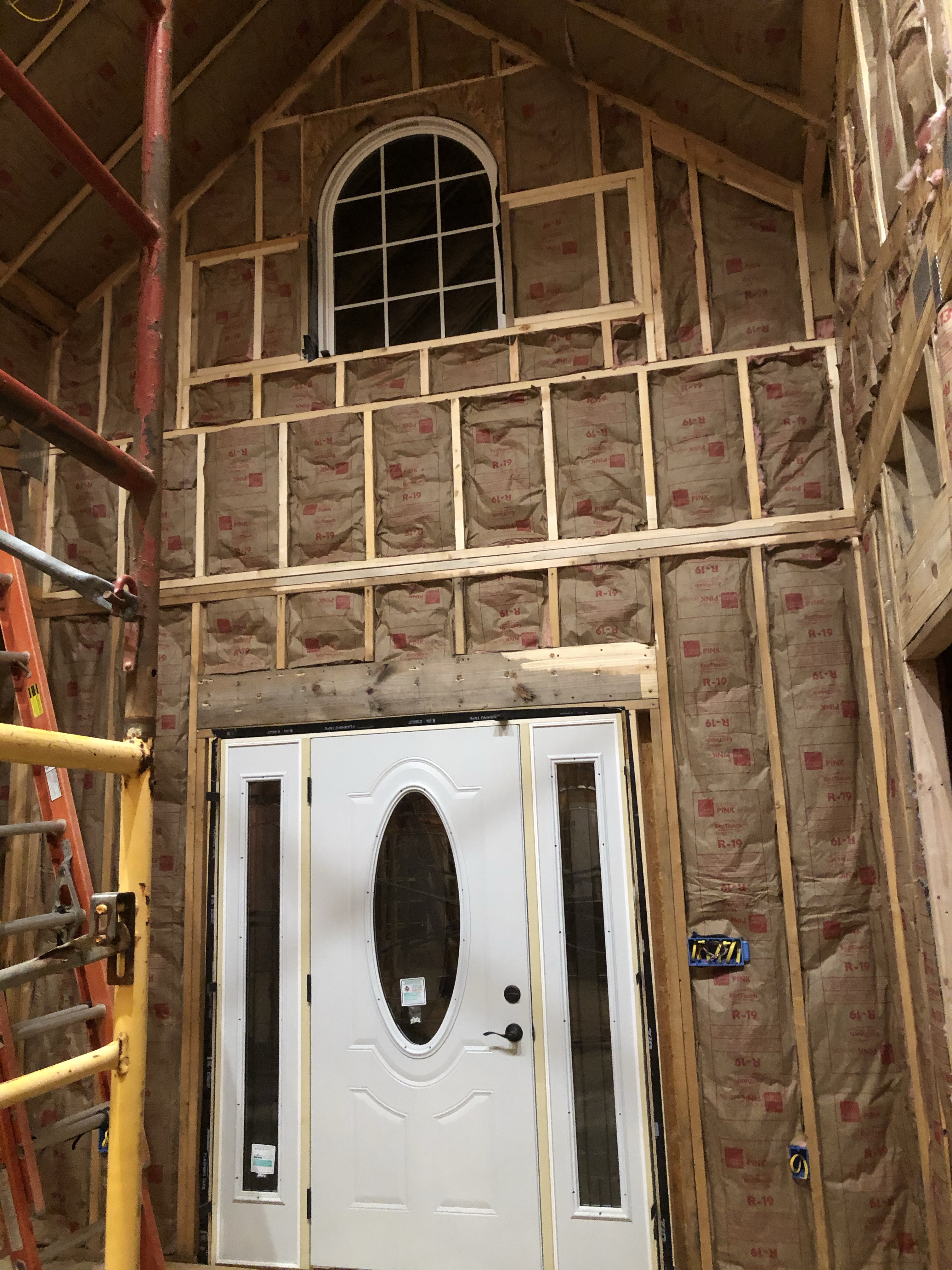

I doubled the insulation up the walls of the foyer, laying R19 horizontally and R13 vertically. IMG_7771.jpg
At some point, I will blow insulation in the ceiling, I put the R30 up to hold heat in for finishing the drywall since it’s cold. I also wasn’t sure how well the blow in would stay in place on the cathedral ceiling. I put two layers of R30 on the cathedral portion. I’m hoping doing all that will lead to a fairly well insulated house. Time will tell.

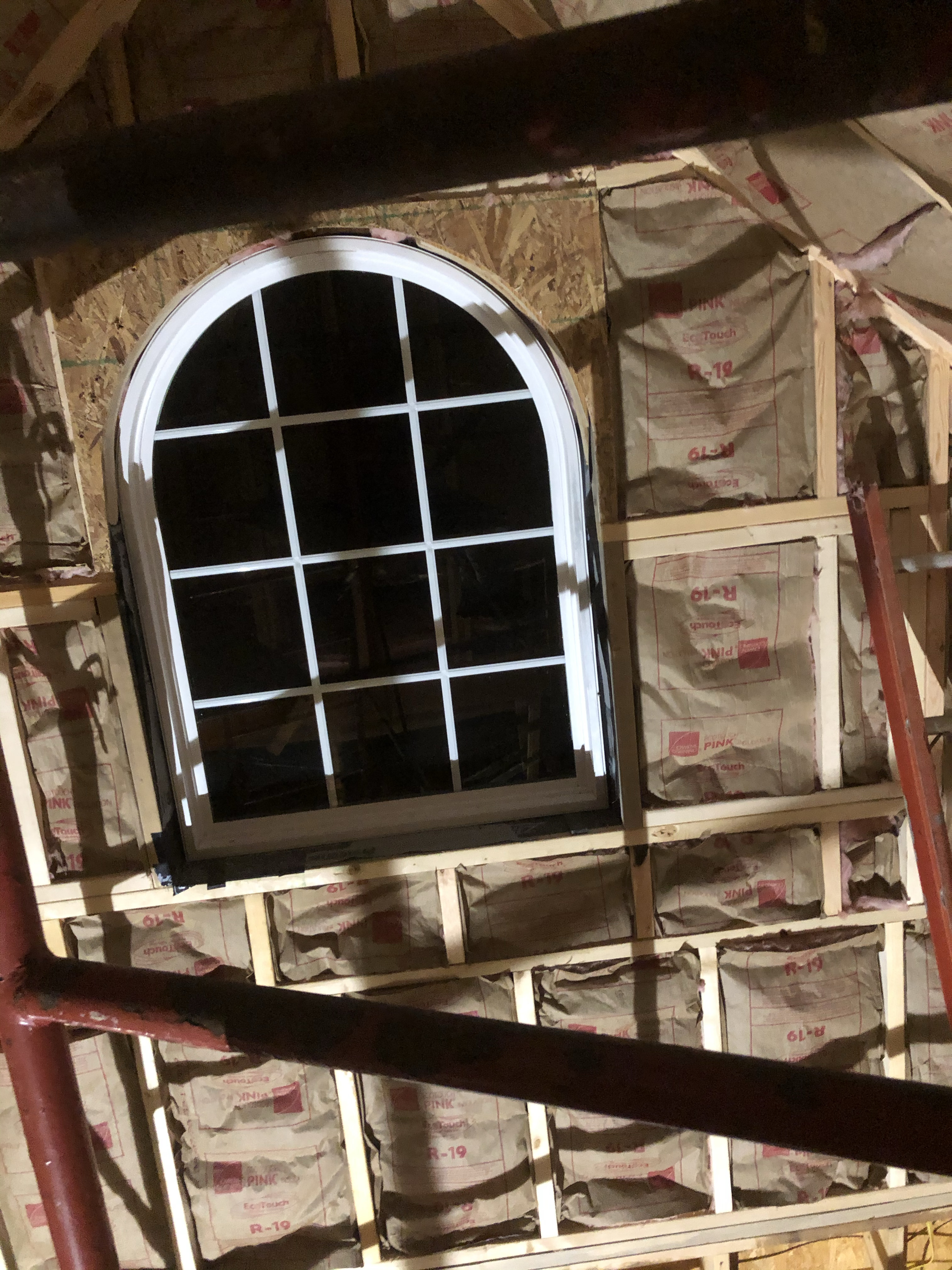

Boy, that wall with the arch window and front door sure has a lot of framing breaking up the insulation. We have a few walls like that in our house and you can feel they are a little bit colder in winter (even with spray foam and cellulose). Walls with dormers are particularly bad. Wood really sucks for R value. I hate to see it but can't do much about it when stick building.
There is a technique where you can frame walls like that at the next size up thickness (so do a 6" wall with 2x4) and either split or stagger the studs to create a thermal break between inside and outside walls. I haven't seen it done in person but have read about it in a couple trade publications.

Part of the reason it’s like that is I had a different window design in mind until I got the price for the window. I changed to a different window and had to frame up part of the opening.
Mostly it’s likely the fact that I didn’t plan that wall very well and built it in three sections. Downside to not doing everyday and having to figure some things out as I go, I guess.

Well, nobody ever thinks about insulation when framing, even pro framers. Maybe a green architect would try to plan it in, but nobody else thinks about it. The focus is usually on making the structure good and meeting local codes for wall shear, wind loads, etc, and then adapting to changes on the fly. There were some weird and expensive framing elements in our house that are only there to meet code, and then some other weird stuff that came about due to changes. All of that results in really poor insulation value in those areas. It is what it is, just hurts to think about it.
I have one corner in our upstairs hall bath where a dormer corner meets a load bearing wall. There is probably 12-16" (wide) of studs in that corner, so no insulation got in there at all. That is a chilly little corner in winter when someone has to sit on the throne... Would've been a good candidate for a small electric heater in the wall if I was thinking ahead.
