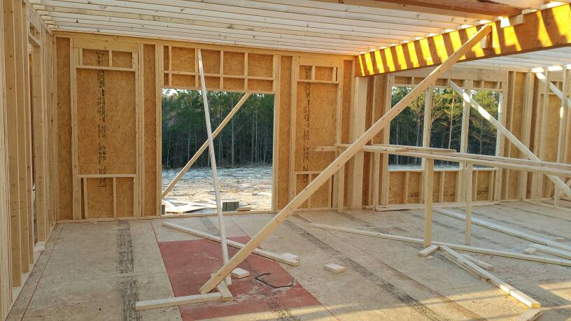

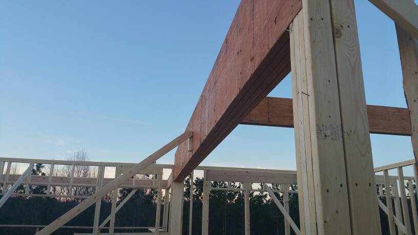

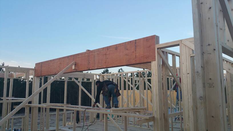

   / New House Build in the Country!!!
#193

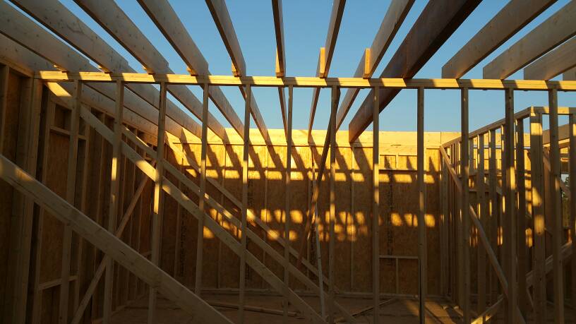

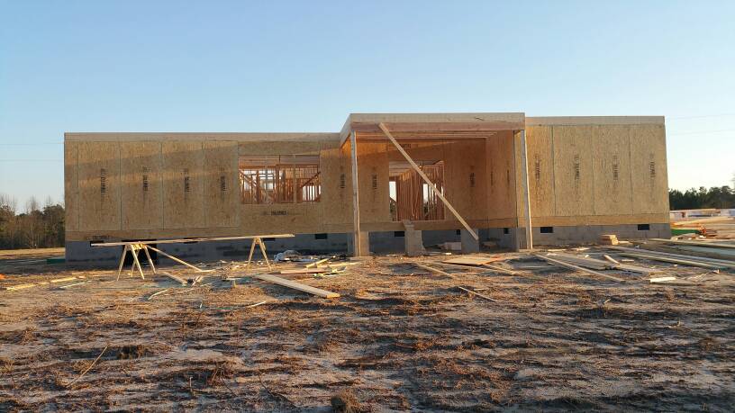

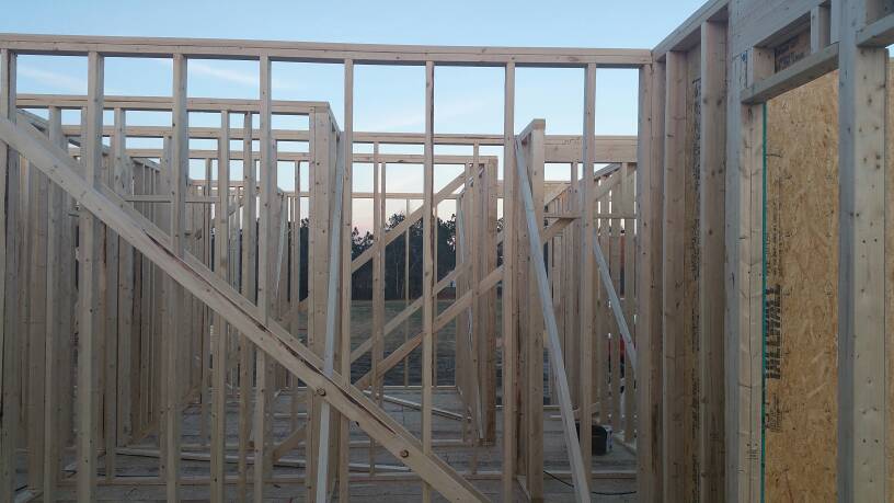

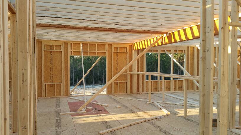

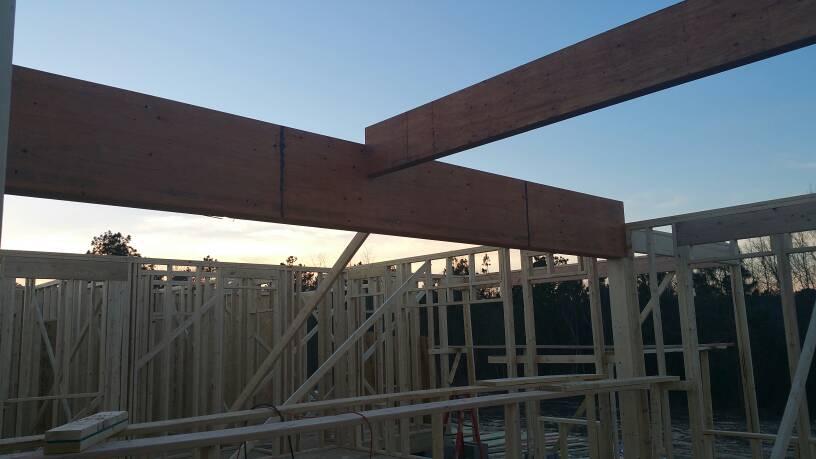

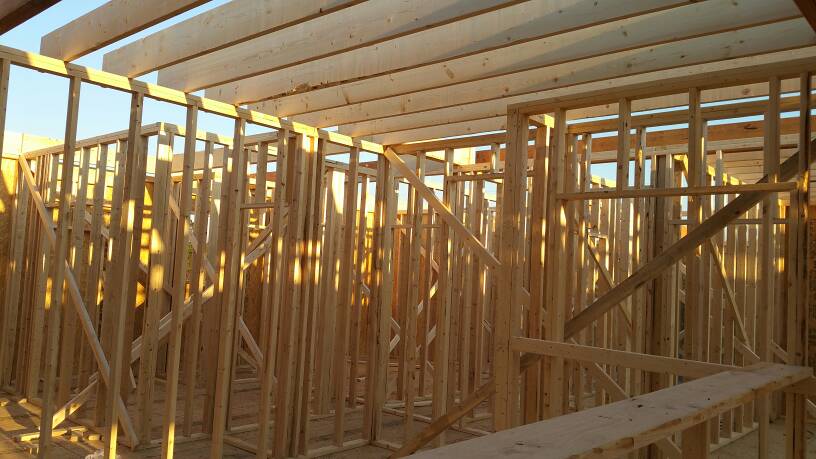

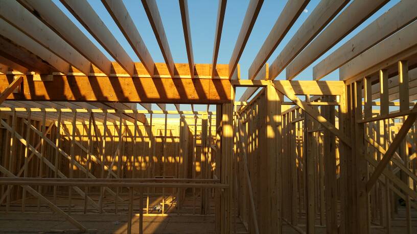

Appreciate all of the feedback. Please keep it coming. I'm going to talk to the builder about blocking. Framers said it wasn't necessary.
Here is today's progress...
uploadfromtaptalk1455837568772.jpguploadfromtaptalk1455837577489.jpguploadfromtaptalk1455837597158.jpguploadfromtaptalk1455837605832.jpguploadfromtaptalk1455837615955.jpguploadfromtaptalk1455837622035.jpguploadfromtaptalk1455837633355.jpguploadfromtaptalk1455837640778.jpguploadfromtaptalk1455837651534.jpg
   / New House Build in the Country!!! #194
Framer says not necessary but it is not his house.
For a few hours of blocking I'd insist on it even if they make it an extra.
I have walked on just a few too many springy floors.
   / New House Build in the Country!!! #195
I would defiantly have a 1x4 strap nailed down the center of each span to hold the joist vertical. All you have to do is walk on it to see if it's springy or not and make your own judgment.

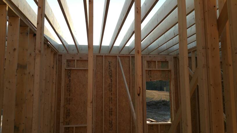

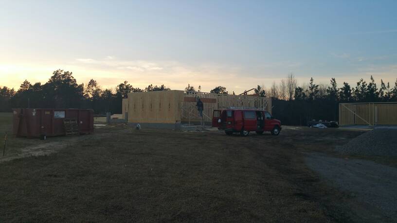

#197

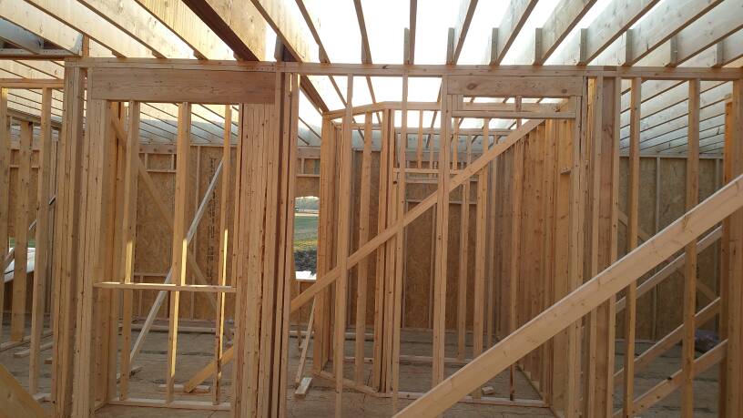

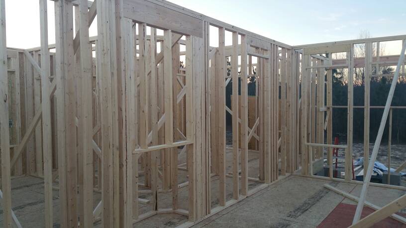

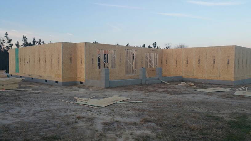

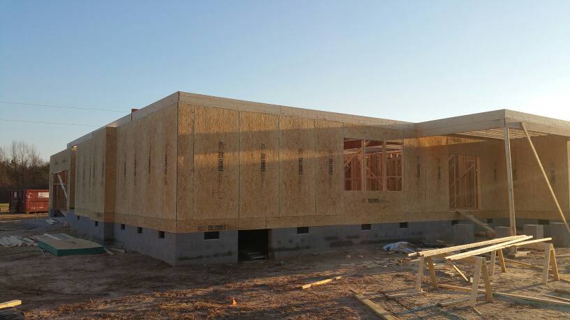

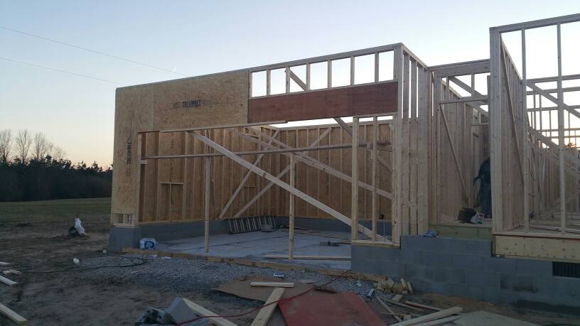

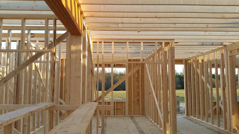

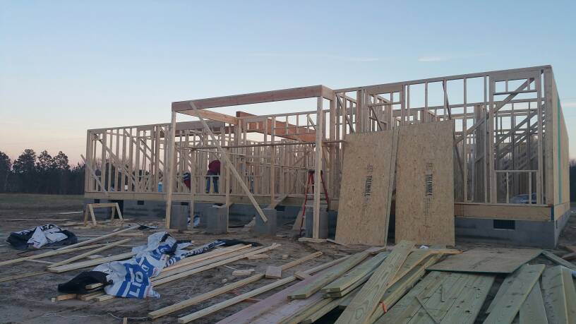

Some updated pictures from today...
uploadfromtaptalk1455923754645.jpguploadfromtaptalk1455923759992.jpguploadfromtaptalk1455923766189.jpguploadfromtaptalk1455923771395.jpguploadfromtaptalk1455923776899.jpguploadfromtaptalk1455923783548.jpguploadfromtaptalk1455923789629.jpguploadfromtaptalk1455923796598.jpguploadfromtaptalk1455923811394.jpguploadfromtaptalk1455923840229.jpguploadfromtaptalk1455923846426.jpguploadfromtaptalk1455923875579.jpguploadfromtaptalk1455923885049.jpg
   / New House Build in the Country!!! #198
Looks great. Some of the pics look like a forest of 2 x 4 s.
This must be exciting for you and your wife.
#199
2x4 forest - I like it!!!
I am definitely getting excited. Im starting to think of all the small details now!!!
