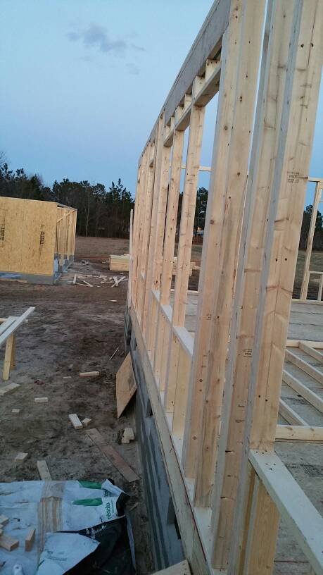

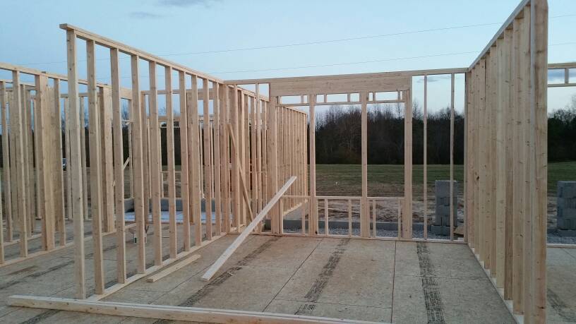

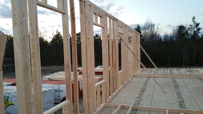

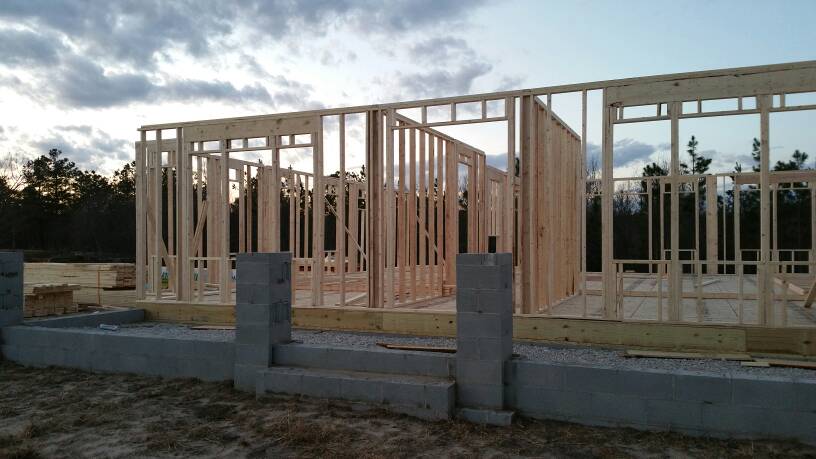

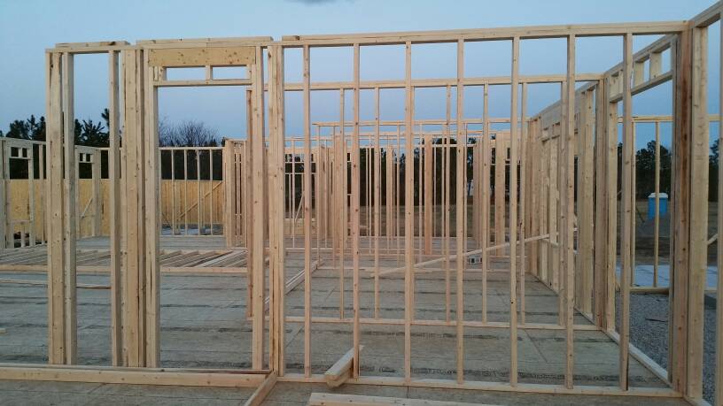

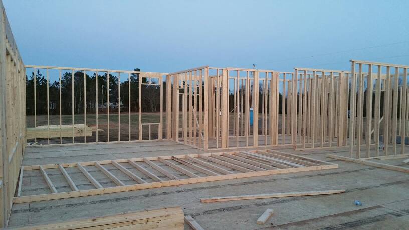

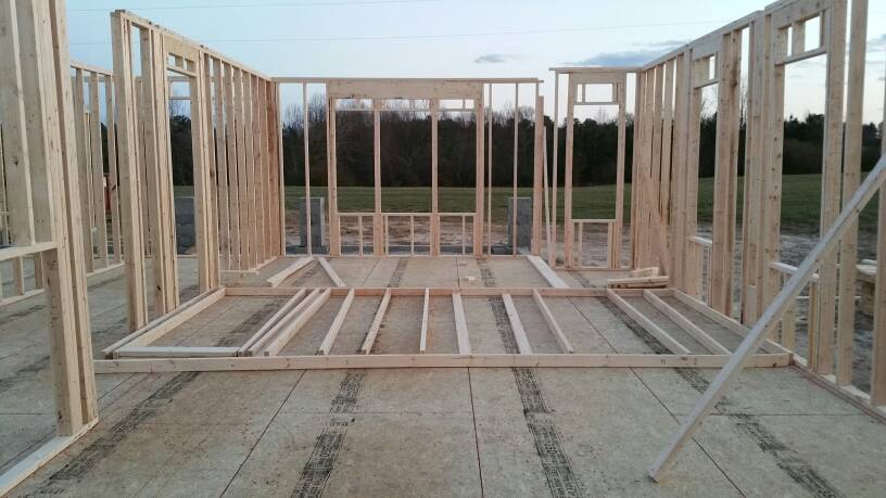

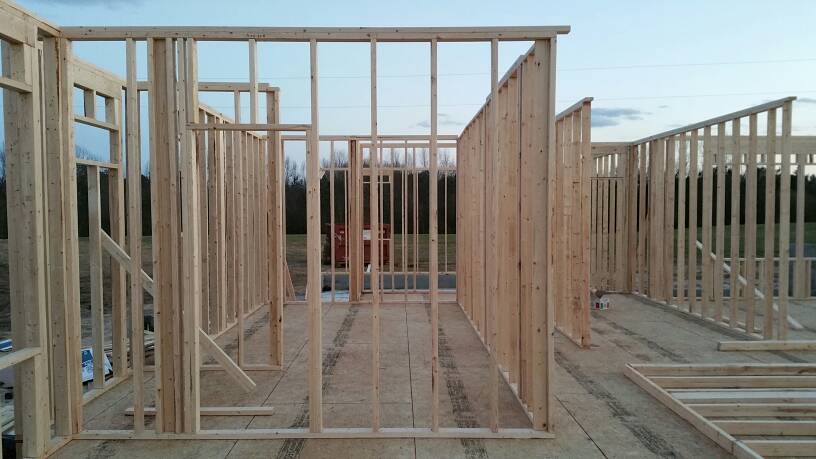

Here are some pictures from today's progress....
uploadfromtaptalk1455751531891.jpguploadfromtaptalk1455751538192.jpguploadfromtaptalk1455751544052.jpguploadfromtaptalk1455751548820.jpguploadfromtaptalk1455751555561.jpguploadfromtaptalk1455751561774.jpguploadfromtaptalk1455751568788.jpguploadfromtaptalk1455751576330.jpguploadfromtaptalk1455751585810.jpguploadfromtaptalk1455751597671.jpg
   / New House Build in the Country!!! #184
Looking good! This is the part that always makes me nervous - will the roof get on before it rains. I know it really won't hurt it, but I hate to see framing get wet.
I'm surprised at the lack of cross bracing also. I'd ask the builder about it. The glued down subfloor will help, but I would have liked to have some blocking.

Well it looks like Eddie's suspicions were correct. They glued and nailed down the subfloor, but I don't see blocking......is this a big concern?
I honestly don't know 100% what will happen without the blocking. What I have seen, is that when a building is first done, it's tight, solid and straight. Then wood does what it's going to do. This can happen in days, but usually it takes years for it to twist and warp on you. I've never built a house that I didn't have to go back and remove at least a couple studs that where straight when I installed them, but twisted on my before I could get the siding on.
The same thing happens to joists. The blocking keeps the joists straight and parallel. It also gives the floor more strength, which means stiffer and quieter. My guess is that the framers never block the floor. It's just not common practice for them. They are doing a nice job on the walls, so I hate to accuse them on intentionally cutting corners.
Sometimes you just have to hire an expert to come in and make the call. This will cost you some money, but I wouldn't be comfortable with just leaving it like that and not knowing. I also wouldn't make final payment on the framing job until I was completely happy with what they have done. Once paid, there is very little incentive to come back and fix things.
What did your General Contractor say about the blocking?
What did your framer say about the blocking?
   / New House Build in the Country!!! #189
The wall framing , headers , doors look good . That is a load transitioned to the floor , joists and piers . Then there is the roof , another chunk of weight . They did a nice foundation but not sure they are using it ? Just observing , not criticizing .
