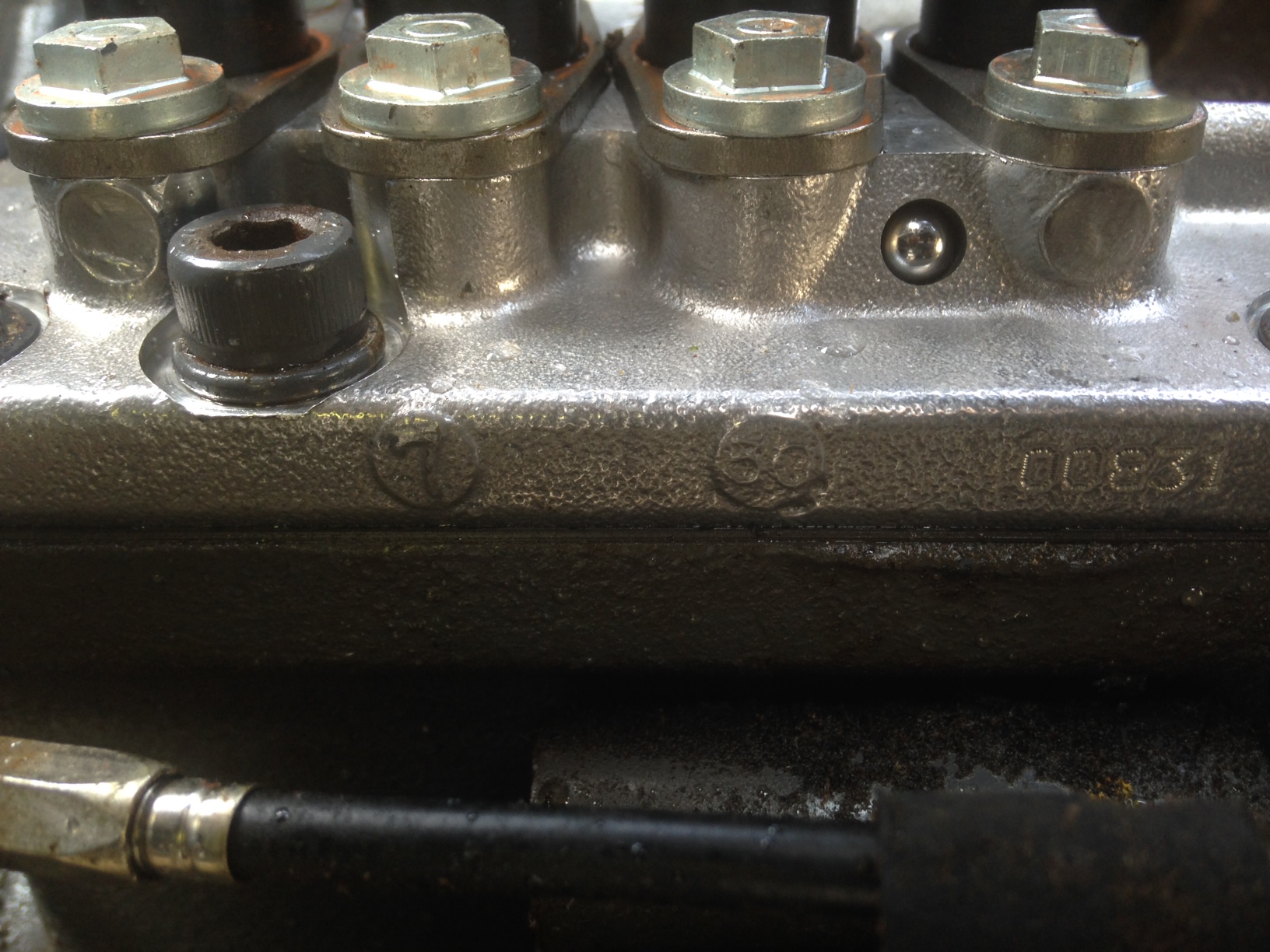

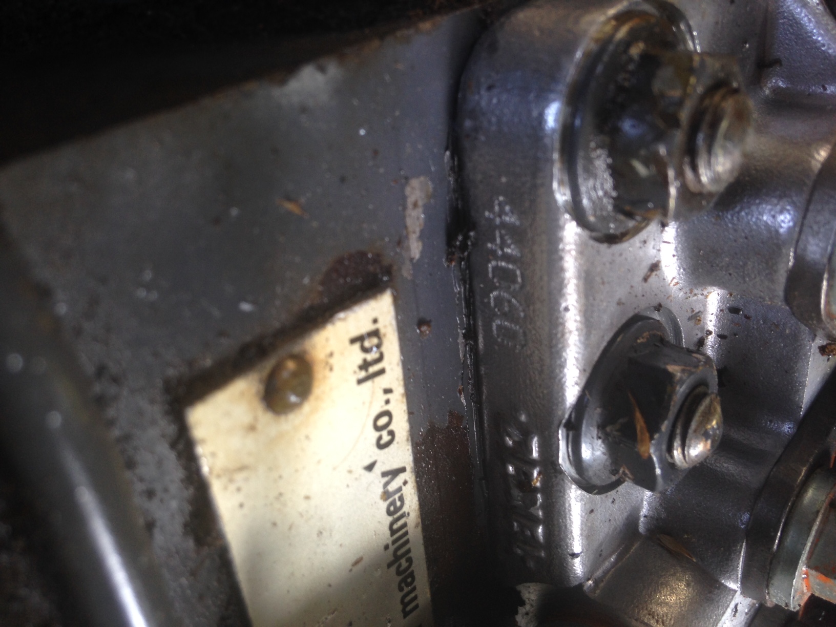

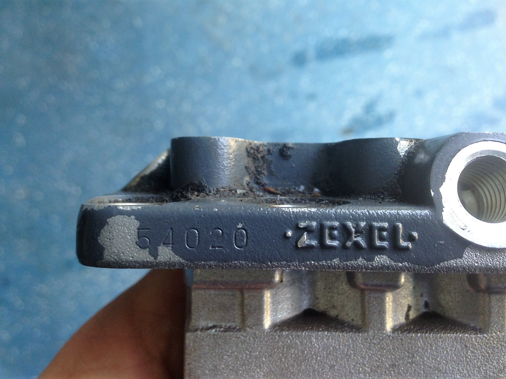

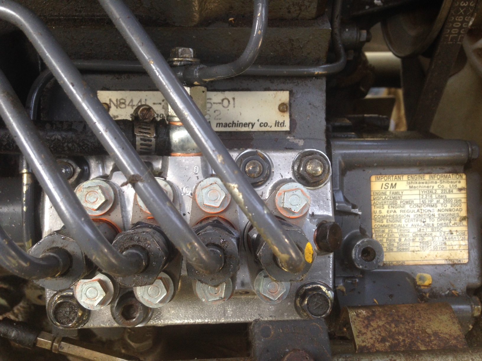

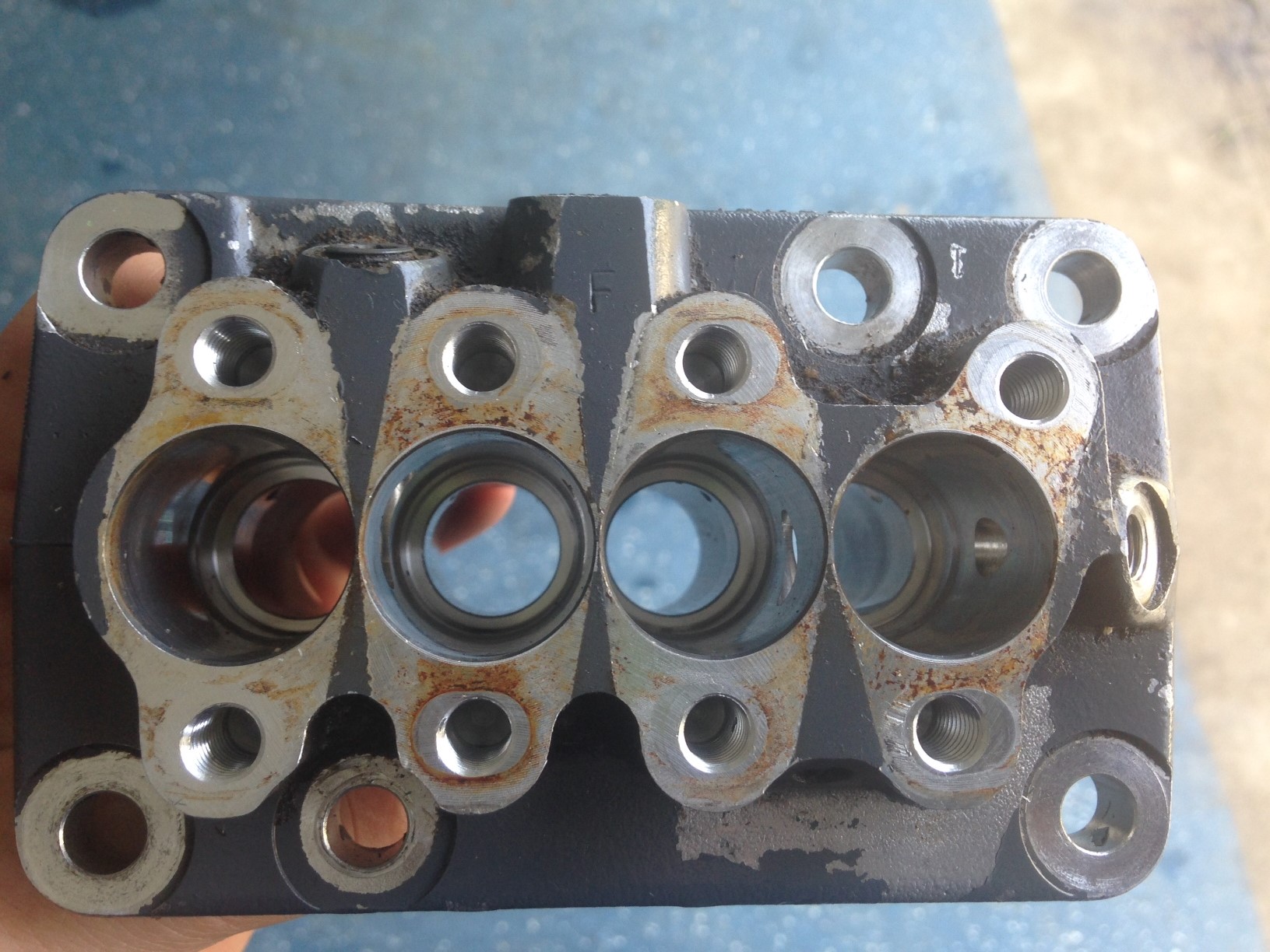

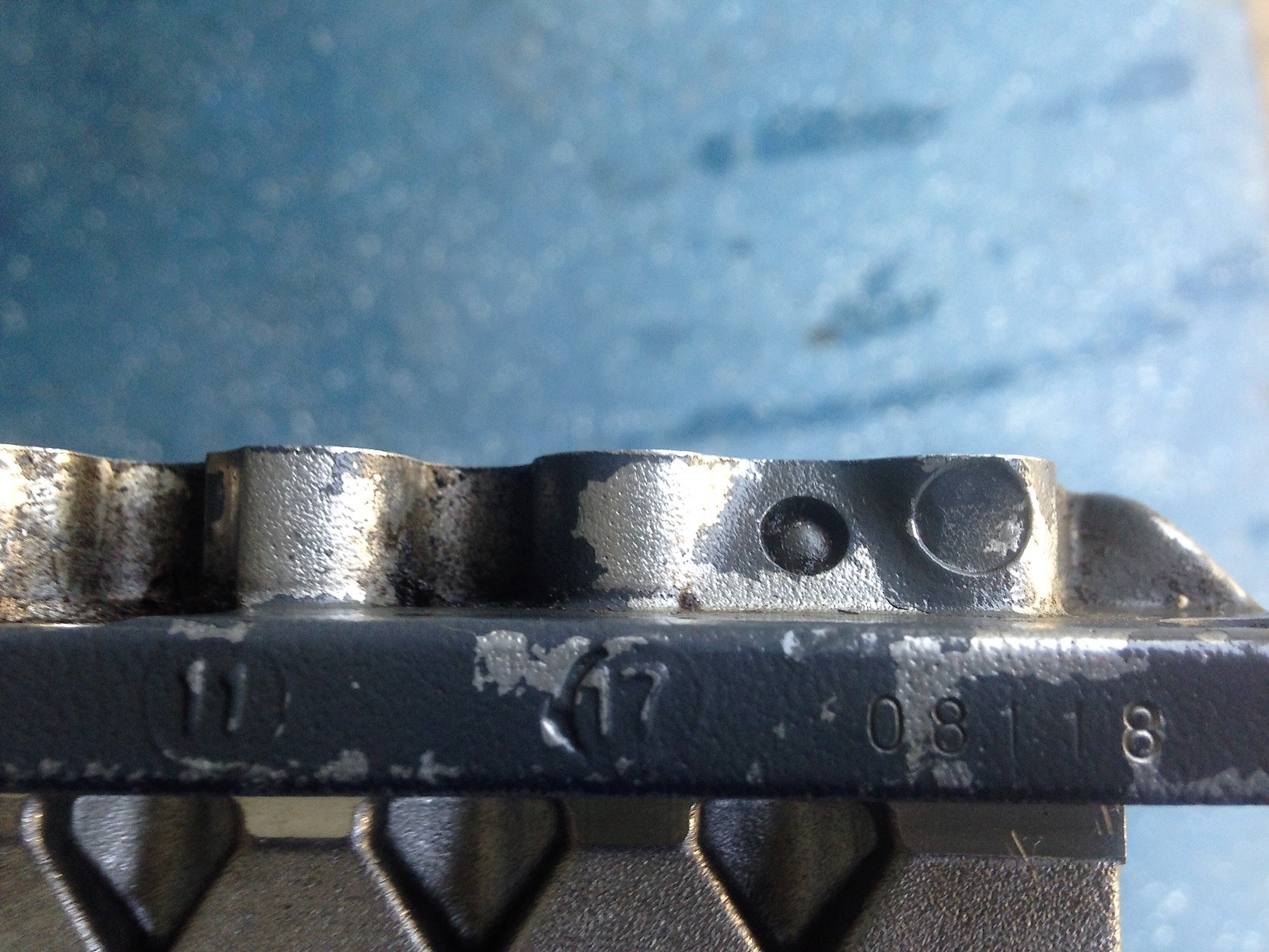

Yes, I still have my old pump, thanks for your help in cross referencing these pumps. I took a few photos this morning, the first 3 photos are of my original pump and the last 3 are the new pump. I took photos of the numbers but I will also spell them out here for you in case you cannot read them in the photos.
Original Pump (disassembled in photos) - 54020 (side with zexel stamped) 08118 (other side)
New Pump (installed in photos) - 44060 (side with zexel stamped) 00831 (other side)
If you all could help me with the spill time procedure I would appreciate that as well.

HOLY SH**.. 1000.00?? I do them all day for 100.00 a cylinder!! BUT that's IF the pump hasn't been taken apart.
Take that pump back where you got it & send the old one to me..
along w/ the injectors.. I'll give you an estimate WAY LESS than 1000.00..!!!
I compared the parts, & the plungers & barrels ARE NOT the same.. The delivery vales & holders are..
