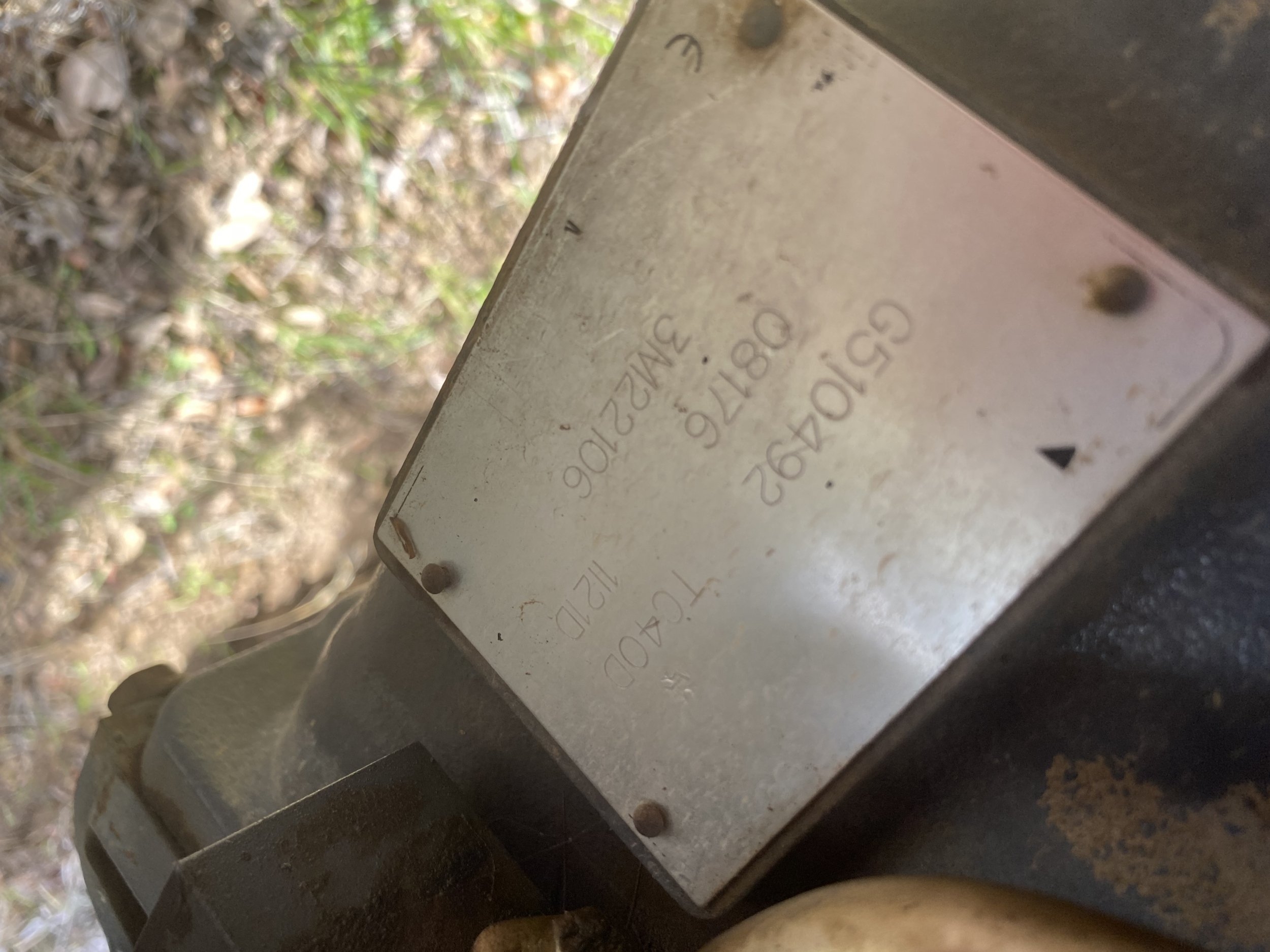

I purchased a TC40D tractor at an estate sale 12 years ago. I’m trying to find out when it was manufactured. I found an aluminum plate ( see enclosed pic) with the following numbers [G510492][08176][3M22106] and [1121D]. Anyone know what they mean? Appreciate it.

The 1I12D is the date code, but Ford never used 'I' in the date code. But, this is a New Holland. Anyway,
1=2001
I= Sept (9th letter=9th month)
12D=12th day
G510492 is the serial number
The other two numbers are the engine and transmission numbers
