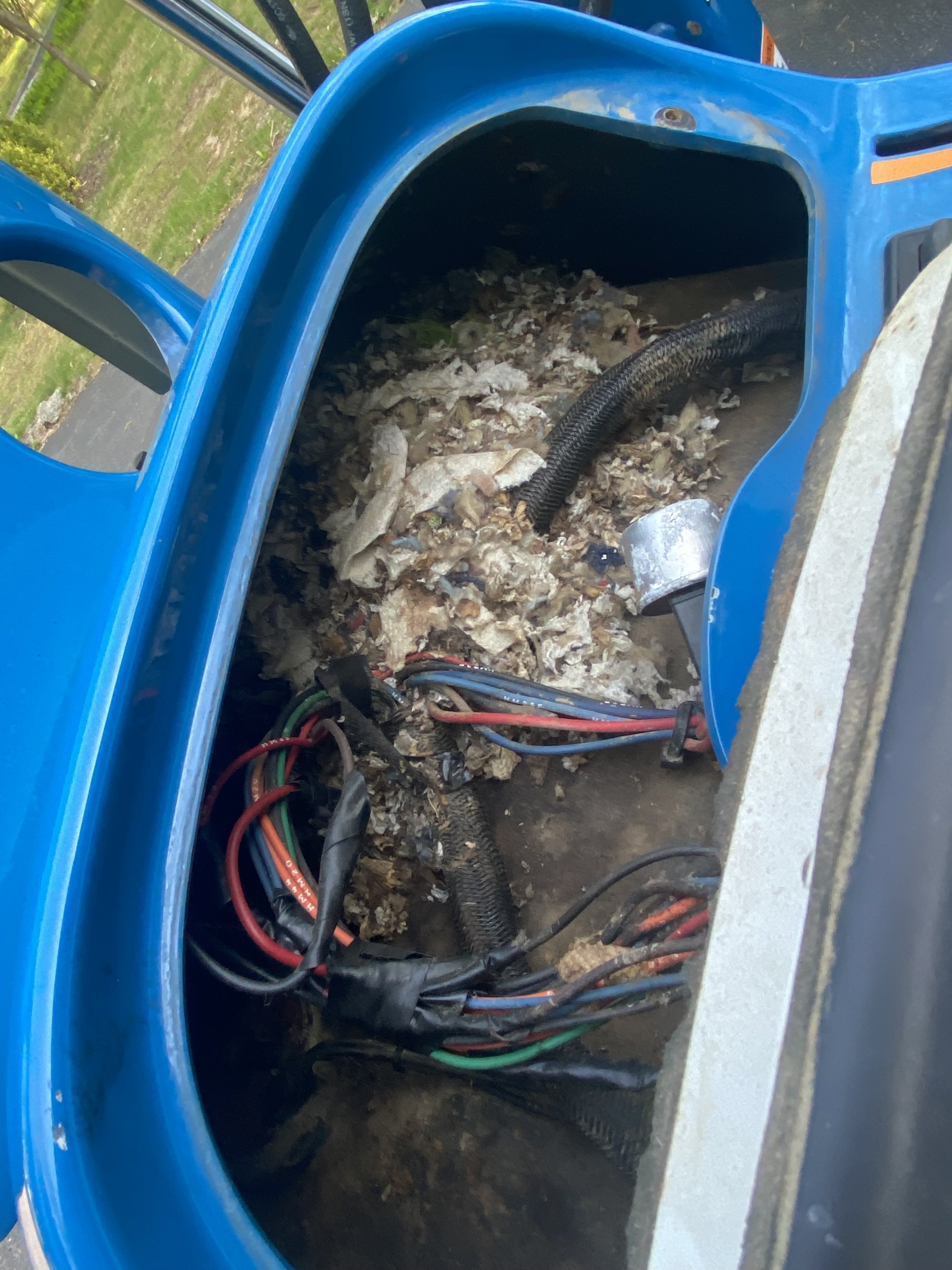

I think I found the problem, Mice
Had a good time behind the dash.
/ New holland Tachometer issue #15
Count yourself lucky it only impacted the tach.
/ New holland Tachometer issue #16
That does look like a/the problem 😏
