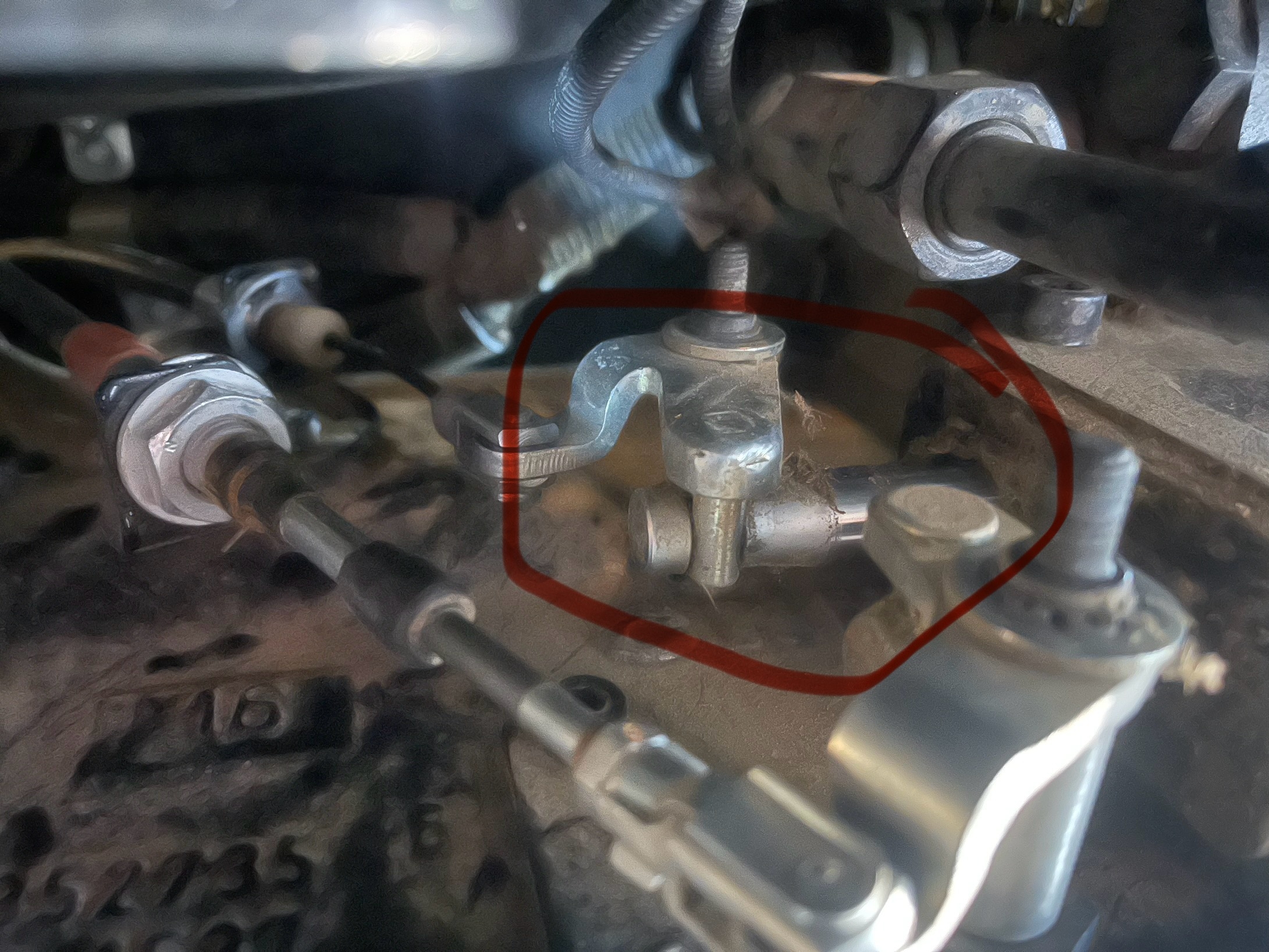

New holland power star t4.75
i have a 2013 powerstar with power shuttle and 8x8 gears. i hooked up planter and main gears ended up getting stuck. i ended up switching gears and started planting. Well after about 5 acres the clutch pedal started to rise up slowly and tractor seemed to slip gears. I stopped and hydraulic fluid was 5 gals low. Had a leak in planter and didn’t realize it. Looking at where the clutch cable attaches ( what I assume is a clutch valve piston) was sticking out on the power shuttle valve. I couldn’t hardly move it in. Removed rear plug and got the valve to move in but pops out. Is that clutch valve hydraulically driven or is there a spring broke? Any ideas. I’ll attach a pic of where the clutch pedal attaches and rod sticking out.

That’s kind of what I thought. It’s a pretty specialized problem. I have wired it back and power shuttle works but does creep forward when putting it into any gears which it never did.

I have a similar vale on both my Kubota M9's with the power shuttle and all I can say is, buy a manual or take it to a dealer. On mine the valve is not rebuildable, replacement only and I'd say you roasted it with low fluid. For my money, it's dealer time. 5 gallons is 33% of my total fluid capacity. In the future you need to watch better for fluid leaks i hoses are hard piping. Wallet time for you...lol

Just as I thought the low fluid caused an air pocket in the power shuttle valve. Took a while to find a bleeder but found it on top right side facing fuel tank. Removed cap and loosed bleed screw and ran it for a couple minutes. Put back together and pedal it back to normal. I did replace the cable and need to do some fine adjustments as it was to creep forward when putting into to gear. Only happen on the very low ranges. Just thought people should know if it happens to them.
