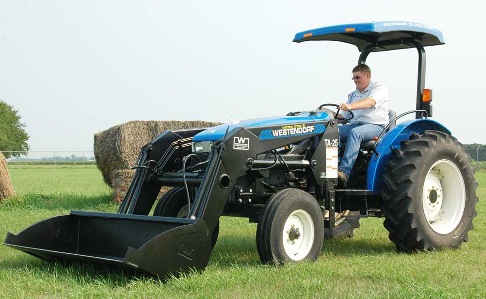

If you are comparing the Woods LU132 to the NH 810TL NSL I'd say the Woods has some key feature advantages.
Woods Max Lift 132" NH 122" Key when loading dump trucks or putting hay in the loft.
Woods Breakout Force at pins = 5000Lb NH = 4200LB This does not tell all but is a good comparison number. The Woods gets the advantage from the curved loader arms.
Lift at front of bucket or pallet forks
Woods Lift capacity @ 32" from pin 2400LB NH = 2400LB
The 5" vs 8" digging depth is a non issue. Loader buckets don't dig they peel. A 2" bite is all you would want to peel at one time or the bucket will fill up too fast. Not sure that machine has the weight to peel more that 4" at a time anyway as peeling tends to break traction on the front tires anyway.

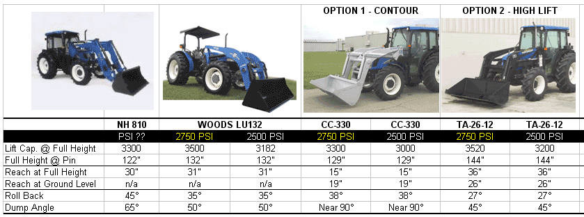

Yes the comparison is as Shaley stated, and on paper each seems to have some advantage. I like the curved geometry of the Woods, which appears to offer better visibility. I went to the dealer yesterday, but he was closed, so I wandered the lot. He had a Woods LU-132, and it looked pretty solid, but unfortunately didn't have a NH loader which to compare. I'm on the fence on this one, as I need to get the price quote down a bit, and the Woods offers a good savings, albeit a possible compromise. The $1500 would go towards a bush hog, which I will be looking for in the spring. These are the decisions you have to make...amongst others.....I'll be speaking to the dealer early this week to get some tighter numbers. Thanks guys.

I agree with you on the digging depth and would also put the breakout in the same category. HOWEVER, the specs don't really match what you are saying.
The first thing I noticed when I looked up the loaders was the psi the loaders were tested at. The Woods Break out vs. HN Breakout is within a couple hundred pounds if you consider different psi's and when you factor in that the NH loader sits closer to the front tires, the Breakouts are very close.
See comparison chart below - it makes big difference.
We can't caution customers enough. Don't rely too heavily on the "specs". If you do, make sure you are comparing apples to apples. The numbers can be skewed so easily as there are so many variables that come into play. Each company tries to make their numbers look better than the next guy's and in the end, it is the customer that suffers. Look at lift capacity at full height and you'll get a good sampling of the power of the loader. The reach at ground level will give you a good idea of how well the loader will fit your tractor (how far out front it will sit) so you can avoid that "pucker" factor everyone has been talking about.

Well I completed my decision. Firstly I went with the Woods LU-132 loader. It was close between it and the NH each had there positives. Of course the Woods being $1400 less was probably the deal meaker for that unit, plus the greater reach, and the quick attach system. The cost savings I used to help upgrade the tractor from the TN-60A to the TN-70A.:D I'm gloating to myself here, cause something about that extra HP (70 vs 57) and torque,(213 ft-lbs vs 159) along with the turbo puts it up big notch in usable power. I wouldn't say it was a "must have" but I feel alot better about the purchase cause I'd have been kicking myself later if I felt underpowered. Added to the options is MFWD. Given the hilly terrain and type of work planned I think this is a necessity. Also transmission wise went to the 16 X 16 hydraulic shuttle shift. Never had one, but it looks like a good fit for the for the loader work, and ground work I'll be doing. I added the underhood exhaust, an extra rear remote (just in case), block heater, R-4 tires, and pallet forks. On the last item I chose 42" length, which will fit a standard pallet. Not sure if I should upgrade to the 48" since I won't be taking delivery till Feb, so if anyone cares to comment. These would be for moving stumps, big logs, tree planting, etc. Maybe the 6" less length would make overall better manueverability in the woods I don't know. Anyway, now I've got to sit tight and wait for delvery. Thanks for your input in helping me decide on this.
